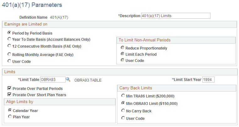

401(a)(17) Parameters Page
Use the 401(a)(17) Parameters page (PA_401A17_PARMS) to set up 401(a)(17) parameters.
Navigation:
Set Up HCM, and then Product Related, and then Pension, and then Calculation Rules, and then 401(a)(17) Parameters, and then 401(a)(17) Parameters
This example illustrates the fields and controls on the 401(a)(17) Parameters page.
The 401(a)(17) limits are published annually by the IRS. Because the limits can change over time, it is important to identify the correct limit for each earnings period.
Earnings are Limited on
Besides identifying the limit for each earnings period, you need to specify a method for applying the limit:

To Limit Non-annual Periods
Because the limits cross multiple consolidation periods, you have to indicate which earnings periods to reduce, and how much.
Field or Control Description
Reduce Proportionately
The system compares total earnings for the allocation period to the appropriate limits to find a reduction ratio. Each segment is reduced using the same factor. For example, an allocation period has two segments that together have earnings of 200,000 USD. The limit is 150,000 USD, so both segments are reduced by a factor of .75.
Limit Each Period
The system determines the percentage of the allocation period that comes from each segment and reduces the limit for that segment by that percentage. For example, an allocation period has two segments: 60 percent of 2008 and 40 percent of 2007. The limit is 160,000 USD. The first segment is limited to 60 percent of the limit (96,000 USD) and the second segment is limited to 40 percent of the limit (64,000 USD). If the first segment has 180,000 USD of earnings and the second segment has 10,000 USD of earnings, then after limits are applied, the first segment has 96,000 USD and the second still has 10,000 USD. Notice that in this scenario, the total for the allocation period, 106,000 USD, is well below the 160,000 USD limit.
See Using a 12 Consecutive Month Basis with Annual Consolidations.
Limits
401(a)(17) limits came into effect in 1989. Calculations with an event date prior to 1989 do not use 401(a)(17) limits. If you align by plan year, event dates in the 1988–1989 plan year are also considered exempt from 401(a)(17) limits. If the event date is 1989 or later, however, you can limit all of an employee's earnings, not just earnings after 1989.
Limit Table
The system looks up the limit for each year using the table lookup utility. The table used associates calendar years with limits.
The system comes with two predefined table lookups for the most common limit tables:
  • The TRA86 table lookup uses the TRA 86 Limits table.
  • The OBRA93 table lookup uses the OBRA 93 Limits table.
You can examine both of these tables under 401(a)(17) Limits. To see the table lookup parameters, go to Table Lookup Alias.
If you look at either of the delivered table lookups, you can see that they are "program generated." This means that 401(a)(17) processing provides the lookup year for each period. If you decide to develop your own limit table, perhaps one that blends TRA and OBRA limits, be sure to make it a program generated lookup.
You can also see that the delivered lookups are set to use the maximum (that is, the latest) value when the lookup year is after the last year in the table. This means that the limit is not projected (projected earnings use the last available limits).

Align Limits by
Regardless of the period being limited (month, calendar year, plan year, or other year), the system determines the limit based on your Align Limits by choice. This setting also determines the limit for the event date, which is used as a final limit for the final average earnings result.
Calendar Year
The system uses the limit for the year that contains the first day of the consolidation period.
Plan Year
The system uses the limit for the first day of the plan year that contains the first day of the consolidation period. For example, a period beginning January 1, 2007 but falling in the 2006–2007 plan year would use the 2006 limit.
