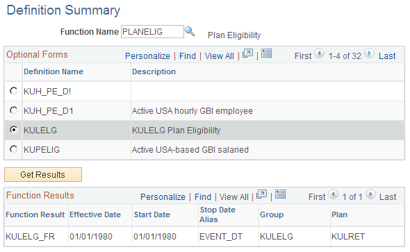

Definition Summary Page
Use the Definition Summary page (PA_DFN_SUMMARY) to view where information for all the definitions is used in the system.
Navigation:
Set Up HCM, and then Product Related, and then Pension, and then Utilities, and then Definition Summary, and then Definition Summary
This example illustrates the fields and controls on the Definition Summary page.
Field or Control Description
Function Name
A definition always belongs to a specific function. To list the definitions for a particular function, first select a function.
Definitions
Definition Name and Get Results
The grid lists all of the definitions for the function you selected. When you find one whose usage you want to review, select the radio button next to the definition name, then click the Get Results button to populate the Function Results grid below.
Function Results
This group box lists the function results that reference the selected definition.
