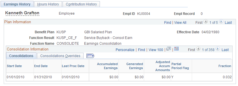

Earnings History Page
Use the Earnings History page (PA_CONS_EARNS_HIST) to view an employee's consolidated earnings.
Depending on your plan rules, the system might use these during calculations for final average earnings, social security, or cash balance accounts.
Navigation:
Pension, and then Pension Information, and then Review Consolidation Results, and then Earnings History
This example illustrates the fields and controls on the Earnings History page.
If an employee provides a social security earnings history, such as a document from the Social Security Administration or pay stubs from previous employers, you must use this earnings history for social security calculations. Rather than entering the new information as an override to the consolidated earnings (which might interfere with other calculations based on these earnings), enter the data on the Yearly Soc Sec Earnings page.
Multiple views of this page are available by clicking the tabs in the scroll area.

Consolidations Tab
Field or Control Description
Accumulated Earnings
Displays the earnings that were actually paid to the employee during a consolidation period. This is not the final earnings for the period, because the rules might require that you generate or otherwise adjust these earnings.
Generated Earnings
Displays the period total after any earnings generation. The generated earnings amount is not added to paid earnings—it replaces the paid earnings. If no earnings were generated, this field displays 0.
Adjusted Accum Amounts (adjusted accumulated amounts)
Displays the final earnings actually used in the calculation. In addition to including the generated earnings, this reflects minimums, maximums, and other adjustments specified in the plan rules.
Fraction
Indicates the portion of the period that the employee worked. For whole periods, this is 1.000, indicating that an employee worked for 100 percent of the period. If the employee worked for 75 percent of the period, the fraction is 0.750.
Depending on your plan rules, the system might use the partial period indicator and partial period fraction during final average earnings and cash balance accounts calculations.
Consolidations Overrides Tab
Override Earnings Amount
Enter the new earnings data. This overrides the data in the Adjusted Accum Amounts field.
Partial Override
Indicate whether this is a partial period. This overrides data in the Partial field. When you deselect this check box, the Partial field value is N. When you select this check box, the value is Y.
Fraction Override
Enter the partial period fraction. Enter 1.000 for periods that are not partial periods. For periods that are partial periods, enter a decimal corresponding to the percentage of the period worked. For example, if an employee worked for 80 percent of the period, enter .8.

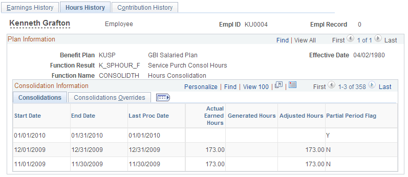

Hours History Page
Use the Hours History page (PA_CONS_HOURS_HIST) to view an employee's consolidated hours.
Navigation:
Pension, and then Pension Information, and then Review Consolidation Results, and then Hours History
This example illustrates the fields and controls on the Hours History page.
Hours History page
Common Page Information
Function Result
Displays the system name for the hours consolidation rule.
Consolidations Tab
Actual Earned Hours
Displays the hours that the employee actually worked during a consolidation period. This is not the final hours for the period, because the rules might require that you generate or otherwise adjust these hours.
Generated Hours
Displays the period total after any hours generation. The generated hours amount is not added to the actual hours—it replaces the actual hours. If no earnings were generated, this field is blank.
Adjusted Hours
Displays the final hours that are actually used in the calculation. In addition to including the generated hours, this reflects minimums, maximums, and other adjustments specified in the plan rules.

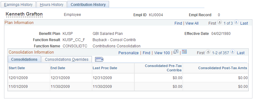

Contribution History Page
Use the Contribution History page (PA_CONS_DED_HIST) to view an employee's consolidated contributions.
Navigation:
Pension, and then Pension Information, and then Review Consolidation Results, and then Contribution History
This example illustrates the fields and controls on the Contribution History page.
Function Result
Displays the system name for the contribution consolidation rule.
Consolidations Tab
Consolidated Pre-Tax Contribs (consolidated pretax contributions) and Consolidated Post-Tax Amts (consolidated posttax amounts)
Display the employee's pretax and posttax contributions during the period.
Override Pre Tax and Override Post Tax
Enter the pretax and posttax amounts.
