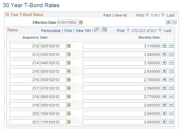

30 Year T-Bond Rates Page
Use the 30 Year T-Bond Rates page (PA_TL_30YR_TBILL) to view 30-year T-bond rates.
Navigation:
  • Set Up HCM, and then Product Related, and then Pension, and then Calculation Tables, and then 30 Year T-Bond Rates, and then 30 Year T-Bond Rates
  • Pension, and then Define Calculation Tables, and then 30 Year T-Bond Rates, and then 30 Year T-Bond Rates
This example illustrates the fields and controls on the 30 Year T-Bond Rates page.
The Internal Revenue Service publishes 30-year treasury bond rates. These are the average yields on 30-year treasury constant maturities for a given month. These rates are used to determine the present lump sum value of a participant's benefit under a qualified defined benefit plan.
Each effective-dated row contains a date and the 30-year Treasury bond monthly rate that was published on that date.
