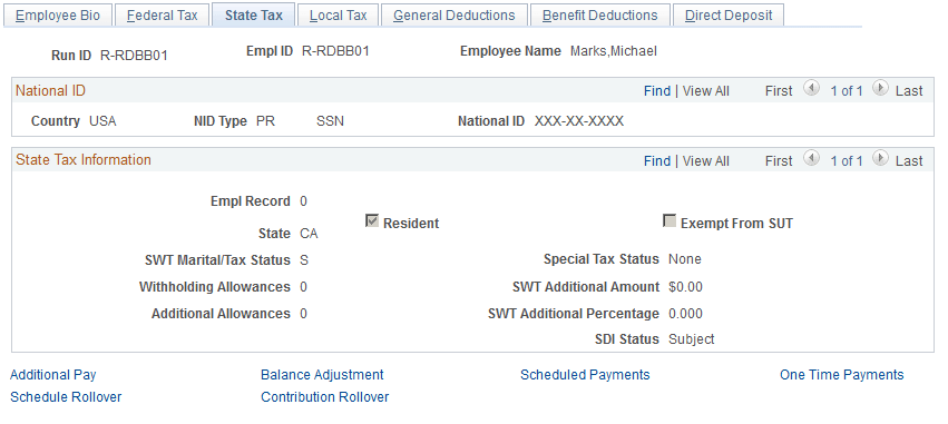

State Tax Page
PA_TE_STX_INFO
View a payee's state tax elections for one retiree record.

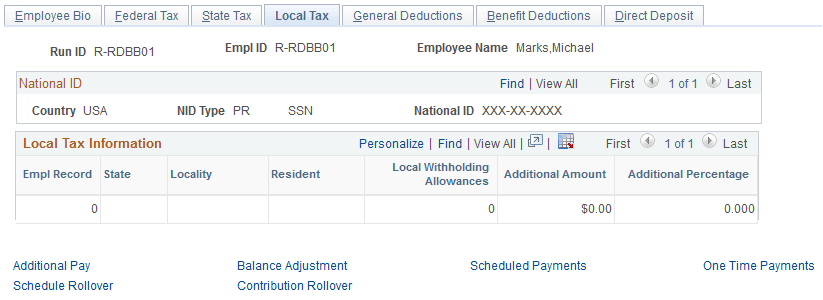

Local Tax Page
PA_TE_LTX_INFO
View a payee's local tax elections for one retiree record.
A payee who is subject to withholding from more than one locality can have multiple local tax records for a single retiree record.

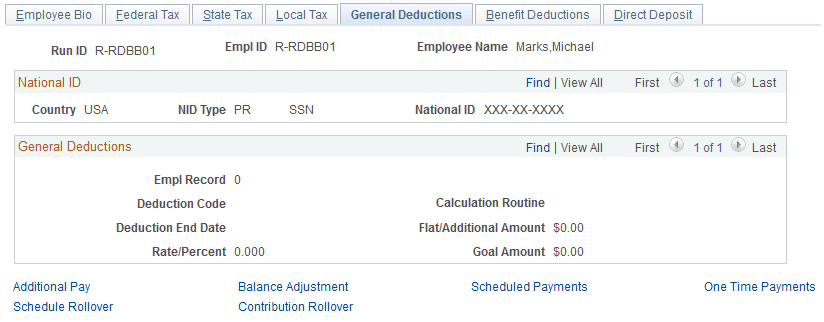

General Deductions Page
PA_TE_GDED_INFO
View a payee's general deductions for one retiree record.
Payees can have multiple deductions per job. General deductions are typically deductions for anything other than benefits, although some organizations use general deductions for benefits, as well.

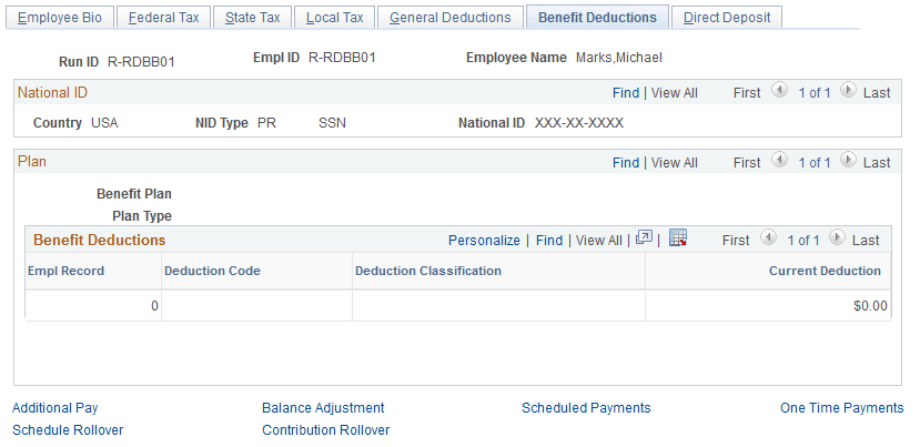

Benefit Deductions Page
PA_TE_BDED_INFO
View a payee's benefit deductions for one retiree record.

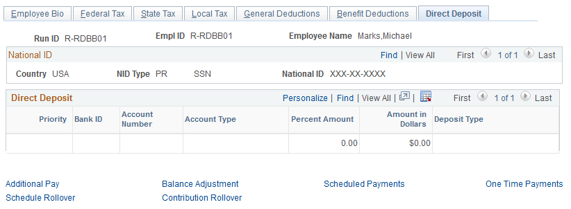

Direct Deposit Page
PA_TE_DDEP_INFO
View a payee's direct deposit instructions for one retiree record.

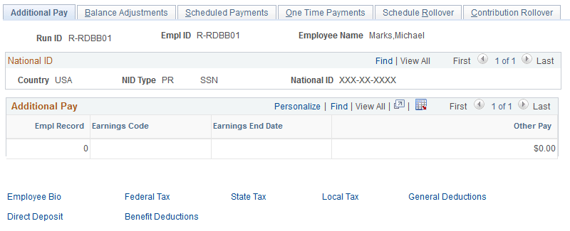

Additional Pay Page
PA_TE_APAY_INFO
View a payee's additional pay for one retiree record.
Payees can have multiple additional pay records per job.

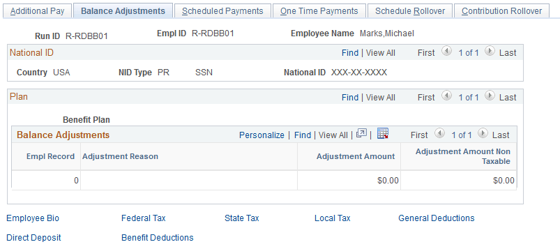

Balance Adjustments Page
PA_TE_BADJ_INFO
View information that can be used to adjust running payment totals for a retiree. The adjustment data is informational only; the system does not apply the adjustments to the running totals. You must make the adjustment manually.
Adjustments apply to one retiree record only. Payees can have multiple balance adjustments per job.

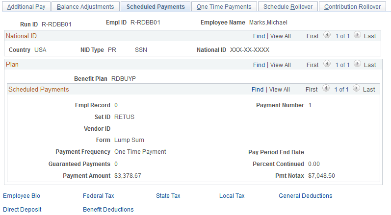

Scheduled Payments Page
PA_TE_SPMT_INFO
View payment amounts and descriptions for recurring payments for one retiree record.
Each retiree record corresponds to a single plan, but payees can have multiple scheduled payment records per retiree record if there are multiple payment streams from a plan.

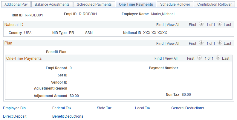

One Time Payments Page
PA_TE_1PMT_INFO
View payment amounts and descriptions for one-time payments for a single payment number under a single retiree record.
One-time payments can be positive or negative.
Negative payments offset any regularly scheduled payment occurring in the same period.

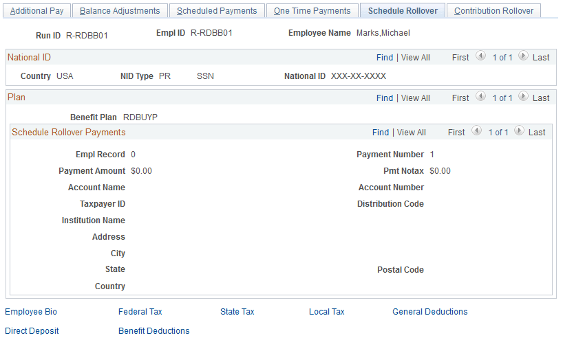

Schedule Rollover Page
PA_TE_SCHED_RLOVR
Displays rollover information for a particular RUN ID with regard to scheduled payments.

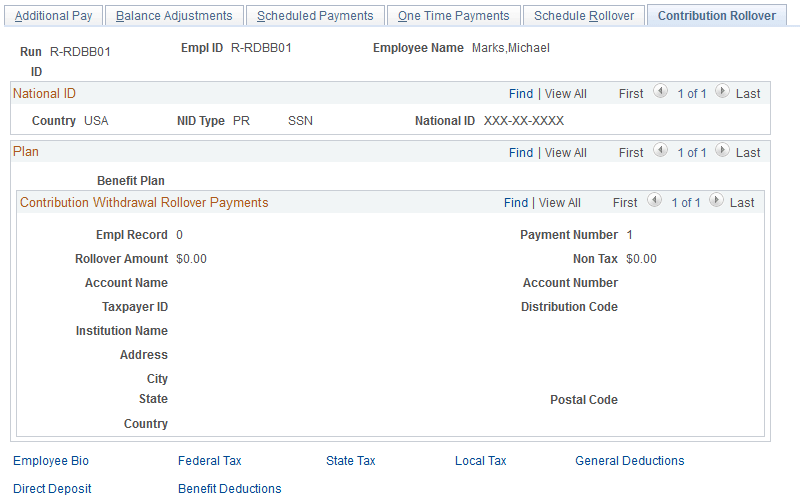

Contribution Rollover Page
PA_TE_CTB_RLOVR
Displays rollover information for a particular RUN ID with regard to contribution withdrawals.

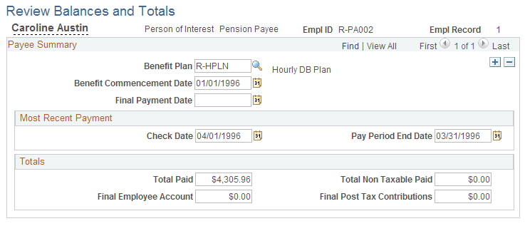

Review Balances and Totals Page
PA_RT_EMP_SUM
  • Track the payment process that automatically updates information under the appropriate payee record number.
  • View the amount of a retiree's contributions that has been repaid.

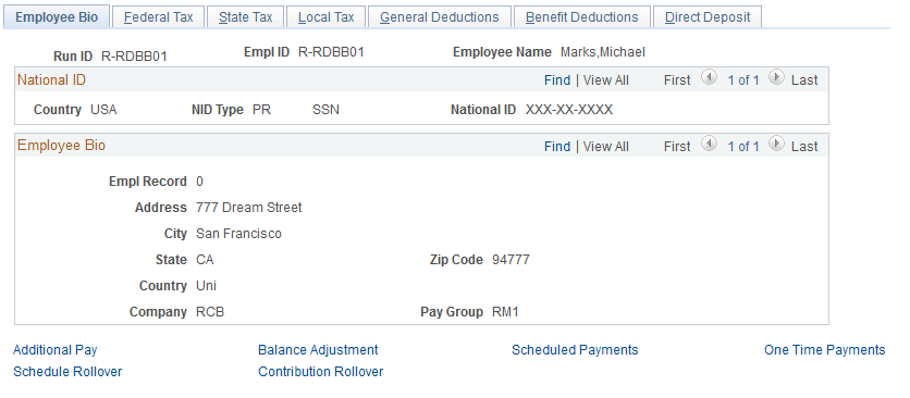

Employee Bio Page
Use the Employee Bio (employee biography) page (PA_TE_BIO_INFO) to view personal information about a payee.
Navigation:
Pension, and then Reports, and then Review Trustee Extract Content, and then Employee Bio
This example illustrates the fields and controls on the Employee Bio page.
Employee Bio page
Bio records have the record type 20.
Bio Record Data Format Length Beginning Position Ending Position

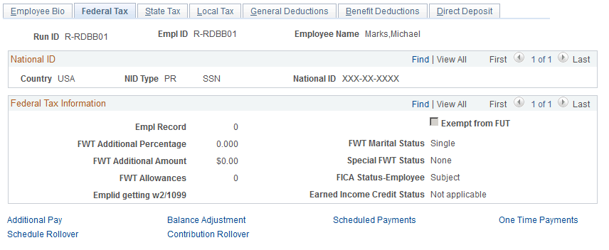

Federal Tax Page
Use the Federal Tax page (PA_TE_FTX_INFO) to view a payee's federal tax elections for one retiree record.
Navigation:
Pension, and then Reports, and then Review Trustee Extract Content, and then Federal Tax
This example illustrates the fields and controls on the Federal Tax page.
Federal Tax page
Federal tax records have the record type 30.
Federal Tax Data Format Length Beginning Position Ending Position

State Tax Page
Use the State Tax page (PA_TE_STX_INFO) to view a payee's state tax elections for one retiree record.
Navigation:
Pension, and then Reports, and then Review Trustee Extract Content, and then State Tax
This example illustrates the fields and controls on the State Tax page.
State Tax page
State tax records have the record type 31.
State Tax Data Format Length Beginning Position Ending Position

Character
1
25
25
Marital Status for State Withholding
Character
1
26
26
Allowances for State Withholding
Number
4
27
30
Additional Allowances for State Withholding
Number
4
31
34
Additional Amount to Withhold
Signed Decimal
5.2
35
41
Additional Percentage to Withhold
Signed Decimal
2.3
42
46
SDI Status
Character
1
47
47
SUT Exempt
Character
1
48
48
Local Tax Page
Use the Local Tax page (PA_TE_LTX_INFO) to view a payee's local tax elections for one retiree record.
Navigation:
Pension, and then Reports, and then Review Trustee Extract Content, and then Local Tax
This example illustrates the fields and controls on the Local Tax page.
Local Tax page
Local tax records have the record type 32.
Local Tax Data Format Length Beginning Position Ending Position
Record Type
Character
2
1
2
Employee ID
Character
11
3
13
Employee Record Number
Number
4
14
17
State
Character
6
18
23
Locality
Character
7
24
30
Resident
Character
1
31
31
Allowances for Local Withholding
Number
4
32
35
Signed Decimal
5.2
36
42
Signed Decimal
2.3
43
47
Use the General Deductions page (PA_TE_GDED_INFO) to view a payee's general deductions for one retiree record.
Navigation:
Pension, and then Reports, and then Review Trustee Extract Content, and then General Deductions
This example illustrates the fields and controls on the General Deductions page.
General deduction records have the record type 40.
General Deduction Data Format Length Beginning Position Ending Position
Record Type
Character
2
1
2
Employee ID
Character
11
3
13
Number
4
14
17
Deduction Code
Character
6
18
23
Deduction End Date
Character
10
24
33
Deduction Calculated
Character
1
34
34
Additional Amount to Deduct
Signed Decimal
8.2
35
44
Percentage Rate for Deduction
Signed Decimal
4.3
45
51
Goal
Signed Decimal
8.2
52
61
Use the Benefit Deductions page (PA_TE_BDED_INFO) to view a payee's benefit deductions for one retiree record.
Navigation:
Pension, and then Reports, and then Review Trustee Extract Content, and then Benefit Deductions
This example illustrates the fields and controls on the Benefit Deductions page.
Benefit deduction records have the record type 41.
Benefit Deduction Data Format Length Beginning Position Ending Position
Record Type
Character
2
1
2
Employee ID
Character
11
3
13
Number
4
14
17
Plan Type
Character
2
18
19
Plan
Character
6
20
25
Deduction Code
Character
6
26
31
Deduction Class
Character
1
32
32
Current Deduction
Signed Decimal
8.2
33
42
Direct Deposit Page
Use the Direct Deposit page (PA_TE_DDEP_INFO) to view a payee's direct deposit instructions for one retiree record.
Navigation:
Pension, and then Reports, and then Review Trustee Extract Content, and then Direct Deposit
This example illustrates the fields and controls on the Direct Deposit page.
Direct Deposit page
Direct deposit records have the record type 50.
Direct Deposit Data Format Length Beginning Position Ending Position
Record Type
Character
2
1
2
Employee ID
Character
11
3
13
Number
4
14
17
Priority
Number
4
18
21
Transit Number
Character
11
22
32
Account Number
Character
17
33
49
Account Type
Character
1
51
55
Percentage Amount
Signed Decimal
3.2
56
65
Deposit Amount
Signed Decimal
8.2
54
63
Deposit Amount
Signed Decimal
8.2
54
63
Deposit Type
Character
1
65
65
Additional Pay Page
Use the Additional Pay page (PA_TE_APAY_INFO) to view a payee's additional pay for one retiree record.
Navigation:
Pension, and then Reports, and then Review Trustee Extract Content, and then Additional Pay
This example illustrates the fields and controls on the Additional Pay page.
Additional Pay page
Additional pay records have the record type 60.
Additional Pay Data Format Length Beginning Position Ending Position
Record Type
Character
2
1
2
Employee ID
Character
11
3
13
Number
4
14
17
Earnings Code
Character
3
18
20
Earnings End Date
Character
10
21
30
Other Pay Amount
Signed Decimal
8.2
31
40
Use the Balance Adjustments page (PA_TE_BADJ_INFO) to view information that can be used to adjust running payment totals for a retiree.
Navigation:
Pension, and then Reports, and then Review Trustee Extract Content, and then Balance Adjustments
This example illustrates the fields and controls on the Balance Adjustments page.
Balance adjustment records have the record type 70.
Balance Adjustment Data Format Length Beginning Position Ending Position
Record Type
Character
2
1
2
Employee ID
Character
11
3
13
Number
4
14
17
Pension Plan
Character
6
18
23
Adjustment Reason
Character
1
24
24
Adjustment Amount
Signed Decimal
9.2
25
35
Nontaxable portion of adjustment amount
Signed Decimal
9.2
36
46
Use the Scheduled Payments page (PA_TE_SPMT_INFO) to view payment amounts and descriptions for recurring payments for one retiree record.
Navigation:
Pension, and then Reports, and then Review Trustee Extract Content, and then Scheduled Payments
This example illustrates the fields and controls on the Scheduled Payments page.
Scheduled payment records have the record type 80.
Scheduled Payment Data Format Length Beginning Position Ending Position
Record Type
Character
2
1
2
Employee ID
Character
11
3
13
Number
4
14
17
Pension Plan
Character
6
18
23
Payment Number
Number
4
24
27
SetID
Character
5
28
32
Vendor ID
Character
10
33
42
Optional Form Code
Character
4
43
46
Optional Form Years Guaranteed
Number
4
47
50
Optional Form Percent Continued
Signed Decimal
3.2
51
55
Payment Frequency
Character
4
56
59
Payment End Date
Character
10
60
69
Payment Amount
Signed Decimal
9.2
70
80
Nontaxable Portion of Payment Amount
Signed Decimal
9.2
81
91
Use the One Time Payments page (PA_TE_1PMT_INFO) to view payment amounts and descriptions for one-time payments for a single payment number under a single retiree record.
Navigation:
Pension, and then Reports, and then Review Trustee Extract Content, and then One Time Payments
This example illustrates the fields and controls on the One Time Payments page.
One-time payment records have the record type 81.
One-Time Payment Data Format Length Beginning Position Ending Position
Record Type
Character
2
1
2
Employee ID
Character
11
3
13
Number
4
14
17
Pension Plan
Character
6
18
23
Payment Number
Number
4
24
27
SetID
Character
5
28
32
Vendor ID
Character
10
33
42
Reason for One Time Payment
Character
1
43
43
Amount of One Time Payment
Signed Decimal
9.2
44
54
Nontaxable Portion of One Time Payment Amount
Signed Decimal
9.2
55
65
Use the Schedule Rollover page (PA_TE_SCHED_RLOVR) to displays rollover information for a particular RUN ID with regard to scheduled payments.
Navigation:
Pension, and then Reports, and then Review Trustee Extract Content, and then Schedule Rollover
This example illustrates the fields and controls on the Schedule Rollover page.
Records that contain rollover information from a Payment Schedule or a Manual Schedule have Record Type 82.
Scheduled Payment Rollover Data Format Length Beginning Position Ending Position
Record Type
Character
2
1
2
Employee ID
Character
11
3
13
Number
4
14
17
Pension Plan
Character
6
18
23
Payment Number
Number
4
24
27
Account Name
Character
50
28
77
Account Number
Character
17
78
94
Taxpayer ID
Character
14
95
408
Distribution Code
Character
2
109
110
Institution Name
Character
40
111
150
Institution Line Address 1
Character
55
151
205
Institution Line Address 2
Character
55
206
260
Institution Line Address 3
Character
55
261
315
Institution City
Character
30
316
345
Institution County
Character
30
346
375
Institution State
Character
6
376
381
Institution Postal Code
Character
12
382
393
Institution Country
Character
30
394
423
Rollover Amount
Signed Decimal
9.2
424
434
Nontaxable Portion of Rollover Amount
Signed Decimal
9.2
435
445
Use the Contribution Rollover page (PA_TE_CTB_RLOVR) to displays rollover information for a particular RUN ID with regard to contribution withdrawals.
Navigation:
Pension, and then Reports, and then Review Trustee Extract Content, and then Contribution Rollover
This example illustrates the fields and controls on the Contribution Rollover page.
Records that contain rollover information from a Contribution Withdrawal have Record Type 83.
Contribution Withdrawal Rollover Data Format Length Beginning Position Ending Position
Record Type
Character
2
1
2
Employee ID
Character
11
3
13
Number
4
14
17
Pension Plan
Character
6
18
23
Payment Number
Number
4
24
27
Account Name
Character
50
28
77
Account Number
Character
17
78
94
Taxpayer ID
Character
14
95
408
Distribution Code
Character
2
109
110
Institution Name
Character
40
111
150
Character
55
151
205
Character
55
206
260
Character
55
261
315
Institution City
Character
30
316
345
Institution County
Character
30
346
375
Institution State
Character
6
376
381
Character
12
382
393
Institution Country
Character
30
394
423
Rollover Amount
Signed Decimal
9.2
424
434
Signed Decimal
9.2
435
445
Use the Review Balances and Totals page (PA_RT_EMP_SUM) to:
Navigation:
Pension, and then Payments, and then Review Balances and Totals, and then Review Balances and Totals
This example illustrates the fields and controls on the Review Balances and Totals page.
The payment summary does not adjust running totals based on scheduled balance-only adjustments. When you schedule a balance-only adjustment, you should manually update the payment summary information.
Field or Control Description
Benefit Plan
The benefit plan is the plan paying the retirement benefits for the specified record number (job number). Remember, a payee has separate jobs for separate plan benefits.
Benefit Commencement Date
The benefit commencement date is the effective date of the first active payment record on a payee's payment schedule. This gets set after the first payment.
Final Payment Date
The final payment date is the date of the last payment. This is set during the payment period after the last payment.
Most Recent Payment
The Most Recent Payment group box provides information about the most recently processed pension payment.
Check Date
The check date of the most recently processed pension payment.
Pay Period End Date
The pay period end date of the most recently processed pension payment.
Totals
The Totals group box contains several running totals for the payments.
Total Paid
The total amount paid is the sum of all payments.
This amount is updated each time a person is paid.
Total Non Taxable Paid
When the total nontaxable amount paid is equal to the final posttax contributions, the system automatically overrides instructions to treat any part of a recurring or one-time payment as nontaxable. You can still, however, make an adjustment to the nontaxable balance with a one-time balance adjustment. If such an adjustment leaves room for additional nontaxable payments, the system once again permits them.
The total nontaxable amount paid is the portion of the total paid amount that was treated as nontaxable.
Final Employee Account
The final employee account amount is the final value of employee contributions (including interest) at the benefit commencement date. This amount includes taxable and nontaxable components. When a payee dies, you can compare this amount to the total paid amount to determine whether the payee recovered the entire value of the account.
Final Post Tax Contributions
The Final Post Tax Contributions field provides the nontaxable component of a final employee account. You can use this to track total nontaxable payments.
When the total nontaxable amount paid is equal to the final posttax contributions amount, the system automatically overrides instructions to treat any part of a recurring or one-time payment as nontaxable. You can still, however, make an adjustment to a nontaxable balance with a one-time balance adjustment. If such an adjustment leaves room for additional nontaxable payments, the system once again permits them.
