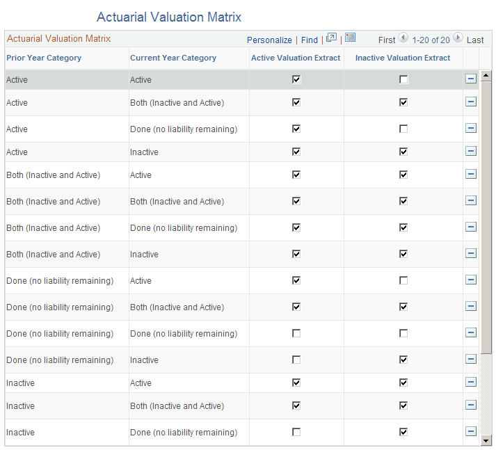

Actuarial Valuation Matrix Page
Use the Actuarial Valuation Matrix page (PA_PEN_VAL_MTX) to specify how to treat combinations of valuation categories.
The Actuarial Valuation Extract uses a combination of the current and prior years' valuation categories to determine how to create the extract files. You use the Actuarial Valuation Matrix page to specify how the system should treat combinations of these valuation categories. The information that you set up on this page applies to all plans.
Navigation:
Set Up HCM, and then Product Related, and then Pension, and then Status Rules, and then Actuarial Valuation Matrix, and then Actuarial Valuation Matrix
This example illustrates the fields and controls on the Actuarial Valuation Matrix page.
Field or Control Description
Active Valuation Extract and Inactive Valuation Extract
For each combination of prior year and current year valuation categories, select:
  • Active Valuation Extract to include participants with this combination of categories in the active extract file.
  • Inactive Valuation Extract to include participants with this combination of categories in the inactive extract file.
The delivered values appear by default, but be sure to conduct your own analysis.
Note: You must scroll to review all of the possible combinations.
