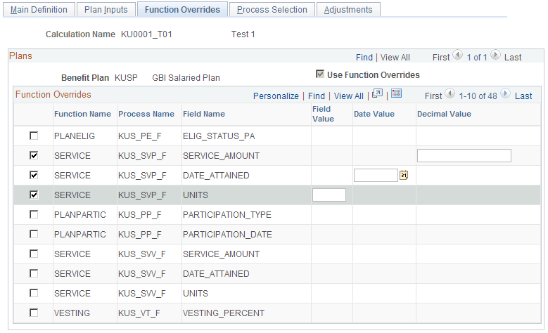

Function Overrides page
PA_CALCULATION_5
Enter override values for calculation components.
The processes listed on this page are brought in when you identify a plan and an as of date on the Main Definition page.

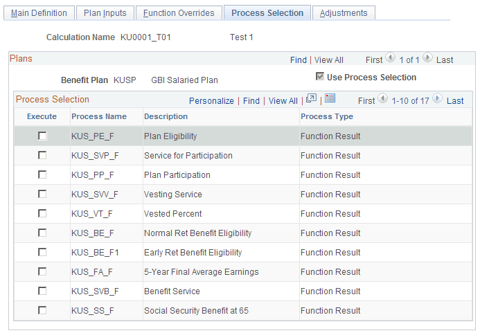

Process Selection Page
PA_CALCULATION_4
Isolate individual calculation components to calculate those results without running through an entire calculation. For example, if you enter an override for the benefit formula result, you can process only the optional forms function, bypassing service, final average earnings, and all other functions that you already ignore by entering the benefit amount override.
You must first enter a plan and as of date on the Main Definition page.

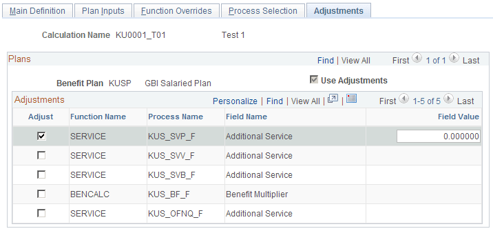

Adjustments Page
PA_CALCULATION_6
  • Adjust amounts for individual components, such as participation service and vested benefit.
  • Arithmetically modify function results.
You must first identify a plan and as of date on the Main Definition page.

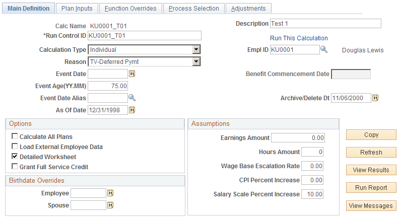

Main Definition Page
Use the Main Definition page (PA_CALCULATION_2) to set up employee information and processing parameters. On this page, you:
  • Enter assumptions for employee hours, earnings, and beneficiaries.
  • Request that detailed values be stored with the results.
  • Run custom code to access employee data from another system.
  • Assume full service credit.
  • Establish when to delete results from the system.
Navigation:
Pension, and then Calculations, and then Define Calculation, and then Main Definition
This example illustrates the fields and controls on the Main Definition page.
Field or Control Description
Calculation Type
You can run a calculation for an individual employee, a predefined list of employees, or a predefined group of employees.
Empl ID, List Name, or Group Name
The field that appears depends on the value you select in the Calculation Type field. When you select:
  • Individual, the Empl ID field appears.
    Enter the ID of the employee for whom you are running a calculation.
  • Pre-defined List, the List Name field appears.
    Enter the name of a predefined calculation group list that contains a static list of employees.
  • Pre-defined Group, the Group Name field appears.
    Enter the name of a predefined calculation group. This group need not be static. It can consist of criteria defined by a custom statement that is used to dynamically identify group members.
Reason
Enter one of the following codes to indicate the reason for the event:
  • Death
  • Disability
  • QDRO Alternate Payee
  • Retirement
  • TV - Deferred Pymt (terminated vested - deferred payment)
  • TV - Immediate Pymt (terminated vested - immediate payment)
  • Web Estimate
Your plan rules might reference this field when death and disability have different calculation rules from the rules used for regular termination and retirement. This field's significance depends on how your company sets up calculation rules.
You can leave this field blank.
Event Date, Event Age (YY.MM), and Event Date Alias
An employee's pension benefit depends on when the employee ends employment. Service stops accruing as of the event date. Benefit eligibility might depend on the event date, and other calculation components might use this date, depending on how you configure your calculation rules.
You can use one of these fields to set the event date:
  • Event Date: The current (system) date appears by default. You can enter other dates to perform historical calculation or estimates for the future.
  • Event Age: To use the event date associated with a specific age, enter the age in the format yy.mm.
  • Event Date Alias: You can use this option to calculate a precise event date. You can define the event date by specifying the hard-coded event date, the event age, or by using other factors, such as the number of years an employee has been with the company.
Note: Enter a value in only one of these fields.
As Of Date
Because your plan rules are effective-dated, you must enter an as of date for the plan rules. If you are reproducing a past estimate, this date ensures that you use the rules that were in effect at the time. Typically, the as of date is the same as the event date.
Note: The system brings the plan rules onto the calculation pages based on a combination of the plan and the as of date. If you're testing changes to your plan rules, you must reenter one of these values, usually the as of date, to pick up the changes. This reloads all of the data on the Function Overrides and Process Selection pages, so you also must reenter data on those pages.
Benefit Commencement Date or Benefit Commencement Dt Alias
  • Individual, the Benefit Commencement Date field appears.
    Enter the date when benefits begin for the employee for whom you are running a calculation.
  • Pre-defined List or Pre-defined Group, the Benefit Commencement Dt Alias field appears.
    Enter the name of an alias that contains the date when benefits begin for the group or list of employees for whom you are running a calculation.
Archive/Delete Dt (archive or delete date)
Enter an expiration date here to have periodic processing delete the calculation and its results as of that date.
If you leave this field blank, the system uses the current date as the expiration date. If you do not want periodic processes to delete the calculation, do not run the Delete Calculations periodic process.
Periodic processing deletes calculation results if both of the following conditions are met:
  • The archive or delete date on the calculation page is in the past.
  • The calculation is not explicitly protected on the Protect Calculations page.
Copy
To run calculations for several retirement scenarios (for example, different event dates or retirement dates for an employee's retirement counseling), you must run multiple calculations. Most of the data in these calculations is the same. Use this button to clone the current calculation parameters in a new calculation. After you clone an existing calculation, you can make minor modifications to set up the alternative retirement scenario.
When you click this button, the system automatically saves changes to the current calculation.
Note: This button is not available in Add mode.
Note: When you click this button, the system does not ask if you want to save changes; it just saves them. When using the Copy button, be careful not to save unwanted changes.
After the system saves the current calculation, it prompts you for a new calculation name and description.
Enter the information and click OK. The system displays the new calculation, but it has not yet been saved. Be sure to explicitly save the new calculation before leaving the page.
Options
Calculate All Plans
If you select this option, the system runs the calculation on all plans associated with the employee, list, or group.
If you select this check box, the system uses the plan normal retirement date (NRD) as the benefit commencement date and the lump sum date. You can override this default for individual plans by manually adding those plans to the scrolling area. If you set a different benefit commencement date without associating that date with a plan, you do not override the default.
If you deselect this check box, the system displays a warning message reminding you that 415 limits apply to all qualified plans and that you should be sure to include all plans for which the employee is eligible.
Note: If each plan has a plan eligibility function that filters out ineligible employees, All Plans really means all the plans for which an employee is eligible. You can also run a calculation for more than one plan at a time by adding a row on the Plan Inputs page.
Load External Employee Data
Pension Administration normally receives employee data from the PeopleSoft HCM tables. Users of a standalone system might not have this data available. If you select this check box, the system runs your own custom process to bring relevant employee data into the calculation linkage, where it is then available to all of the pension functions.
This option does not populate non-pension tables.
Detailed Worksheet
A benefit calculation is based on several components, including service, vesting percentage, earnings, and contributory balances. When you run a calculation, the system captures the values of all the components. This enables you to view basic information used to determine the benefit.
In calculating each component, the system also produces intermediate results. For example, to calculate total service, the system calculates service for each annual period during the participant's employment.
If you select this check box, the system preserves these intermediate results for reporting purposes. The system already has fields to hold the results; selecting this option just captures the data.
Grant Full Service Credit
Contributory plans frequently associate contributions with service. Terminating employees who withdraw their contributions forfeit the corresponding service, and rehired employees who repay their contributions (with interest) can have that service credit restored.
You might run calculations for a rehired employee who is considering buying back service or who is in the process of buying back the service.
If you select this check box, the calculation gives the employee full credit for all of the service that was forfeited because of a withdrawal of contributions.
This option does not affect the employee account balance, which still includes only money that was actually paid into the account.
Birth date Overrides
Employee and Spouse or Number of Years added to Age
The field or fields that appear depend on the value you select in the Calculation Type field. When you select:
  • Individual, the Employee and Spouse fields appear.
    • In the Employee field, you can optionally enter a date to override an employee's birth date.
    • In the Spouse field, you can optionally enter a date to override a spouse's birth date.
      The spouse birth date applies only to beneficiaries who are spouses. Because employees can have different non-spouse beneficiaries for each plan, the beneficiary birth date override is a plan-level override. The beneficiary birth date override field is on the Plan Inputs page.
  • Pre-defined List or Pre-defined Group, the Number of Years added to Age field appears.
    Note: This override applies only to an employee—not to a spouse or other beneficiary. The Beneficiary Birth Date Override field on the Plan Inputs page doesn't change for group calculations; it is therefore inappropriate to enter beneficiary birth date overrides when running group calculations.
Assumptions
To estimate a benefit for a future event date, you must usually estimate future earnings, hours, and contributions. To calculate social security for a future retirement, you must make assumptions about annually published government tables, such as the taxable wage base table.
You can enter assumptions for each plan. If you select the Calculate All Plans check box, you can only enter assumptions for plans that you specifically add to the list of included plans.
Functions and utilities that use this information (social security, projections, and others) automatically have access to your parameters.
Earnings Amount and Hours Amount
When a calculation projects earnings or hours, these values determine the current period amounts, if the rules so specify. The plan rules can specify either that this amount replace the entire period or that it be prorated and used only for the incomplete portion of the current period.
Wage Base Escalation Rate
Indicates the assumed rate of increase in the taxable wage base. This is used for social security calculations and can also affect other calculation components, depending on plan rules.
CPI Percent Increase (consumer price index percentage increase)
Indicates the assumed rate of increase in the CPI-W table. This is used for social security benefit increases.
Salary Scale Percent Increase
Indicates the assumed rate of increase in periodic earnings. This is used when projecting earnings. Enter a rate that is consistent with the type of earnings period (annual, monthly, or other).

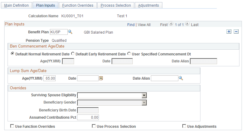

Plan Inputs Page
Use the Plan Inputs page (PA_CALCULATION_3) to enter plan-specific information about ages, dates, and overrides.
Navigation:
Pension, and then Calculations, and then Define Calculation, and then Plan Inputs
This example illustrates the fields and controls on the Plan Inputs page.
Plan Inputs page
Plan Inputs
Benefit Plan and Pension Type
When you enter a plan name, the system displays the pension type: Qualified or Nonqualified.
By inserting a new row in this section, you can calculate multiple plans at once.
Ben Commencement Age/Date
Many aspects of a calculation depend on when benefits begin. You specify that information on this page.
Default Normal Retirement Date, Default Early Retirement Date, or User Specified Commencement Date
Select the plan normal retirement date, early retirement date, or other option, as defined in the plan rules.
Age(YY.MM), Date, and Date Alias
If you selected User Specified Commencement Date for the benefit commencement age or date, enter a benefit commencement age, date, or date alias for calculating benefits from a plan.
Lump Sum Age/Date
If your plan rules reference a lump sum date that is different from the benefit commencement date, use this group box.
For a group calculation, you usually select the Plan NRD or Plan ERD option, because these are determined for each individual employee. If you enter an actual date, this causes different employees in the group to commence benefits at different ages, at which they might not be eligible to receive benefits. For a lump sum, enter an age instead of a date, for the same reason.
Overrides
Certain plans offer an automatic joint and survivor benefit to qualified spouses—that is, a joint and survivor benefit that does not require an actuarial adjustment to an employee's benefit. If you provide this benefit, you establish the eligibility criteria in your plan rules. For example, perhaps the employee and spouse must be married for a full year before being eligible for this benefit.
Surviving Spouse Eligibility
Override the eligibility criteria by selecting the appropriate option:
N - Override to Ineligible.
Y - Override to Eligible.
Beneficiary Birth Date and Beneficiary Gender
If the employee has a non-spouse beneficiary on record, you can override information about the beneficiary in these fields. Since this information depends on data for an individual, do not use these fields for group calculations.
Assumed Contributions Pct (assumed contributions percentage)
To calculate possible future contributions, enter a percentage. When the calculation projects contributions, the system applies this percentage to projected earnings to arrive at future contribution amounts.
Use Function Overrides
Select to enter overrides for a plan. Enter the actual overrides on the Function Overrides page.
Use Process Selection
Select to indicate processes to run on the Process Selection page.
Use Adjustments
Select to enter adjustments for a plan. Enter the actual overrides on the Adjustments page.
See Process Selection Page.
Use the Function Overrides page (PA_CALCULATION_5) to enter override values for calculation components.
Navigation:
Pension, and then Calculations, and then Define Calculation, and then Function Overrides
This example illustrates the fields and controls on the Function Overrides page.
Displays a read-only mirror of the Use Function Overrides check box on the Plan Inputs page.
Process Selection
<Selection Check Box>
Select the check box next to each process whose calculated value you want to override.
Function Name
Displays the pension function that controls the processing.
Process Name and Description
Displays the ID and description for the specific function result.
Field Name
Displays the result fields to override.
Many functions have only a single result field. For example, the final average earnings and vesting functions both produce a single result. Conversely, some functions produce multiple (or compound) results. For example, the service function produces service amount, service units (years or months), and date attained.
Although you do not have to enter overrides for all of the values, enter overrides for values that are necessary for the calculation. For example, there's no need to enter 10 fields of intermediate information for social security results, but enter the PIA_AMT_ADJ, which is the final adjusted social security benefit.
If you enter overrides for the benefit amount (shown on the page as BENCALC), enter overrides for all four of the benefit amount fields:
  • Amount
  • Form code
  • Payment frequency
  • Automatic spousal benefit
The first three fields are required for optional forms conversions. The automatic spousal benefit override default is zero.
Note: If you enter an override for one of a function result's values, that function result produces only the result that you enter. Therefore, there are no detailed results.
Field Value, Date Value, and Decimal Value
When you select a function result field to override, the system displays the appropriate column for entering the override value. Subsequent processes in the job flow use this override value instead of the calculated value.
For example, if you override a final average earnings value, the benefit formula uses the earnings amount that you enter, rather than actual earnings data.
Using Overrides
Pension Administration produces a benefit amount through a series of processes that build upon each other. Normally, each process produces a result according to rules that you set up. Instead, however, you can bypass the calculation process and enter override values for calculation components. Use the Function Overrides page to enter these override values.
As an example of when you might use overrides, suppose a terminated vested employee remarries before beginning to receive payments. Because the new spouse has a different birth date from the previous spouse, the joint and survivor factors must be recalculated. Instead of running a new calculation from the beginning, use the original benefit amount as an override. This way, you can recalculate optional forms factors while ensuring that the normal benefit amount is the same as the amount that you calculated at the time of termination.
Overrides also enable you to set up what-if scenarios by manipulating a portion of the calculation.
Consider the following when working with overrides:
  • Do not enter overrides for the plan eligibility function. This prevents the system from producing the timeline of eligible and ineligible periods that might be needed for other processes. If you know that your plan rules do not reference this timeline, you can skip eligibility processing.
  • Valid participation overrides are Y (yes) and N (no).
  • When you enter a vesting override, use a percentage rather than a factor. For example, if an employee is 60 percent vested, enter 60, not 0.6.
  • The social security function has 10 result fields, all of which appear in the overrides section. Enter just a final social security amount in the PIA_AMT_ADJ field.
  • Enter early and late retirement adjustments as adjustment factors—not adjustment amounts. For example, if an employee's benefit is to be reduced by 20 percent, the factor is 0.8. If an employee's benefit is to be increased by 5 percent, the factor is 1.05.
  • Enter death coverage factors as adjustment factors—not adjustment amounts. For example, if an employee's benefit is to be reduced by 2 percent, the factor is 0.98.
Reviewing Examples of Overrides
Use the following table to understand appropriate values for the override fields:
Use the Process Selection page (PA_CALCULATION_4) to isolate individual calculation components to calculate those results without running through an entire calculation.
For example, if you enter an override for the benefit formula result, you can process only the optional forms function, bypassing service, final average earnings, and all other functions that you already ignore by entering the benefit amount override. You must first enter a plan and as of date on the Main Definition page.
Navigation:
Pension, and then Calculations, and then Define Calculation, and then Process Selection
This example illustrates the fields and controls on the Process Selection page.
The processes listed on this page are brought in when you identify a plan and an as of date on the Define Calculation - Main Definition page.
Displays a read-only mirror of the Use Process Selection check box on the Plan Inputs page.
Process Selection
Execute
If you select the Use Process Selection check box on the Define Calculation - Plan Inputs page, select the Execute check box for each process to run. If you select a process that depends on values obtained from previous processes, either run those processes or enter overrides for them.
Displays the ID and description for the specific process.
Process Type
Indicates how your organization defines the processing rules; disregard this field.
Adjustments Page
Use the Adjustments page (PA_CALCULATION_6) to you must first identify a plan and as of date on the Main Definition page.
Navigation:
Pension, and then Calculations, and then Define Calculation, and then Adjustments
This example illustrates the fields and controls on the Adjustments page.
Adjustments page
Use Adjustments
Displays a read-only mirror of the Use Adjustments check box on the Plan Inputs page.
Adjustments
Adjust
Select this check box for each function that you need to adjust.
Function Name
The name of a pension function—for example, BENCALC for the benefit formula function.
Process Name
The ID your organization has assigned to a process (the function result name).
Field Name
The name of a value that you can adjust.
Field Value
Enter the adjustment amount in the text box.
Reviewing Examples of Adjustments
Use the following table to understand the appropriate values for the adjustment fields:
Function Field Description Example
Service
(SERVICE)
SERVICE_AMOUNT
Adjustment is added to the calculated service amount for the specified function result before the service minimum and maximum are applied.
10.50
Benefit formula
(BENCALC)
BEN_AMT
Multiplier is applied to the dollar amount of the employee's benefit in the plan's normal form of payment for the specified function result.
2
