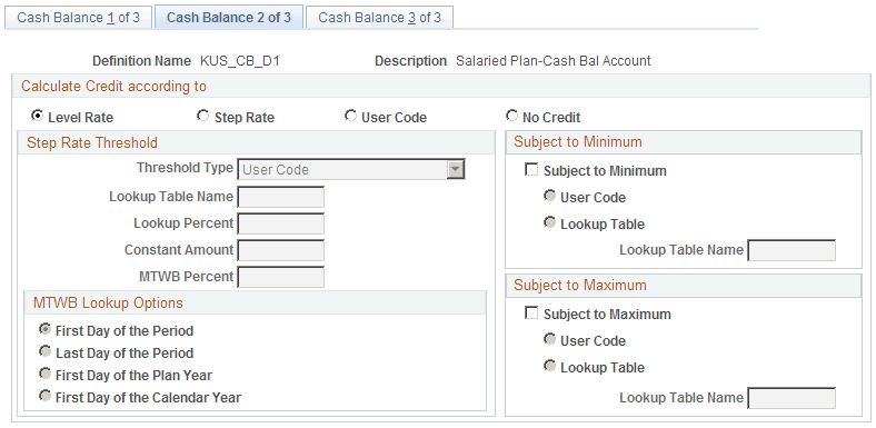

Cash Balance 2 of 3 Page
Use the Cash Balance 2 of 3 page (PA_CSHBAL_ACCT_C2) to specify a method for taking a percentage of earnings.
Navigation:
Set Up HCM, and then Product Related, and then Pension, and then Components, and then Cash Balance Accounts, and then Cash Balance 2 of 3
This example illustrates the fields and controls on the Cash Balance 2 of 3 page.
Calculate Credit according to
To accumulate credits based on earnings, you need to indicate the percentage of the earnings to use. Select one of the following options.
Field or Control Description
Level Rate
Uses the same percentage for all earnings.
Set the rate used on the Cash Balance 3 of  3 page.
Step Rate
Uses one rate below a threshold amount and another rate above the threshold.
Enter additional information in the Step Rate Threshold group box. Also, set the rate used on the Cash Balance 3 of  3 page.
User Code
Uses customized code.
No Credit
Use if there are no continuing credits to your cash balances—that is, the only increases are due to interest.
You typically use this option for periods after the event date or for periods of ineligibility, such as those preceding a rehire or a return from leave. You use the system's grouping capabilities to apply the no credit definition to the appropriate period of time.
Step Rate Threshold
Enter information in this group box if you select Step Rate under Calculate Credit according to.
Threshold Type
Select from these options:
  • Percentage of Table Lookup: You can vary the threshold by selecting this option, entering a fixed percent in the Lookup Percent field, and indicating a table lookup alias in the Lookup Table Name field.
    The cash balance function looks up the rate, based on the criteria you define, to find a single threshold amount that applies to all periods.
  • Percentage of MTWB (percentage of maximum taxable wage base): Select this if your lookup is based on the maximum taxable wage base. Because the maximum taxable wage base changes every year, the system looks up the value for each accumulation period. If you select this option, you must also select a value in the MTWB Lookup Options group box.
  • Constant Amount: If you select this, enter an amount in the Constant Amount field.
  • User Code: Use your own custom user code to set the step rate threshold.
Note: The system does not support table lookups that find different thresholds for different periods unless the threshold is based on the maximum taxable wage base.
MTWB Lookup Options (maximum taxable wage base lookup options)
Select one of the following to indicate the date on which to base the lookup: First Day of the Period, Last Day of the Period, First Day of the Plan Year, or First Day of the Calendar Year.
When you use either the plan year or calendar year option, the system uses the plan year or calendar year that contains the first day of the accumulation period.
Subject to Minimum and Subject to Maximum
Select these check boxes to set minimum and maximum credits per accumulation period. Your cash balance plan may give a fixed number of credits (for example, 500 per year), rather than basing the credits on earnings. In this case, you can use the minimum and maximum earnings limits to force the correct number of credits.
If you do apply a limit, select Table Lookup or User Code to determine how to find the limit.
Note: Remember, you can apply 401(a)(17) limits on the Cash Balance 1 of 3 page. Do not use Subject to Maximum for this purpose.
Lookup Table Name
If you use a lookup table to apply a minimum or maximum, select the lookup table to use.

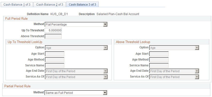

Cash Balance 3 of 3 Page
Use the Cash Balance 3 of 3 page (PA_CSHBAL_ACCT_C3) to specify the rate or rates to use, regardless of whether you use a level rate or different rates above and below a threshold.
Navigation:
Set Up HCM, and then Product Related, and then Pension, and then Components, and then Cash Balance Accounts, and then Cash Balance 3 of 3
This example illustrates the fields and controls on the Cash Balance 3 of 3 page.
Full Period Rule
The Full Period Rules options are the same for a flat rate and a step rate.
Method
Select a method, then enter supporting information in the Up to Threshold and Above Threshold fields.
  • Flat Percentage: Enter a fixed percentage.
  • User Table: Enter the table lookup alias. With this option, you can look up the credit percentage using a regular table lookup. In this case, the percentage is based on criteria you set up using the table lookup utility, and you use a single rate for all periods.
  • Program Generated Lookup: Select this option to vary the percentage according to age, service amount, or both age and service amount. "Program generated" means that the system looks up the rate for each period because the lookup basis (for example, the employee's service) changes each period. This is different from a regular table lookup, where the lookup is the same for all periods.
  • Custom Statement: Enter the custom statement or statements that provide the percentage.
Up To Threshold and Above Threshold
If you use a level rate, complete the Up to Threshold field.
If you use a step rate, complete both the Up to Threshold and Above Threshold fields.
Enter information that supports your selected method. For example, if the method is Flat Percentage, enter a percentage.
Up To Threshold LookUp and Above Threshold LookUp
There are two identical sets of parameters for configuring the age and service lookup bases. Up To Threshold LookUpapplies to level rates and step rates below the threshold. Above Threshold LookUpapplies to step rates above the threshold.
Option
Select one of the following to indicate what the program-generated lookup is based on:
  • Age: Age only.
  • Service: Service only.
  • Age Plus Service: Age and service added together to yield a single lookup value.
  • Age And Service: A two-way lookup.
Age Start
If your lookup includes an age component, enter an alias for the date of birth (or any other starting date).
Age Method
Enter a duration option specifying the age calculation method.
Service Name
If your lookup includes a service component, enter a service function result.
Age End Date
For the age components, select either First Day of the Period or the Last Day of the Period.
Service As of
For the service component, select either First Day of the Period or the Last Day of the Period.
Partial Period Rules
Partial period rules can occur when employees move in and out of plan eligibility or when they switch to another cash balance definition mid-period—for example, there is one definition before the event date and another with interest only after the event date. Select from Same As Full Period, No Credit, or User Code (your own custom code).
