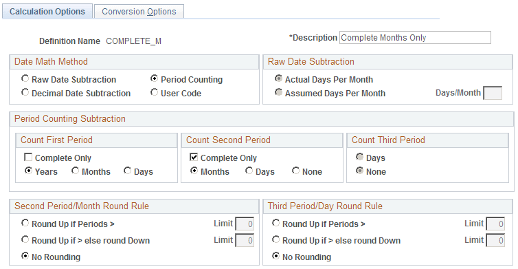

Calculation Options Page
Use the Calculation Options page (PA_AGECALC_PERIOD) to choose a calculation method and set parameters associated with the method.
Navigation:
Set Up HCM, and then Product Related, and then Pension, and then Calculation Rules, and then Duration, and then Calculation Options
This example illustrates the fields and controls on the Calculation Options page.
Duration - Calculation Options page
Date Math Method
Select one of the following date math methods:
  • Raw Date Subtraction
    Also select options in the Raw Date Subtraction, Second Period/Month Round Rule, and Third Period/Day Round Rule group boxes.
  • Period Counting
    Also select options in the Period Counting Subtraction, Second Period/Month Round Rule, and Third Period/Day Round Rule group boxes.
  • Decimal Date Subtraction
  • User Code
Convert months to days in order to perform subtractions when the earlier date has fewer days than the later date. For example:
  1990/11/06
- 1977/12/13
Field or Control Description
Actual Days Per Month
The number of days depends on the month.
In the example, the tenth month (October) is the most recent full month that you can convert to days. October has 31 days, so 90/11/06 becomes 90/10/37.
Assumed Days Per Month
Enter a fixed number of days in the Days/Month field. The system uses this number for every month.
Period Counting
If you choose the period counting method, you need to indicate the period or periods to count. You can count either one type of period, such as years, or you can count successively shorter periods, such as years and then months.
You can define up to three types of counting periods: years, months, and days. You can use any combination of these periods, but you must use them in order: from longest to shortest.
Although you may not want to express shorter units in the final count, you may still want to count them for rounding purposes. For example, if you are only going to count years, but you are going to round by months, you also need to count months.
Count First Period
Select the longest period.
Count Second Period
Select the next longest period, or select None if you do not use the second period.
Count Third Period
Select the third longest period, or select None if you do not use the third period.
Complete Only
When you select this option, the system does not count any shorter periods. If you do not use all three counting periods, select this check box in the shortest period that you do count.
Second Period/Month Round Rule and Third Period/Day Round Rule
If you use raw date subtraction or period counting (both based on raw dates), you can choose to round the dates before calculating a duration. You specify the rounding options in the Second Period/Month Round Rule and Third Period/Day Round Rule group boxes.
You use these group boxes as follows:
  • For raw date subtraction, you specify the month round rule in the Second Period/Month Round Rule group box and the day round rule in the Third Period/Day Round Rule group box.
  • For period counting, you specify the second period in the Second Period/Month Round Rule group box and the third period in the Third Period/Day Round Rule group box.
For example, to round days to months when using raw date subtraction, use the day round rule. To round days to months when using period counting, first check which period counts days. If the second period counts days, use the second period rounding rule, even though the label is Month Round Rule.
Use the options in these group boxes as follows:
  • To round up only, select Round Up if Periods > and enter the threshold in the Limit field. For example, you could round days up to a full month after 25 days.
  • To round up or down, choose Round Up if Periods > … Else Round Down and enter the number of periods in the Limit field.
  • If you do not want to round at all, select No Rounding
These options round the dates that are the duration endpoints. That is, the dates are rounded before the system performs raw date subtraction or period counting. To round the duration itself, or to round the endpoints before performing decimal date subtraction, use the Month Conversion Rules and Year Conversion Rules on the Conversion Options page.
