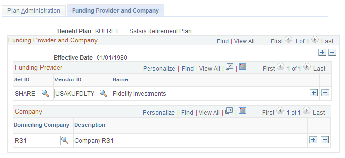

Funding Provider and Company Page
Use the Funding Provider and Company page (PA_PLAN_ADMIN_FUND) to enter funding provider and company information to identify the retiree company associated with a plan and the valid funding providers for the plan.
Navigation:
Pension, and then Pension Information, and then Identify Plan Admin Info, and then Funding Provider and Company
This example illustrates the fields and controls on the Funding Provider and Company page.
Field or Control Description
SetID and Vendor ID
Enter IDs for the funding provider. Only providers included on this page are valid providers when you schedule payments for a pension payee.
Domiciling Company
Enter the retiree company associated with the plan. This is the company—from the Company table—to which you assign payees who receive benefits from this plan. Only companies included here are valid when you create a retiree job.
