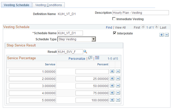

This example illustrates the fields and controls on the Vesting Schedule page.

Schedule Type
Select one of the following five options:
  • Age: Select this option to specify the age requirements for vesting.
    When you select Age, complete the parameters in the Age Result group box that appears.
  • Cliff: Select this option to set up a cliff vesting schedule. A cliff schedule is one of two types of service-based vesting schedules. It grants full vesting after a specified number of years of service.
    When you select Cliff, complete the parameters in the Cliff Service Result group box that appears.
  • Step: Select this option to set up a step vesting schedule. A step schedule is the second type of service-based vesting schedule, where employees vest in increments.
    When you select Step, complete the parameters in the Step Service Result group box that appears.
  • Table: Select this option to set up a table lookup. Enter the alias for your table lookup in the Table Name field that appears.
  • User Code: Select this option to use your own customized vesting rules.

Step Service Result
Fill in this information when you select Step in the Schedule Type field.
Field or Control Description
Result
Enter the name of the step service result.
Service
Enter the minimum years of service for a particular vesting percentage.
Percent
Enter the vesting percentage associated with the number of years you enter in Service.
Note: Do not enter a row for zero service; the system assumes that zero service always results in zero vesting.
