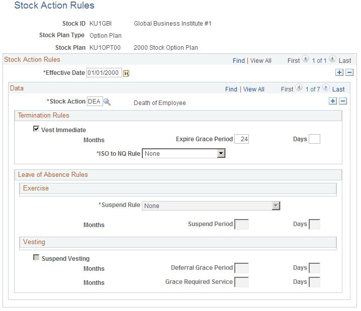

Stock Action Rules Page
Use the Stock Action Rules page (ST_ACTN_RULE) to define processing rules for stock actions.
Navigation:
Set Up HCM, and then Product Related, and then Stock, and then Option Plans, and then Stock Action Rules
This example illustrates the Stock Action Rules page.
Field or Control Description
Stock Action
Select from available options. Define stock actions on the Stock Action Table page.
Termination Rules
If the stock plan type is termination, these fields become available.
Vest Immediate
Select to have all unvested shares vest as of the day before the termination date.
Expire Grace Period
Enter the number of days or months the employee is allowed to exercise vested shares after a termination. The termination expiration date is populated on the vesting schedule with a date equal to the stock action date plus the expire grace period.
ISO to NQ Rule
Specify the governing body rule for calculating the grace period for an ISO exercise after which the exercise is treated as an NQ. Select Disability, Termination, or None, which mean always exercise as an ISO.
Leave Of Absence Rules
If the stock plan type is Leave of Absence, these fields become available.
If the stock action type is Return from Leave, none of the Leave of Absence Rules fields are available. You must enter a new row to enter data in these fields.
Suspend Rule
Specify how the right to exercise is to be suspended during a leave of absence. Select Until RFL to suspend exercise rights for up to two years (the default) until the optionee returns. The system automatically sets the Return from Leave out two years, which is likely to be longer than any leave. When the actual RFL is processed, the system resets this end date. Select Defined to suspend exercise rights for a defined period of time. Select None (the default value) to allow optionees to exercise grants while on leave.
Suspend Period
Available if you select a Suspend Rule of Defined. Enter the number of days or months to suspend the right to exercise options.
Suspend Vesting
Select to suspend vesting of the unvested shares during the leave of absence.
Deferral Grace Period
Available if you selected Suspend Vesting. Enter the number of days or months before which an optionee must return from leave so that the vesting schedule is not deferred by the leave period.
Grace Required Service
Available if you selected Suspend Vesting and the Deferral Grace is greater than 0. Enter the number of days or month's service required for an optionee to be eligible for the vest deferral grace period.
