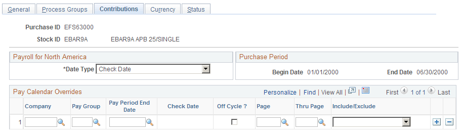

Stock Purchase - Contributions Page
Use the Stock Purchase - Contributions page (ST_PURCHASE_TBL3) to define the contribution parameters.
Navigation:
Stock, and then Stock Purchase Definitions, and then Stock Purchase, and then Contributions
This example illustrates the Stock Purchase - Contributions page.
Payroll for North America
Field or Control Description
Date Type
Select Check Date to indicate the check date for the deduction or select Pay Period End Date to indicate the pay period end date for the deduction. The date must fall between the purchase period begin and end dates.
Pay Calendar Overrides
When deductions for a pay period fall outside the range of the purchase period begin and end dates, you might need to include or exclude a pay calendar. For example, if you selected Check Date as the date type for the purchase on September 30, 1998, then processed a bonus run with a check date of July 2, 1998, the bonus run is not included in the purchase period contributions. However, the bonus is for the period ending September 30, 1998, and should be included in the contributions for the current purchase period. To include the bonus contributions in the current purchase period, you must enter a pay calendar override specifying the company, pay group, pay period end date, and on-cycle or off-cycle, and select Include. This overrides the date, and includes the deductions for the pay calendar selected in the current purchase period.
You can also specify a beginning and ending page number for the pay calendar. This enables you to select a range of employees to include or exclude in the purchase period contributions. This feature is useful for off-cycle checks because you assign the page number.
Pay Group
Select the pay group of the pay calendar to process.
Pay Period End Date
Select the pay period end date of the pay calendar to process.
Check Date
Displays the Check Date for the pay calendar selected.
Off Cycle?
Select to include the calendar in an off-cycle check.
Page and Thru Page
Select the beginning page number and the ending page number of an off cycle to include or exclude.
Include/Exclude
Select Include to include the pay calendar in the Gather Contributions process. Select Exclude to exclude the pay calendar from the Gather Contributions process.
