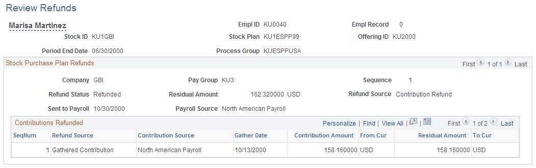

Review Refunds Page
Use the Review Refunds page (ST_REFUND_ESPP) to view the results of the Refund process.
Navigation:
Stock, and then Refunds, and then Review Refunds
This example illustrates the Review Refunds page.
Review Refunds page
Field or Control Description
Refund Status
Displays Reversed or Refunded.
Residual Amount
Displays the amount remaining after a previous purchase.
Sent to Payroll
Displays the date on which the refund was sent to payroll.
