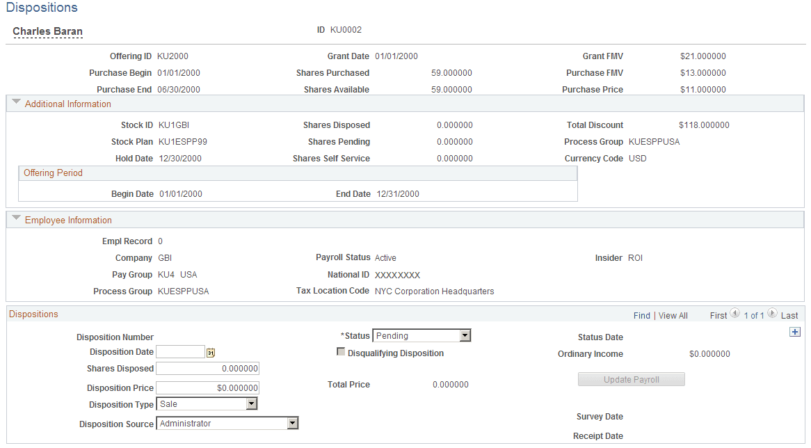

Stock Purchases - Dispositions Page
Use the Stock Purchases - Dispositions page (ST_ESPP_DISPOSN) to record a participant's stock sales.
You must first confirm a purchase.
Navigation:
Stock, and then Stock Purchases, and then Dispositions
This example illustrates the Stock Purchases - Dispositions page.
Stock Purchase Information
Field or Control Description
Shares Available
Displays the number of shares remaining that can be sold or transferred. This number is recalculated each time you enter a disposition or when the disposition status changes. The number of shares available equals the number of shares purchased less the sum of shares disposed.
Grant FMV
Displays the grant FMV associated with the grant, which is used for calculating ordinary income.
Additional Information
Hold Date
This date is the purchase period end date plus the holding period number of months specified for the stock purchase plan. This date must be greater than or equal to this date, or the system produces a warning message.
Shares Disposed
Shares Pending
Displays the number of shares that are pending confirmation.
Shares Self Service
Displays the number of shares entered as disposed through self-service.
Total Discount
Displays the discount off the purchase price.
Process Group
Displays the process group at the time of the stock purchase. Process groups are defined on the Process Groups setup page.
Begin Date and End Date
Displays the offering period begin and end dates.
Disposition Information
The system checks the rules defined on the Governing Body Rules - Stock Purchase Rules page to determine if the required holding period is met for preferential tax treatment. If the requirements are not met, the disposition is not qualified.
Disposition Number
This number is assigned when you save the page and comes from the Stock Table. It provides an audit trail of all dispositions and cannot be deleted.
Disposition Date
Enter the date of the sale or transfer, which is used to determine whether the disposition is qualifying or disqualifying.
Note: This date cannot be earlier than the hold date specified at the stock plan level.
Shares Disposed
Enter the number of shares sold or transferred.
Disposition Price
Enter the sale or transfer price of the disposition.
Disposition Type
Select Sale (default) or Transfer. You must enter the type after the disposition status is changed to Confirmed.
Disposition Source
Select:
Administrator: Source of the disposition information is the stock administrator. (Default.)
Self Service: Participant reported disposition using the self-service page.
Third Party: Broker reports the disposition.
Status
Select the disposition's current status: Confirmed, Pending (default), and Void.
Disqualifying Disposition
If the system determines that the sale is a disqualifying disposition, it selects this check box.
Total Price
Displays the price of the sale, calculated by multiplying the disposition price by the shares disposed.
Status Date
Displays the date on which the status changed.
Ordinary Income
Displays ordinary income resulting for the disposition.
Sent to Payroll
Displays the date on which the transaction was sent to Payroll for North America or the manual payroll report was run for a disqualifying disposition with ordinary income. Click the date to access the Stock Purchase Disposition Payroll Data page, where you view payroll details.
Update Payroll
Click to send the disposition information to payroll.
Survey Date
This date appears after the stock purchase Disposition Survey report is run and the survey is printed.
Receipt Date
This date appears after the stock purchase Disposition Receipt report is run and the receipt is printed.
