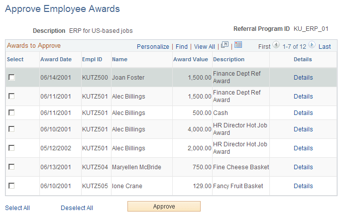

Approve Employee Awards Page
Use the Approve Employee Awards page (HRS_MASS_APRV) to approve referral awards that have the status of Needs Approval.
Navigation:
Recruiting, and then Employee Referrals, and then Approve Employee Awards
This example illustrates the Approve Employee Awards page.
All awards that have the Needs Approval payment status appear on this page.
Field or Control Description
Select
Select the referral awards that you want to approve.
Details
Click to access the Referral Award Details page, where you can view referral award details.
Select All
Click to select all referral awards in the list, including those outside the view area.
Approve
Click to approve the selected referral awards. After awards are approved, they do not appear on this page again.
