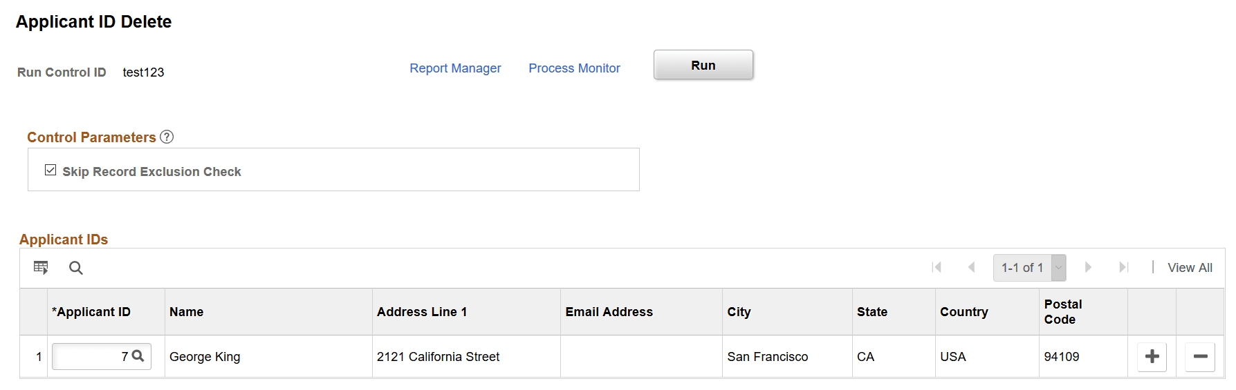

Applicant ID Delete Page
Use the Applicant ID Delete page (HRS_APP_ID_DELETE) to select applicant to be deleted and run the applicant delete process.
Navigation:
Set Up HCM, and then System Administration, and then Database Processes, and then Applicant ID Delete
This example illustrates the Applicant ID Delete page.
Field or Control Description
Run
Click the Run button to access the Process Scheduler Request page, where you can run or schedule the Applicant ID Delete process. Before the Process Schedule Request page appears, the system displays a warning that the deletion process is irreversible.
Control Parameters
Skip Record Exclusion Check
Select this check box to ignore the Exclude Records settings on the Applicant ID Delete Control Page.
This check box is deselected by default. With this default setting, the deletion process does not affect tables that the process is configured to exclude.
When you select this check box, all applicant data is deleted.
Note: Only users with the role ID Delete User can modify this setting.
Applicant IDs
<sequence number>
If you enter multiple applicant IDs in the grid, the Applicant ID Delete process runs through each applicant in sequence. The sequence number matches the process sequence number that appears on the Applicant ID Delete Log Page .
Applicant ID
Enter the applicant ID for the applicant to be deleted. The system populates the other columns in the grid with the applicant’s name, address, and email address. This read-only information helps you verify that you’ve entered the correct applicant ID.
After you run the deletion process, all applicant data (including the applicant ID) is cleared from the grid.
The maximum number of rows you can delete is 999.

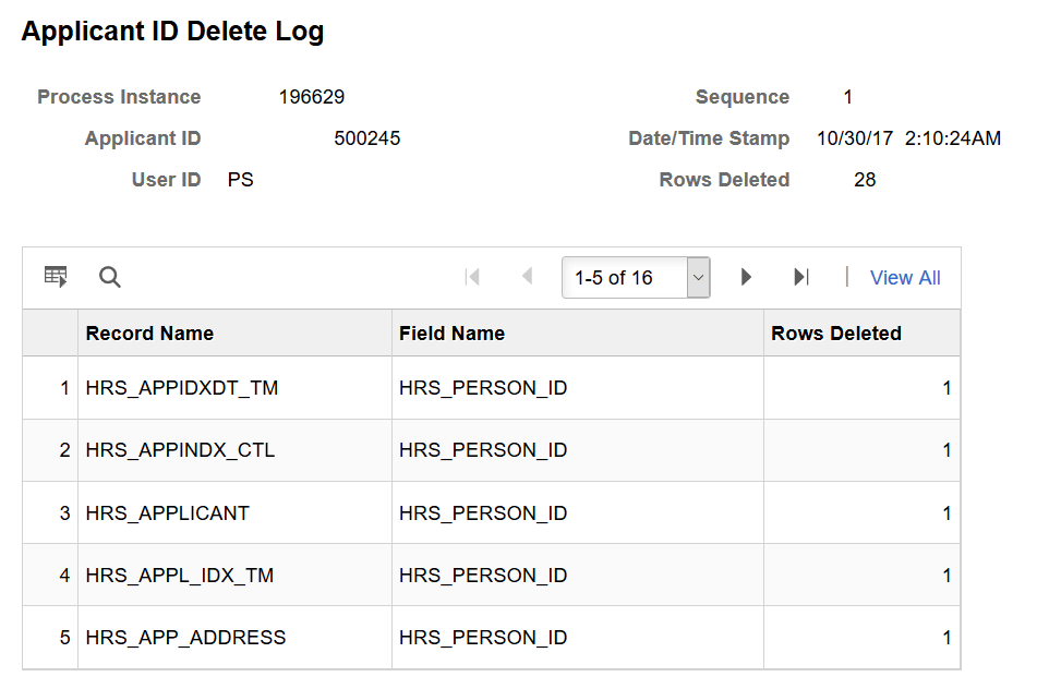

Use the Applicant ID Delete Log page (HRS_APP_ID_DEL_LOG) to review the data that was deleted for a specific applicant ID.
Navigation:
Set Up HCM, and then System Administration, and then Database Processes, and then Applicant ID Delete Log
This example illustrates the Applicant ID Delete Log page.
Process Information
Process Instance
Identifies the specific instance of the Applicant ID Delete process that you are reviewing.
Sequence
The Sequence number reflects the order in which the Applicant ID Delete process handles multiple applicants. For example, if an instance of the process deletes three applicants, the Sequence number 1 is assigned to the first applicant to be deleted and 3 is assigned to the last applicant to be deleted.
Applicant ID
Displays the original applicant ID for a single applicant who was deleted.
A single instance of the process can delete multiple applicant IDs, but this page displays information for only one applicant at a time.
Date/Time Stamp
Indicates when the Applicant ID Delete process ran. This is the date and time for the process instance, so it is the same for all applicants who were processed together.
User ID
Identifies the user who ran the specified instance of the Applicant ID Delete process.
Rows Deleted
Displays the total number of rows (across all records) that were deleted for the specified applicant.
Record Details
Record Name
Identifies a record where rows were deleted.
Field Name
Identifies the applicant ID field in the record. Typically the value is HRS_PERSON_ID.
Rows Deleted
Displays the number of rows that were deleted from the specified record.
