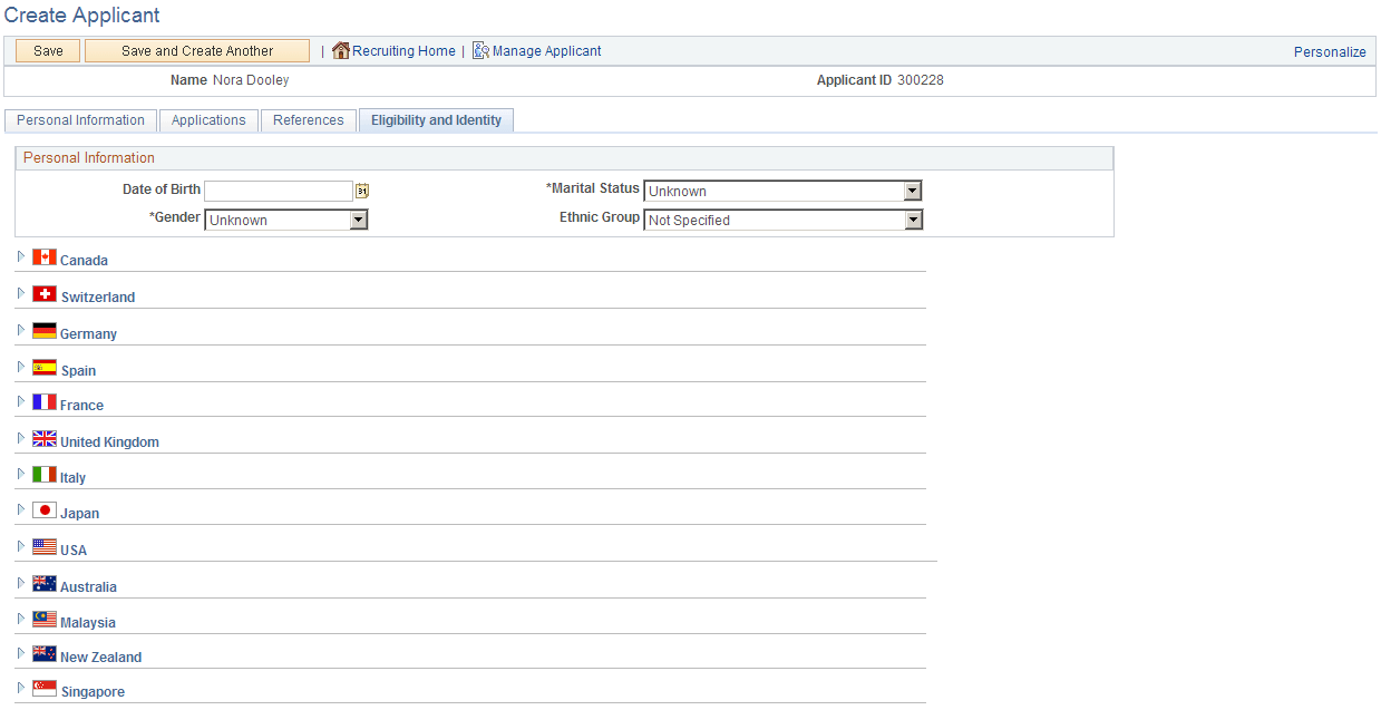

Create Applicant page: Eligibility & Identity Tab
HRS_ADD_APPLICANT
Manage eligibility and identity information that may be required to comply with local or country regulatory requirements

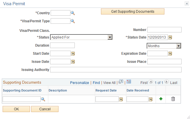

Visa Permit Page
HRS_APP_VSA_PMT1
Enter visa permit information for an applicant.

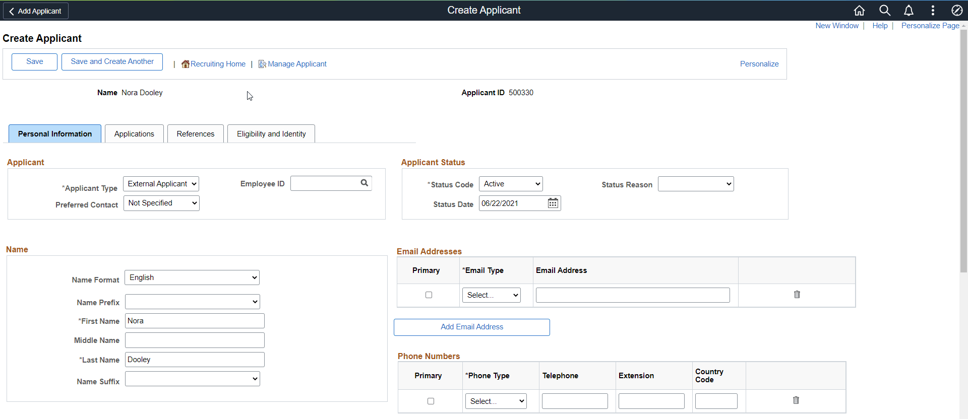

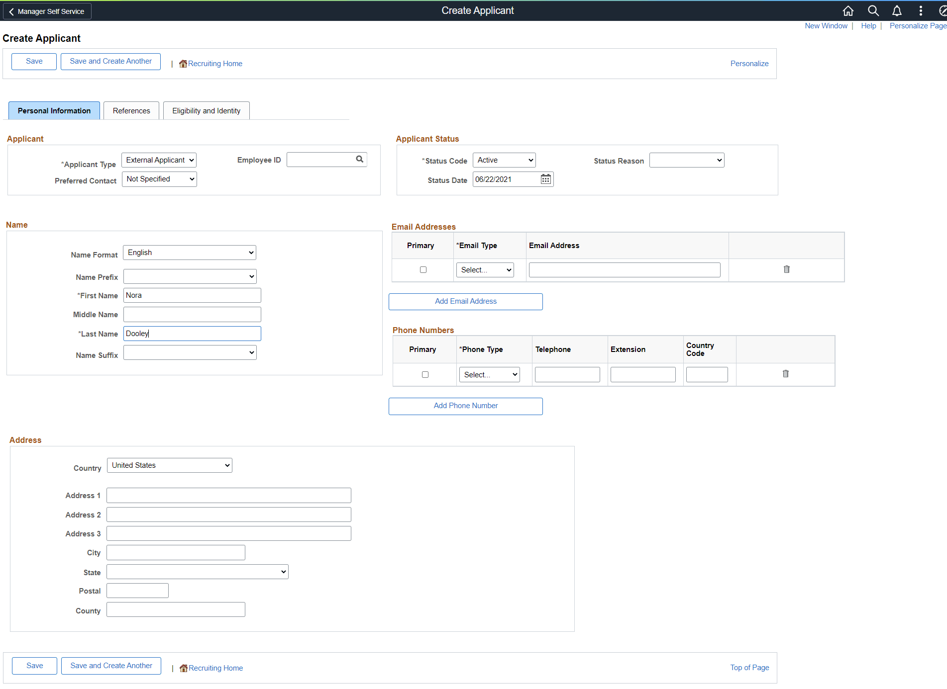

Initially, the Create Applicant page includes three tabs: Personal Information, References, and Eligibility and Identity. When you save the applicant, the Applications tab appears, and identifying information about the applicant appears in the header area between the toolbar and the tabs.
This example illustrates the Create Applicant page before saving, when there are three tabs.
This example illustrates the Create Applicant page after saving. Now there are four tabs, and the applicant’s name and ID are displayed at the top of the page. Also, the toolbar now includes the Manage Applicant button for accessing the Manage Applicant page.

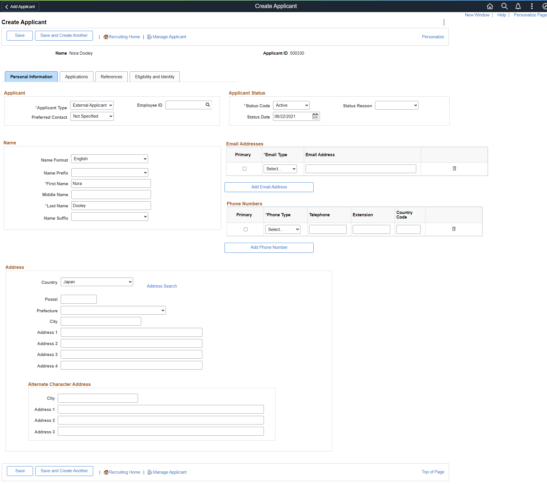

This example illustrates the Create Applicant page: Personal Information tab
Applicant
Field or Control Description
Applicant Type
Select the type of applicant: External, Employee, or Non-Employee.
Non-employee indicates that the applicant is a person of interest (rather than an employee) in your Human Resources system.
When Candidate Gateway creates an applicant record, it assigns the applicant types based on the navigation or link that the applicant used to access the site.
Preferred Contact
Select the preferred method of contact for the applicant. Values are: Email, Mail, Phone, and Not Specified.
Employee ID
If this is an employee or a person of interest in the system, select the employee ID.
If you have not yet saved the applicant record, entering an employee ID sets the applicant type to Employee or Non-Employee based on the information in PeopleSoft Human Resources. When you enter an employee ID, the system imports the employee’s personal information and eligibility & identity data into the applicant record, replacing any existing data. Clearing the field reverses these changes.
When you first save a record where an employee ID has been entered, the system brings employee profile data into the new application that is created.
After you save the record, changes to the employee ID do not affect any other fields. Additionally, when you view applicant data on the Manage Applicant page, the Employee ID field is hidden when the applicant type is External.
See Understanding Profile Information in Job Applications.
Name
Use this group box to enter the name information for the applicant. Select the name format to determine the type of name fields displayed under this section such as the first name, last name, and preferred first name. To know more on the name fields for the selected name format, see Application Fundamentals: Name Format Type Page.
Talent Acquisition Manager displays only the standard field labels for the names. The customized field labels do not appear in the Create Applicant page.
PeopleSoft HCM supports alternate character data entry to enable users to use two character sets for one language. This architecture is described in the topic Application Fundamentals: Working with Alternate Character Sets.
The Alternate Character Name field appears if alternate character setting on the Application Fundamentals: Org Defaults by Permission Lst - Defaults Page is enabled for the user’s primary permission list and if the Format Using field is Chinese, Hong Kong, or Japanese.
If the recruiting administrator or the recruiter does not provide any value for the Preferred First Name, the First Name value is set as default value for the Preferred First Name.
Address
Use this group box to enter a single address for the applicant. The fields that appear change depending on the country that you select in the Country field. Define address formats on the Application Fundamentals: Display and Print Page in the Country Table (COUNTRY_TABLE) component.
The Alternate Character fields within the Address group box appears if alternate character functionality is enabled for the user’s primary permission list and if the Country in the Address group box is China, Hong Kong, or Japan.
Address fields (with lookup) appear as drop-down by default. However, this configuration can be changed from the framework using the Country Format setup. For more information, see Application Fundamentals: Entry and Validation Page
The system displays warning messages when any address fields are left blank. If it is not a mandatory field, the user can ignore the message and save the data.
Applicant Status
Status Code
Select a status code. This is the overall applicant status, not the applicant's disposition with regards to any particular job opening.
You can use the statuses that are provided with the PeopleSoft system, or you can define your own statuses on the Recruiting Status and Reason Page. As delivered, the statues are:
  • Active: This is the default status for new applicants.
    The system also assigns this status when an applicant's resume is in a Success status as part of the resume extraction process.
  • Hired: The delivered status change effect rules ensure that the applicant's overall status is set to Hired when the applicant's disposition for a particular job opening changes to Hired.
  • Inactive: Under the delivered installation settings, the system uses this status to inactivate duplicate records during the applicant merge process.
    The system also assigns this status when an applicant's resume is in a Rejected status as part of the batch resume extraction process, which you run from the Load Resume - Prepare Load Parameters Page.
    Under the delivered status change effects, when you change an applicant's status to Inactive, the applicant's disposition for any job openings that they have applied for is set to Withdrawn. The system excludes inactive applicants from job opening screening.
  • Queued: The system assigns this status when an applicant's resume is in a Draft or Unresolved status as part of the resume extraction process.
    A recruiter could also set this status to indicate that additional information needs to be collected or some other action is needed before the applicant becomes active.
Status Reason
Select a status reason. Define status reasons for status codes on the Recruiting Status and Reason Page.
Status Date
Enter a status date.
The date defaults to the system date. You can use this date for equal employment opportunity (EEO) reporting and other auditing functions.
Registered Online
This field is not visible in add mode (on the Create Applicant page), but it appears when you view personal information on the Manage Applicant page: Applicant Data page.
This read-only field displays Yes or No to indicate whether the applicant is a registered user of Candidate Gateway. The value remains Yes even if the Candidate Gateway account is deactivated.
Inactivate Online Account
This field is visible only if the Registered Online field is Yes. Like the Registered Online field, is it not visible in add mode (on the Create Applicant page). Instead, it appears when you view personal information on the Manage Applicant page: Applicant Data page.
Select this check box to make the applicant’s Candidate Gateway account inactive. Deselect the checkbox to reactivate the account.
You cannot reactivate accounts that deactivated by the applicant merge process. The system recognizes such accounts by their status, which indicates that the account was a duplicate.
Email Addresses
Use this group box to enter email address information for the applicant. The Email Address Required field on the Recruiting Installation – Applicants Page controls whether applicants who register in Candidate Gateway are required to supply an address, but it does not effect whether an email address is required in this grid.
Primary
If any email addresses are listed, one must be marked as primary. The system uses this email address when sending correspondence and notifications. The preferred email address also appears on the My Applicants pagelet on the Recruiting Home page.
Email Type and Email Address
Enter the applicant’s email address and identify it as Business, Campus, Dormitory, Home, or Other. You cannot have more than one email address for each email type.
Phone Numbers
Use this group box to enter phone information for the applicant.
Primary
If any phone numbers are listed, one must be marked as primary. The preferred phone number also appears on the My Applicants pagelet on the Recruiting Home page.
Phone Type
Identify each phone number as Business, Campus, Cellular, Dormitory, Fax, Home, Main, Other, Pager 1, Pager 2, or Telex. You cannot have more than phone number for each phone type.
Telephone, Extension, and Country Code
Enter the phone number.

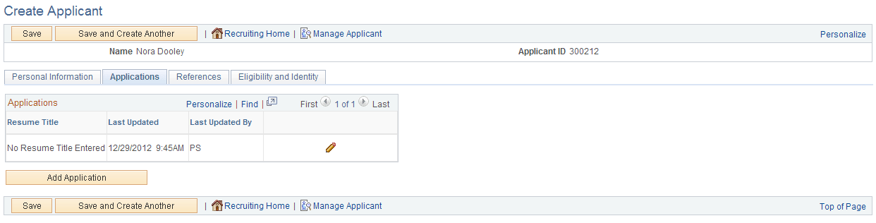

This example illustrates the Create Applicant page: Applications tab.
You can create multiple applications for an applicant.
Applications
This grid lists the applicant’s applications. There is always at least one application because the system creates an application when you first save the applicant record.
Resume Title
Displays the title of the resume that is associated with the application. If the application does not include a resume, or if the resume has no title, this field displays No Resume Title Entered.
Last Updated and Last Updated By
These fields display information about the last update to the application data.
Edit iconEdit Application Details
Click this link to access the Application Details page, where you can view and modify the application data.
Remember that the system creates a blank application when you first save the applicant record. The best practice is to use this existing application for the applicant’s first job application. Until you enter a job opening ID for the application, the application is considered to be an application without a job opening.
If you exit the Create Applicant component, use the Edit Application Details action to access and update the existing application.
See Understanding Actions for Managing Applicants.
Add Application
Click this link to access the Application Details page for a new application.

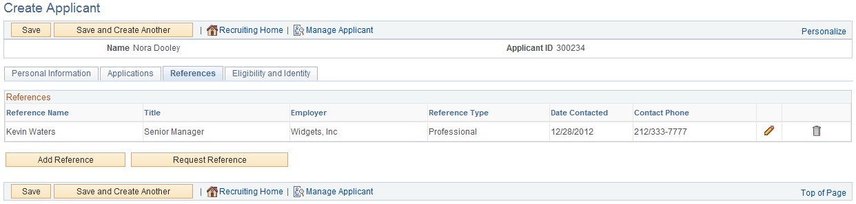

This example illustrates the Create Applicant page: References tab.
References
Use this group box to view summary information about each reference. This data comes from the Reference Details Page.
Edit iconEdit References
Click to access the Reference Details page. Use the Reference Details page to view and edit detailed information about the reference.
Additional Buttons
Add Reference
Click to access the Reference Details page, where you can enter new reference information for the applicant.
Request Reference
Click to send a request for references email notification (HRS_UPDATE_REFERENCES) to the applicant. The applicant must have a primary email address so that the system can send this request.
The notification instructs the applicant to use Candidate Gateway to enter reference information. If the applicant is not yet a registered user of Candidate Gateway, the system generates a Candidate Gateway user ID and password for the applicant and includes them in the email notification. By using these system-generated logon credentials, the applicant ensures that the Candidate Gateway account is properly associated with the existing applicant record. The auto-generated password is valid for a single use, and the applicant is prompted to change the password immediately after signing in.
In Candidate Gateway, the Notifications page displays the request for references. The applicant must click the notification link to access the page where reference information is entered.
