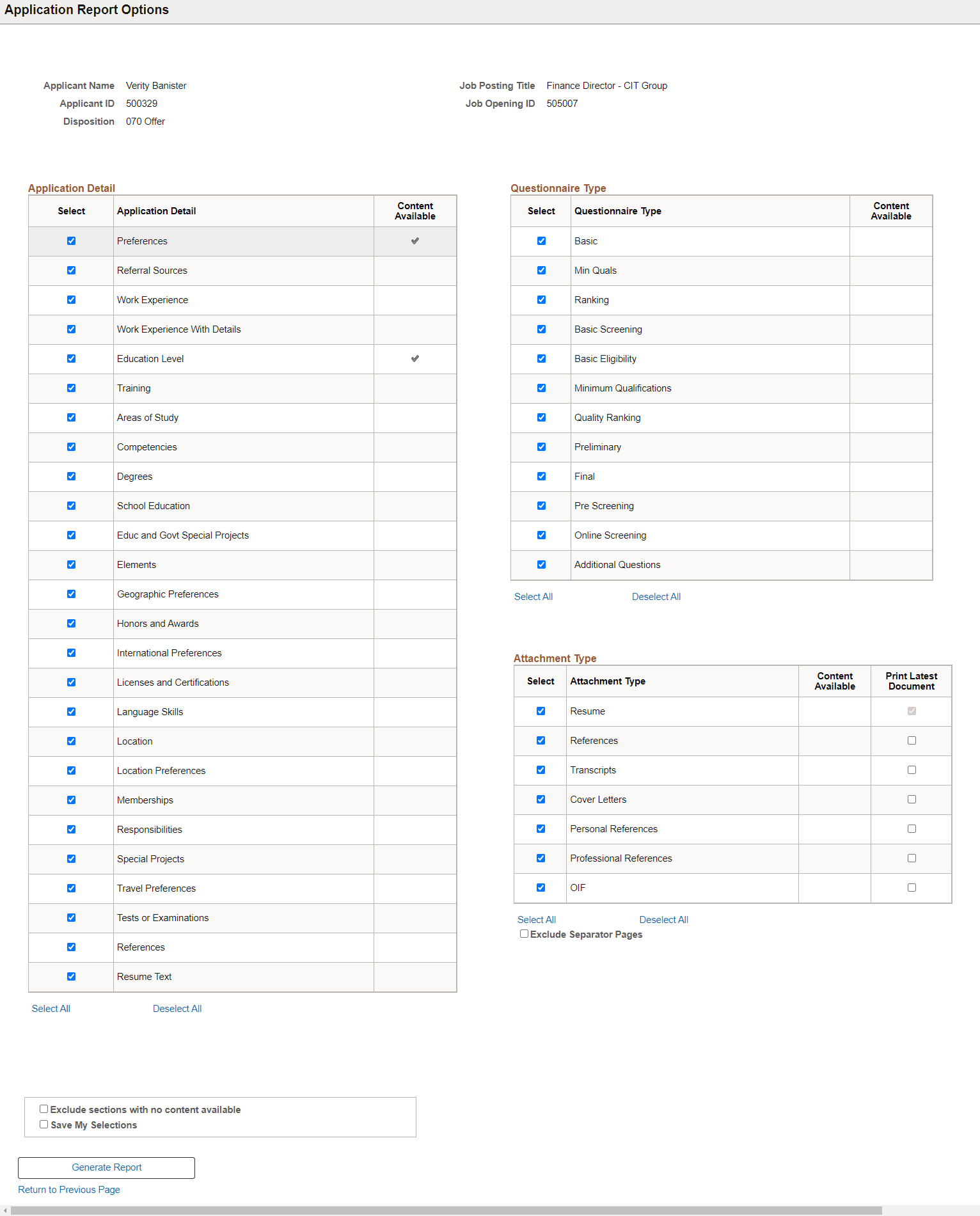

Application Report Options Page
Use the Application Report Options page (HRS_PRNT_APPLN) to choose printing parameters then print application details for a single application.
Navigation:
Click the Print icon on any of these pages:
  • Search Applicants (all searches except for Quick Search)
  • Manage Applicant
  • Search Applications
  • Manage Application (has a Print button on the Toolbar)
  • Manage Job Opening
  • Browse Applicants
  • My Applicants pagelet on the Recruiting Home page
This example illustrates the Application Report Options page.
Header
The fields at the top of the page identify the applicant and, if relevant, the job opening for the application that is being printed.
When you access this page from the Browse Applicant page, the job opening is the most recent one that the applicant applied for.
When you access this page from the Keyword Search or the Advanced Search on the Search Applicants page, the system does not identify the job opening that the applicant originally applied for.
Grids for Selecting Report Content
The printed report always includes general information about the applicant and the job opening, including the applicant’s contact information. The report options page does not list those fields because they are not optional.
Field or Control Description
Application Detail
This grid lists the main types of application data that can be printed. The list includes all sections that are available on the Application Details page, not just the sections that are in the resume template for the job opening.
Options include:
  • General-purpose recruiting information: Preferences, Referral Sources, Work Experience, Education level, Training, References, and Resume Text. Resume text does not include attached resume files, which are listed in the Attachment Type grid on this page.
    Note:Work Experience is an abbreviated form of the application information. Select Work Experience With Details to include the work address and work description details in the application report.
  • U.S. Federal sections, which appear only in federal implementations: Federal Preferences and Priority Placement.
  • The profile content types that appear on the Content Section Configuration – <Content Type> Page.
Questionnaire Type
This grid lists the lists all the different screening levels that your organization uses, regardless of whether they’re used for this particular job. When you include a screening level, the printed report includes all questions that are used for that screening level.
The last row in this grid is for Additional Questions. These are questions that are included in the job application that are not used for screening.
If an application without a job opening includes prescreening questions from the site’s default resume template, selecting any prescreening screening level causes the prescreening questions to be included in the report.
Attachment Type
Note: This grid is visible only if you use PeopleTools 8.55 or higher. With earlier versions of PeopleTools, you cannot print attachments as part of the Application Details report.
This grid lists all available attachment types in the system. Selected attachment types are appended to the report PDF.
Page Elements for All Grids
Select
Select this check box to include the specified content in the printed applications.
Below each grid, Select All and Deselect All links enable you to quickly select or deselect all items in the grid.
Content Available
A check mark in the Content Available column indicates that the current application includes the specified type of information.
In screen reader mode, this column displays the word Yes instead of a check mark.
Page Elements for the Attachment Type Grid
Print Latest Document
If an application includes more than one attachment of a given type, the printed application includes all of the attachments unless you select the Print Latest Document check box. Selecting this check box restricts printing to the most recently uploaded file.
This check box is selected and disabled for Resume attachments because an application cannot have more than one resume attachment.
Exclude Separator Pages
Attachments are printed as-is, without any contextual information about the application. By default, this contextual information appears on separator pages that are inserted before each attachment. However, you can select the Exclude Separator Pages check box to suppress these extra pages.
There is an option on the Recruiting Installation – Applicants Page to suppress separator pages entirely. When this system-level option is selected, the Exclude Separator Pages check box is not shown to end users.
Additional Page Elements
Exclude sections with no content available
Select this check box to suppress empty sections from the printed output. If this check box is not selected, the report prints headers and an explanatory message for all of the empty sections.
Use this check box in conjunction with the Select All links to efficiently exclude empty sections without having to manually select the individual sections with data.
Save My Selections
Select this check box to save your current settings as the default settings for this page.
This page does not have a Save button, so the settings are saved when you click the Generate Report button.

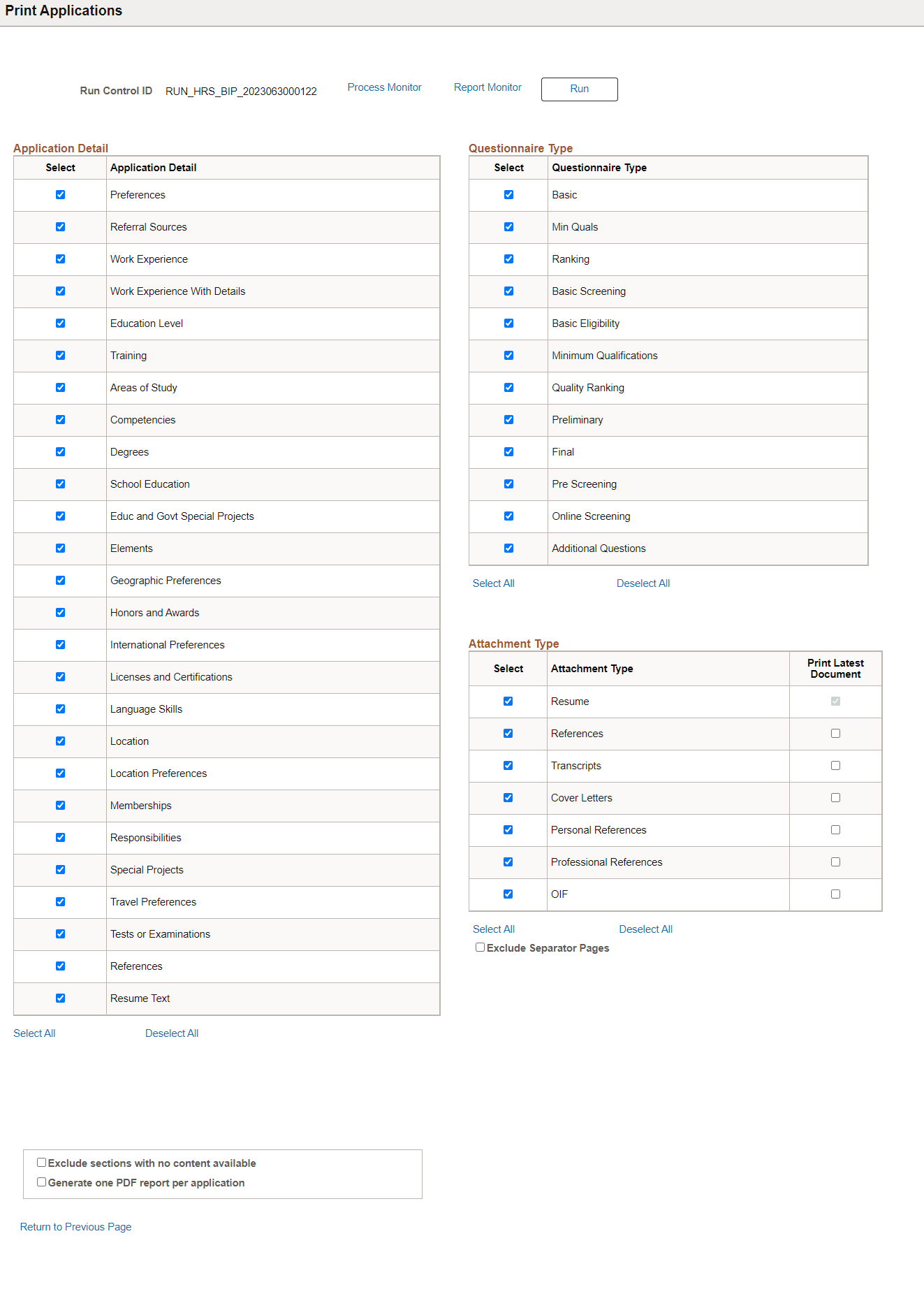

Print Applications Page
Use the Print Applications page (HRS_RUN_BTCH_APPL) to choose printing parameters then run the Application Details (HRS_BTCH_APL) application engine process. This batch process prints application details for a group of selected applications.
Navigation:
Select Group Actions, and then Recruiting Actions, and then Print Applications on any of these pages:
  • Manage Applicant
This example illustrates the Print Applications page.
This page is identical to the Application Report Options Page, except for some differences so that it can support batch printing of applications. This documentation describes only those differences.
Additional Page Element for Batch Printing
Run
Click to access the Process Schedule Request page, where you can and run the Application Details (HRS_BTCH_APL) application engine process to print the selected applications.
Clicking this button saves the batch printing settings on this page, regardless of whether you actually run the report. The saved settings become your default settings the next time you access this page, even if you access it for a different group of applicants.
Batch print options are saved separately from the printing options for a single application.
Generate one PDF report per application
Select this check box if you want to create separate PDF files for each application. If this check box is blank, the system creates a single PDF file with all included applications.
Other Differences for Batch Printing
  • Because this page is for multiple applications, the page does not display information about individual applications.
    Specifically, the page header does not display applicant and job information, and the selection grids do not include Content Available columns.
  • You run the report using the Run button and other standard run control page elements. There is no Generate Report button to create the report instantly.
  • There is no Save My Selections check box; clicking the Run button always saves your selections.
