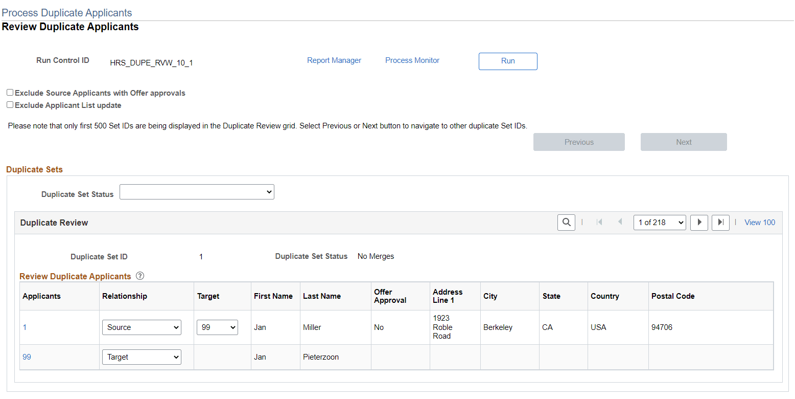

Review Duplicate Applicants Page
Use the Review Duplicate Applicants page (HRS_DUPE_REVIEW) to review potential duplicates, choose source and target applicants for merging, and initiate the merge process.
Navigation:
  • Click the View Duplicates link on the Process Duplicate Applicants page.
  • Select Group Actions, and then Applicant Actions, and then Merge Applicants on the Manage Job Opening page: Applicants tab.
  • Click the Merge button on the Manage Job Opening page: Applicant Screening tab: Screening Results section.
This example illustrates the Review Duplicate Applicants page.
Field or Control Description
Run
After you have reviewed potential duplicates and identified records that you want to merge, click the Run button to initiate the Duplicate Applicant Merge process and complete the merge for the indicated records.
You can process subsets of the potential duplicates. For example, you can run the process for the first 10 duplicate sets and then the rest at a later time.
Note: After you start the Duplicate Applicant Merge process, you cannot cancel it. You must be certain that you want to merge the applicant records before you schedule the process.
Exclude Source Applicants with Offer Approvals
Select this check box if you do not want to merge source applicants who have offers with approval processes. Approval information is not copied to the target applicant during a merge, so excluding source applicants with offer approvals prevents the system from copying offers without the accompanying approval information.
If any source applicants have offer approvals, the system creates a log file containing information about these applicants. The log gets created regardless of whether the applicants were excluded from the merge, and the log file header states whether the applicants were excluded. The log includes identifying information about the applicant, the offer, and the approval process.
Exclude Applicant List update
Select this check box if you want to merge applicants without an applicant list update during the Duplicate Applicant Merge process.
Previous and Next
This page lists a maximum of 500 sets of duplicates. If more than 500 sets of duplicates exist, use the Previous and Next buttons to navigate to the previous or next sets of duplicate applicants.
Note: The merge process includes all sets of duplicates where sources and targets have been identified, regardless of whether the set is included in the currently visible list of 500 sets.
Duplicate Set Status
By selecting a value in this field, you can filter the data in the Duplicate Review scroll area based on the status of the duplicate set. The possible statuses (and thus the available filter values) are Error, Merged, No Merges, and Ready for Merge.
Duplicate Review
Use this group box to specify how the system merges duplicate applicant records. Applicants with matching data are grouped into duplicate sets. Review each set and decide if the applicant records are duplicates.
Duplicate Set ID
Displays the ID number for the duplicate set. Refer to the group box header to see how many total duplicate sets exist.
Displays the status of the merge process. Values are Error, Merged, No Merges, and Ready for Merge.
Applicants
Click the applicant ID link to access the Manage Applicant page, where you can view additional details for the applicant. (On the Manage Applicant page, clicking the Applicant List link returns you to the Review Duplicate Applicants page.)
Relationship
Specify how the applicant records are merged. Values are Source and Target. For each duplicate set, there can be multiple source and target records. You cannot edit these fields after you run the Duplicate Applicant Merge process and merge the applicants.
Leave these fields blank if you determine that the applicants in a duplicate set are not duplicates or if you have not yet made a determination.
Target
Select the target for each source record. The drop-down list box lists the applicant IDs for applicants in the same duplicate set who have been identified as targets.
This column becomes visible after you select Source in the Relationship column for an applicant. The field is available only for source applicants.
Offer Approval
Displays Yes if the applicant has an offer that has an approval process, regardless of the status of that approval process.
Displays No if the applicant has an offer that does not have an approval process. This occurs if offer approval functionality was not active when the offer was created.
This field is blank if the applicant does not have an offer.

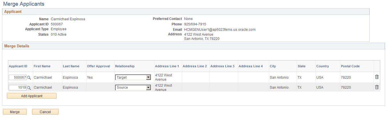

Merge Applicant Page
Use the Merge Applicant page (HRS_APP_MERGE) to merge the selected applicant record with one or more other applicants that you identify.
Navigation:
On the Manage Applicant page, click the Merge Applicants toolbar button.
This example illustrates the Merge Applicant page when you select the Merge as Source option, which uses the selected applicant as the source applicant for the merge.
Merge Applicant page: merge as source
Applicant
This group box displays information about the current applicant. This is the applicant from whose record you clicked the Merge Applicants toolbar button.
Merge Details
This grid lists the applicant records to be merged. The current applicant is automatically listed. The user manually adds other applicant records.
Applicant ID
Enter the unique identifier for the applicant record that is to be included in the merge process.
Offer Approval
Relationship
Select Target for the target row for the merge. Only one row can be designated as the target.
Select Source for all source rows for the merge.
The default row that is created for the current applicant has a default relationship of Source, but rows that you manually add do not have a default relationship.
Add Applicant
Click this button to add a new row to the list of applicants to be merged.
Merge Button
Merge
Click to run the Duplicate Applicant Merge process and complete the merge.
The system displays a message to update the applicant list. The user can choose to merge applicants with or without applicant list update.
If any of the source applicants have offer approval processes (indicated by a Yes value in the Offer Approval field), a warning indicates that the offer approval information will not be merged. You can continue anyway, or you can cancel the merge.
