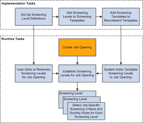

The following diagram illustrates the steps to be taken during system implementation, when you set up screening levels and add them to templates, and the steps to be taken at runtime, when users establish screening levels for a particular job opening and define the job-specific screening criteria.
Set up screening levels during implementation; define screening criteria for individual jobs at runtime.

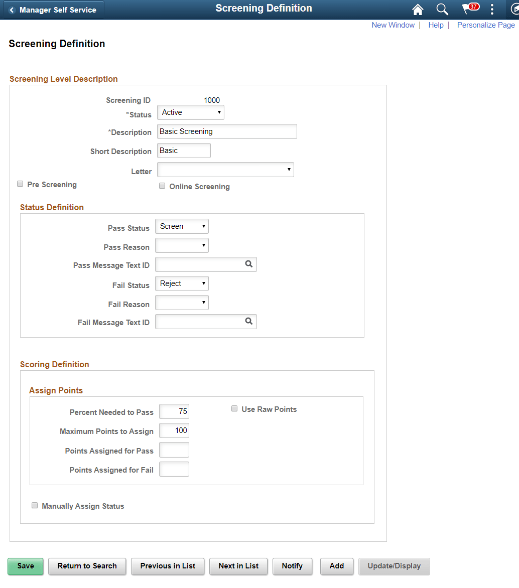

Screening Definition Page
Use the Screening Definition page (HRS_SCREEN_TBL) to set up screening definitions.
Navigation:
Set Up HCM, and then Product Related, and then Recruiting, and then Screening, and then Screening Levels, and then Screening Definition
This example illustrates the Screening Definition page.
Screening Level Description
Enter basic information about the screening level.
Field or Control Description
Status
Select whether this screening level is Active or Inactive.
Description
The system uses the full description (rather than the short description) to identify the screening level on the various recruiting pages that includes references to screening levels.
Letter
Select the default letter to send to applicants who fail this screening level. The letter is added to the queue for the Generate Recruitment Letter (HRSLETTR) process after screening results are applied.
The drop-down list box includes all of the letters in the HRS_APP_LET report definition, which includes letters for various purposes. Take care to select the appropriate letter. The sample rejection letter that Oracle delivers is HRS_APP_LETTER_IR.
Note: Prescreening and online screening levels do not use this setting.
See Generate Recruitment Letters Page.
Users can override this default selection when they configure job-specific criteria for the screening level on the Job Opening Screening - Criteria page.
Pre Screening and Online Screening
Select one of these check boxes to mark this as a screening level for either prescreening screening or as online screening. You cannot select both check boxes.
Leave both check boxes deselected if you are defining a standard screening level.
See Understanding Prescreening and Online Screening.
Status Definition
Your choices in these fields provide default values for the equivalent fields on the Job Opening - Screening Criteria page (the page where recruiters configure the screening level for a specific job opening). Recruiters can override the default statuses, but not the associated messages.
See Job Opening - Screening Criteria Page.
Pass Status and Pass Reason
Optionally select the default disposition (and, if desired, an associated reason) to assign when an application passes this screening level.
Typically, you assign the Screen disposition for standard screening levels, and you either leave the fields blank or select the Applied disposition for online screening and prescreening.
For prescreening, the Pass Status is not applied until the application is submitted.
Fail Status and Fail Reason
Select the default disposition (and, if desired, an associated reason) to assign applicants who fail this screening level. This setting is optional in the screening definition, but when you set up prescreening for a specific job opening, it is required. (It is never required for standard screening and online screening).
Typically, you assign the Reject disposition for standard screening levels, the Failed Prescreening disposition for prescreening, and the Reject Online Screening disposition for online screening.
Pass Message Text ID and Fail Message Text ID
If either the Pre Screening or Online Screening check box is selected, select the IDs for the messages that Candidate Gateway presents to applicants who pass and who fail this screening level. If neither check box is selected, leave these fields blank.
Note: Messages are mandatory for prescreening and optional for online screening. Standard screening levels do not use these settings.
Scoring Definition
Your choices in these fields automatically populate the equivalent fields on the Job Opening - Screening Criteria page. Recruiters can override the default values.
Percent Needed to Pass
Enter the minimum percentage amount of the total possible points for all screening criteria that an applicant must have to pass the screening level.
Note: Unless all questions have the same point value, this percentage is not necessarily the same as the percentage of questions that the applicant must answer correctly.
For U.S. federal salaried screening, the first screening level typically requires applicants to achieve 100% to pass.
For U.S. federal hourly screening, the first screening level typically requires applicants to achieve 50% to pass.
For both types of U.S. federal screening, you can typically leave these fields blank for the second screening level, which typically uses transmutation to calculate a score.
Use Raw Points
Select this check box if you want applicant's scores for the screening level to be the total points that the applicant earned by meeting individual screening criteria for this screening level.
If you select this check box, do not enter values in the Points Assigned for Pass and Points Assigned for Fail fields.
Maximum Points to Assign
If you select the Use Raw Points check box, use this field to optionally enter a maximum number of points to assign, regardless of the applicant's raw points.
Enter scores to assign to all applicants who pass or fail this screening level. Do not enter a value if you are using raw points as the applicant's score.
To assign zero points when an applicant fails the screening level, enter 0 rather than leaving the field blank.
Manually Assign Status
Select this check box to allow recruiters to manually set an applicant's the pass/fail status for a screening level. Recruiters can set this status with or without running the screening process, which will still calculate the applicant's score and set an initial pass/fail status if it runs.
When this check box is selected, the rest of the scoring-related page elements become read-only.
