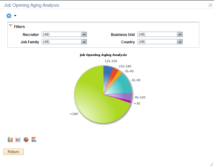

This example illustrates the Job Opening Aging Analysis pivot grid.
The Job Opening Aging Analysis pivot grid displays counts of open job openings in predetermined age bands. The age bands are <30 days, 31–60 days, 61–90 days, 91–120 days, 121–150 days, 151–180 days, and > 180 days.
A job’s age is the number of days since the earliest posting date or, if no postings exist, the number of days since the date the job was opened.
By default, the data appears as a pie chart.

Enter the From Date to define the date range for the pivot grid. Only jobs opened on or after the specified date are included in the chart.
Initially, the chart includes data for jobs that were opened within the past year.

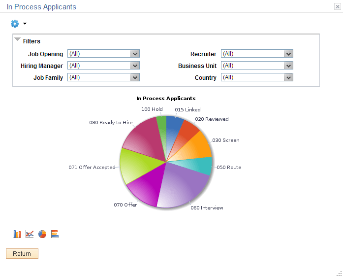

This example illustrates the In Process Applicants pivot grid.
The In Process Applicants pivot grid displays counts of applicants in various dispositions. The chart shows all in-use dispositions except Draft and Reject.

Enter the From Date and To Date to define the date range for the pivot grid. Only applications that were created within the specified date range are included in the chart.
Enter Y (yes) or N (no) in the Include Applied Status field to determine whether the chart includes applications in the default disposition that is assigned when the application is first submitted. The delivered default disposition is Applied.
Initially, the chart includes data for jobs that were opened within the past year, and it does not include applications in the default (Applied) disposition.
