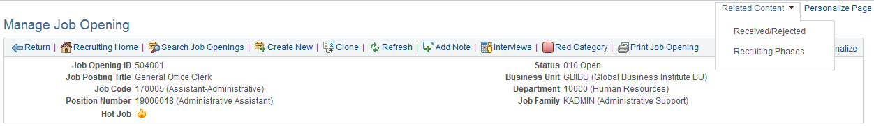

Understanding Related Content for Job Openings
Charts to help you understand the recruiting activity for a job opening are available as related content from the Manage Job Opening Page.
Access the charts using the Related Content link that appears at the top of the Manage Job Opening page.
This example illustrates the Related Content menu on the Manage Job Opening page.
When you select a specific chart from the Related Content menu, the chart appears in the bottom half of a split screen, while top half of the split screen continues to display the job opening.
The related content portion of the split screen displays tabs for each chart so that you can switch charts without returning to the Related Content menu.

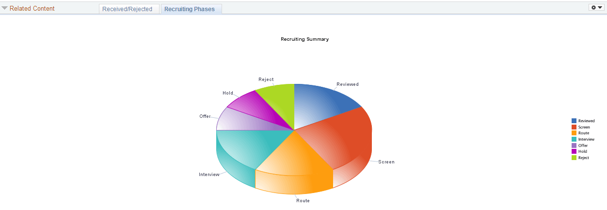

Recruiting Phases Chart
Use the Recruiting Phases page (HRS_JO_CHART2) to view a pie chart showing the number of job opening applicants in each recruiting phase.
Navigation:
On the Manage Job Openings page, select the Related Content link, then select Recruiting Phases from the related content menu.
This example illustrates the Recruiting Phases chart.
Recruiting Phases chart (job opening related content)
This is a standard pie chart showing the distribution of applicants across recruiting phases. To see the exact number of applicants in a particular phase, place the cursor over the pie segment to show the mouseover text.
