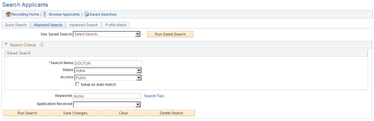

Search Applicant Page: Editing Saved Search Mode
Use the Search Applicant page to edit a saved search.
Navigation:
Fields for editing a saved search appear when you access the Search Applicant page any of the following ways:
This example illustrates the additional elements that appear on the Search Applicants page: Keyword tab when you edit a saved keyword search. The same additional elements appear on the Advanced Search tab when you edit an advanced search.
Search Applicants page: Keyword tab in edit mode
Saved Search
This group box shows the same fields that appear on the Save Search Page . You can edit any of this information.

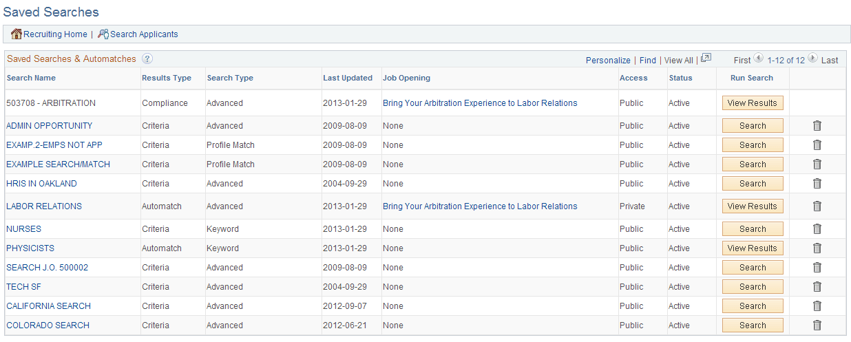

Saved Searches Page
Use the Saved Searches page (HRS_REC_SEARCHES) to review saved searches, and either run them or review the results, depending whether the criteria or results were saved.
Navigation:
Recruiting, and then Saved Searches
This example illustrates the Saved Searches page.
Saved Searches page
Toolbar
Field or Control Description
Recruiting Home
Click to access the Recruiting Home Page.
Search Applicants
Click to access the Search Applicants Page.
Saved Searches and Automatches
This grid lists public saved searches as well as private saved searches that you created. You cannot see other users' private saves searches.
Search Name
Displays the name of the saved search. If you are the owner or administrator of a saved criteria search or automatch search (other than a Profile Match search), the name is a link that you click to access the Search Applicant page in a mode where you can edit the search criteria and save your changes.
Note: When you access the Search Applicants page from the Saved Searches page, the fields for defining the saved search appear on the Search Applicants page. Use these fields, and the additional Save Changes and Delete Search buttons, to modify or delete your saved search.
Results Type
Displays Criteria, Automatch, or Compliance to indicate the type of saved search.
Search Type
Displays Keyword Advanced, or Profile Match to indicate which mode the Search Applicants page was in when you entered the search criteria or performed the search.
Last Updated
Displays the date that the search was most recently saved.
Job Opening
For searches that are associated with a specific job opening, this field identifies the job opening and provides a link to the Job Opening page.
For other searches, this field displays None.
Access
Displays Public or Private to indicate who has access to the search. The only private searches that appear in the grid are the ones that the current user created.
Status
Displays Active or Inactive. To change a search’s status, click the search name to edit it.
Run Search
For criteria searches, a Search button appears. Click this button to run the search and view results on the Search Applicants page.
For automatch searches, a View Results button appears. Click this button to view the results from the last time the search was processed. If the search has not yet been processes, no results exist.
For compliance searches, a View Results button appears. Click this button to view the saved results.

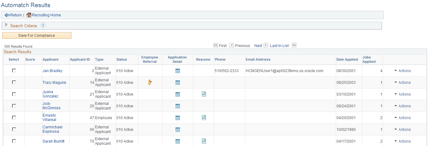

Automatch Results Page
Use the Automatch Results page (HRS_REC_SCHRSLTS) to view the results of an automatch saved search.
Navigation:
Click the View Results button for an automatch search on the Saved Search page.
This example illustrates the Automatch Results page.
Search Criteria
Expand this section to view the criteria for the search.
Save for Compliance
Click this button to save the results for auditing and statutory reporting purposes.
Search Results
Displays the results from the last time that the Run Automatch Search (HRS_AM) Application Engine process ran this search. Each time this process runs, the new search results replace any previous search results.

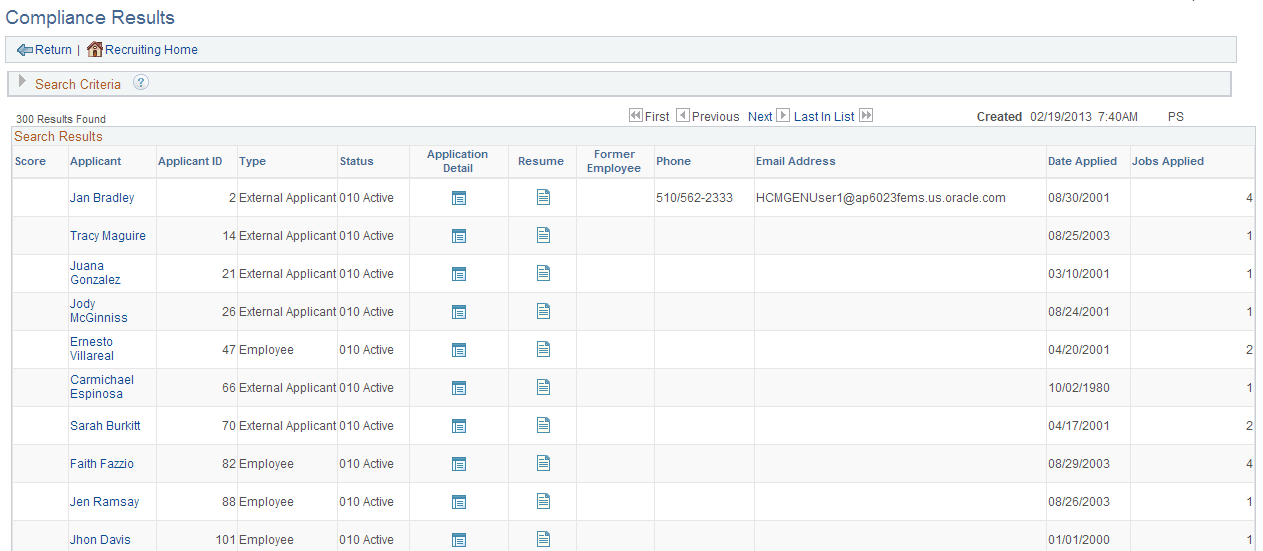

Compliance Results Page
Use the Compliant Results page (HRS_REC_SCHRSLTS) to view search results that were saved for Compliance.
Navigation:
Click the View Results button for a compliance search on the Saved Search page.
This example illustrates the Compliance Results page.
Search Criteria
Created
Displays the date and time that the results were saved, and the user ID of the person who saved the results.
Search Results
Displays the saved search results.
