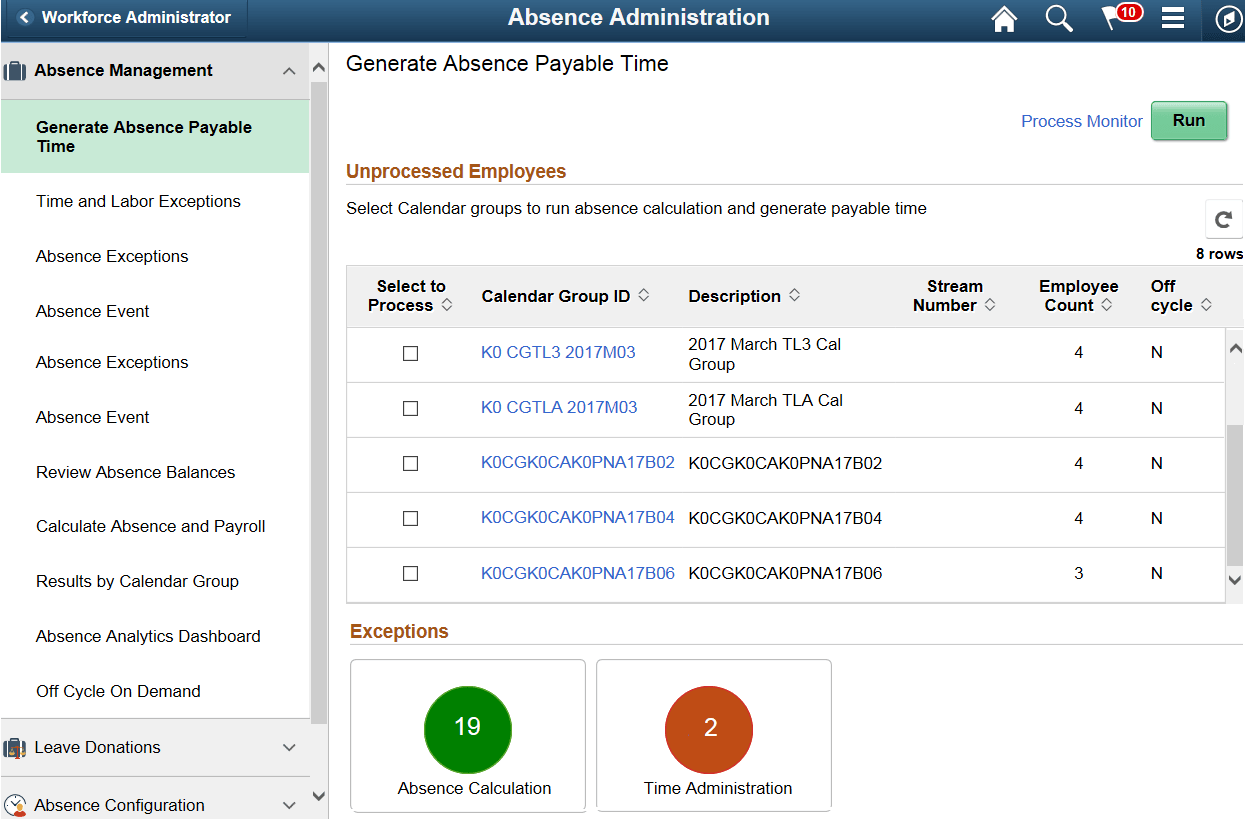

This example illustrates the Generate Absence Payable Time Page
The grid on this page displays all the calendar groups that has some unprocessed absences for employees. It also displays all unfinalized calendar groups that has employees for whom approved absence has not been processed.
The Refresh button displays the current count and you can use the refresh button to refresh the grid after a particular run. On refresh, the count of the exceptions and warnings displayed on the Absence Calculation and Time Administration tiles also gets updated.
When multiple Calendar Groups are selected to be processed using the Run button, a message will be displayed indicating that this process request was submitted. Also, PS JOB (TL_GENPT) would be triggered simultaneously (one for each calendar group) with absence calculation process being executed as part of it.
Note: If the Generate Absence Payable Time check box on the Configurations Page is deselected, this page doesn’t display any calendars in the grid. All buttons and links in this page will also be unavailable.
Field or Control Description
Select to Process
Select the calendar group that you want to process using the check box.

Employee Count
Displays the number of unprocessed employees (employees for whom approved absence has not been processed) associated with the calendar group. If process streams are enabled, this column displays the number of employees associated with the stream indicated in the Stream Number column.

Process Monitor
Click to access the Process Monitor, where you can view the progress of the Generate Absence Payable Time process.
Run
Click to run the Generate Absence Payable Time (TL_GENPT) PSJob, which processes absence calculation and generates payable time for the payees associated with the selected calendar groups.
  • If you click the Run button without selecting a calendar group, you will get an error message stating ’Please select at least one calendar group to be processed’.
  • If you select multiple calendar groups with different pay end dates that include the same pay group, you will get an error message stating ‘The selected Calendar Groups have common Paygroup. Calendar groups with same Paygroup needs to be processed one after the other’.
Note: If process streams are enabled, the system process absence calculation and generates payable time for payees in streams.
Absence Calculation
Displays the sum of errors and warnings for absence calculations. Click Absence Calculation to open the Absence Exceptions page. For more information on Absence Exceptions, see PeopleSoft Absence Management: Absence Exceptions Page.
Time Administration
Displays exceptions count for Time and Labor. Click Time Administration to open the Manage Exceptions page. For more information on Time and Labor exceptions, seeManage Exceptions Page.
