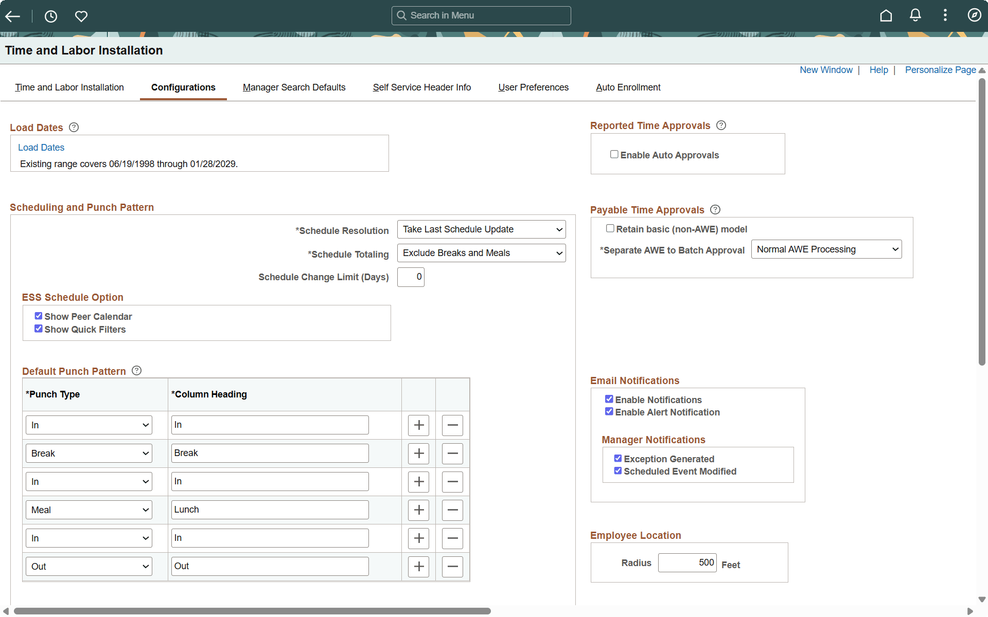

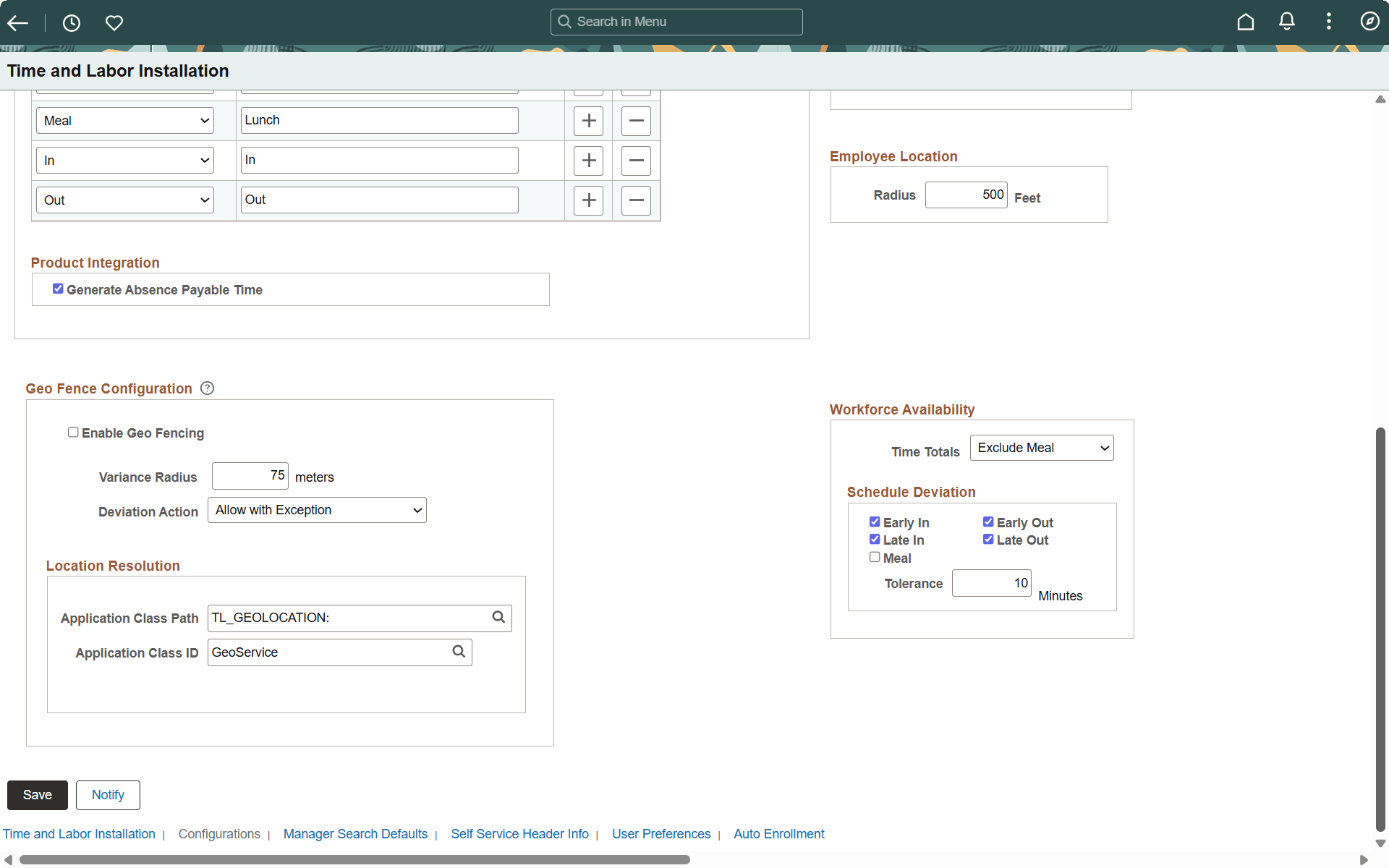

Configurations Page
TL_INSTL_PUNCH
Set up schedule total options, schedule resolution options, punch pattern defaults and Schedule Change Limits for your Time and Labor application.
The navigation to Load Dates for GAP and Absence Management Setup is HCM, Product Related, Global Payroll and Absence Management, System Settings, Installation Settings.
Dates Table Load Page
TL_DATE_LOAD
Load dates into your Time and Labor system when you implement the system and each time you approach the end of the load period.

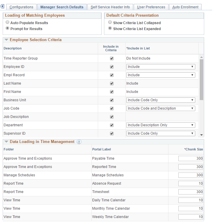

Manager Search Defaults Page
TL_INSTL_MSS_DFLT
Set up manager selection criteria fields and options that will be used for returning employee lists for all Time and Labor manager self-service pages.

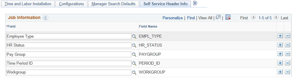

Self Service Header Info Page
TL_INST_SS_HDRFLD
Define the additional information shown on the Self Service page with the employee name and job title.

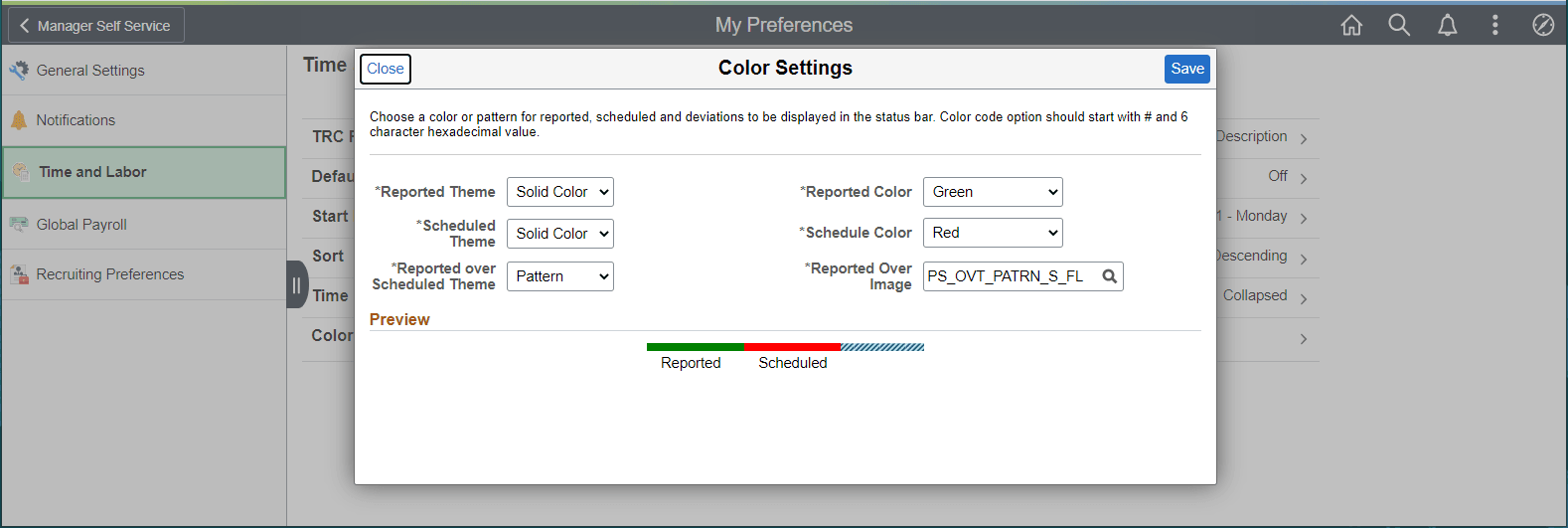

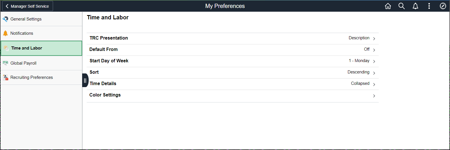

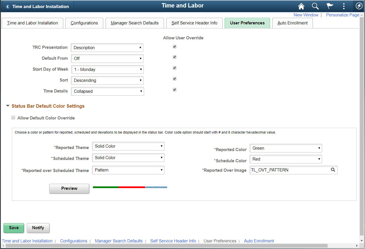

User Preferences Page
TL_INST_TR_PREF
Define default values for the user preferences set within the PeopleSoft Fluid User Interface Time page.

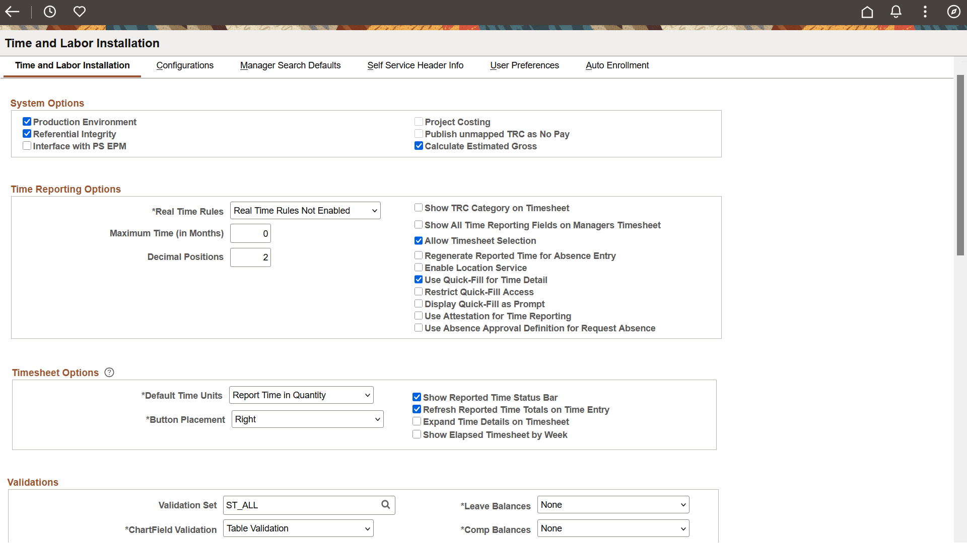

Time and Labor Installation Page
Use the Time and Labor Installation page (TL_INSTALLATION) to set up general system defaults and to activate specific features for your Time and Labor application.
Navigation:
Set Up HCM, and then Install, and then Product Specific, and then Time and Labor Installation , and then Time and Labor Installation
This example illustrates the fields and controls on the Time and Labor Installation page. You can find definitions for the fields and controls later on this page.
TL Installation page
Time and Labor Installation (2_3) Page
Time and Labor Installation (3_3) Page
System Options
Field or Control Description
Production Environment
Select to indicate that the system is no longer in a testing environment. Use this check box to test the production functionality with the ability to change task templates and rules, and to understand exactly how the system responds in production.
The following table describes how certain processes function when the Production Environment check box is selected or cleared.
Process What Happens When the Production Environment Check Box Is Cleared or Selected
Task Templates
Cleared: You can change your task template elements to required, optional, or not used. These changes are allowed, but if you have live data already reported to a template, the resulting tasks may be invalidated, and there will be no validation to catch these errors.
Selected: You can change the task template by adding optional task elements or changing required elements to optional.
System Date/TL Security
Cleared: You can select the system date so that it appears on the Row Security Permission List page. This option enables a testing environment in which various users access the same database and enter different system dates to test different time frames.
Selected: The System Date field does not appear on the Row Security Permission List page.
Rule Objects
Cleared: All rule objects can be changed.
Selected: No rule objects can be changed.
Project Costing
Select this field if you will interface Time and Labor with Project Costing.
Referential Integrity
Cleared: No referential integrity processing for changes to effective-dated tables. Normally, this involves reevaluating reported and payable time, and creating exceptions for all affected time.
Selected: Referential integrity processing occurs as necessary.
Note: During non-production times, the system doesn't need to perform referential integrity checks because setup tables will change often, and the reported time is not real.
The Referential Integrity Flag controls whether there are inserts in the RI_CNTRL_TBL, when a change occurs to an effective dated setup table. The rows in the RI_CNTRL_TBL are then read when the system runs the Time Administration process. This typically involves creation of exceptions for all reported time effected by the change. This flag has no dependency on the Production Environment Flag.
Publish unmapped TRC as No Pay
Two processes use this check box so set the payable time status to No Pay (NP):
  • The Time Administration process refers to this flag when generating payable time for TRCs or workgroups that do not require approval.
  • The payable time approval processes (online and batch) refer to this flag when setting the payable time status. If the TRC that is used to report time is not mapped to an earnings code in the pay system, or if a time reporter is not set up for payroll on the Maintain Time Reporter Data page, the payable time status is set to No Pay.
If selected, this option creates Time and Labor No Pay Actuals rows in PS Projects.
Interface with PS/EPM
Select this field if you will interface Time and Labor with PeopleSoft Performance Management.
Calculate Estimated Gross
Clear for the system to not calculate estimated gross for all instances of time. This check box is selected by default. If you clear this check box, all future instances of time lack the estimated gross calculated during the Time Administration process. If there is payable time with estimated gross attached that you don't want, rerun the Time Administration process.
You can view the estimated gross by TRC for the time reporter by accessing the Payable Time pages. After a payroll is run, the system distributes the actual gross back to Time and Labor during the Labor Distribution process.
For example, you may want to bill estimated costs before the pay cycle. Use the estimated grosses to book the estimated costs ahead of time. When the actual dollars from the Labor Distribution process are posted, you can reverse the estimates and replace them with the actual amounts.
Time Reporting Options
Real Time Rules
Select an option to enable the online rules feature. This feature enables you to define online rules and launch an online process (from the Timesheet page) that immediately applies the rules to a time reporter's time. The options are:
  • Real Time Rules Not Enabled.
  • Run on Submit button. This option launches the process automatically when the Submit button is clicked on the Timesheet page.
  • Run via separate button. This adds the Apply Rules button to the Timesheet page. The user clicks the Apply Rules button to execute the Real Time Rules process.
Note: On the Timesheet page, if the user clicks the Apply Rules button, the user is taken to the Payable Time Details page. If there is no payable time created, and if there are exceptions, the user is taken to the Exceptions page.
 Maximum Time (in Months)
The system uses the value in this field as an upper limit when comparing the starting date specified on a Timesheet and the Earliest Change Date (ECD) for a time reporter. If the time period that the user wants to process is too long, meaning that the ECD is older than the value specified in this field, the system disables the Apply Rules button This can prevent unacceptable system response times when retroactive changes force the system to recalculate a large volume of Payable Time. To change this situation, the user can change the date on the Timesheet to a prior period and bring the ECD forward incrementally, or the time administrator can run the Time Administration process to move the ECD forward.
Show TRC Category on Timesheet
Select to display TRC categories in the Reported Hours Summary on the Timesheet page
Show all Time Reporting Fields on MGR Timesheet
Select to determine if all the time reporting fields appear on the Manager Timesheet, or only the fields that are selected on the Time Reporter's time reporting template.
Allow Timesheet Selection
Select to enable the user to transfer between the Elapsed and Punch Timesheets.
Update Reported Hours on Entry
Select to enable the real time update of reported hours on entry, in time entry pages.
Decimal Positions
Display the entered number of decimals for the Timesheet pages.
Used in the PeopleSoft Fluid User Interface Report Time screen to display the entered number of decimals for the Timesheet, Report Time and Report Leave pages.
Regenerate Reported Time for Absence Entry
If selected, when absence entries are reported or approved, the system regenerates reported time based on the employee's schedule (Reported Time source is SCH) so that the sum of reported absence and work time from other sources equals the number of scheduled hours for a day.
This check box functions in conjunction with the Create Partial Work Hours check box on the Workgroup Defaults page in Time and Labor. If this check box is selected and the Create Partial Work Hours check box is cleared, the system uses full day absence logic when generating time. If the Create Partial Work Hours check box is selected and this check box is cleared, there is no impact on reported time.
Select to specifically mention only Absence Management Time Reporting Codes. Time Reporting Codes designated as Leave Taken are not considered as Absence type codes and payable time is not created to complete the schedule. For Example, If TRC defined as Leave Taken is reported as 3 hours on a day the employee is scheduled for 8 hours; only 3 hours would be paid. In order to make the employee whole, you need to also report 5 hours of regular time along with the 3 hours of Leave.
Note: The default setting for this option is cleared. The workgroup check box setting of Create Partial Work Hours for Partial Absence is also specific only to absence management TRC's.
Enable Location Services
Check box to capture employee location when time is reported, provided the employee accepts the use of location services. This is only for Fluid User Interface and not applicable for timesheet.
Use Quick-Fill for Time Detail
Select to use the Quick fill facility.
Note: This option is available only when the quick fill is allowed at both the installation and workgroup level. By default, both Show Reported Time Status Bar and Use Quick-Fill for Time Detail are unchecked.
Restrict Quick-Fill Access
Select this checkbox to ensure that only administrators have the ability to set up quickfills for employees, thereby restricting employees from configuring quickfills. By default, this checkbox is not selected.
Selecting this checkbox will hide the Managed by Me tab on the Setup Quick Fills page for the time reporter. For details on setup quick-fills, see Setup Quick-Fill Page.
Display Quick-Fill as Prompt
When selected, the current Quick Fill drop-down will appear as a prompt.
Note: If you don’t select it, the drop-down will still turn into a prompt automatically if the total number of Quick Fills for the time reporter goes over 100. This prompt and drop-down will include all Quick Fills, whether they are created by employees or set up by administrators.
Use Attestation for Time Reporting
Enable attestation for time reporter.
Note: By default, this option will be unchecked. Select this option if you want the users to attest their time. This option will work in conjunction with the acknowledgement options set up under employees Workgroup Timesheet Controls, Employee Signature Acknowledgement ID. For more details, refer Enterprise Components: Setting Up the Acknowledgement Framework.
Use Absence Approval Definition for Request Absence
Enables a newly added absence route for approval as per the approval definition ID set for that absence in Absence Management.
See Setting Up Workgroups.
The Learning Management field on the Products page (Set Up HCM, Install, Installation Table), needs to be selected, in order for the user to view LM training data icons in Manage Schedules, Monthly Schedules and Calendars.

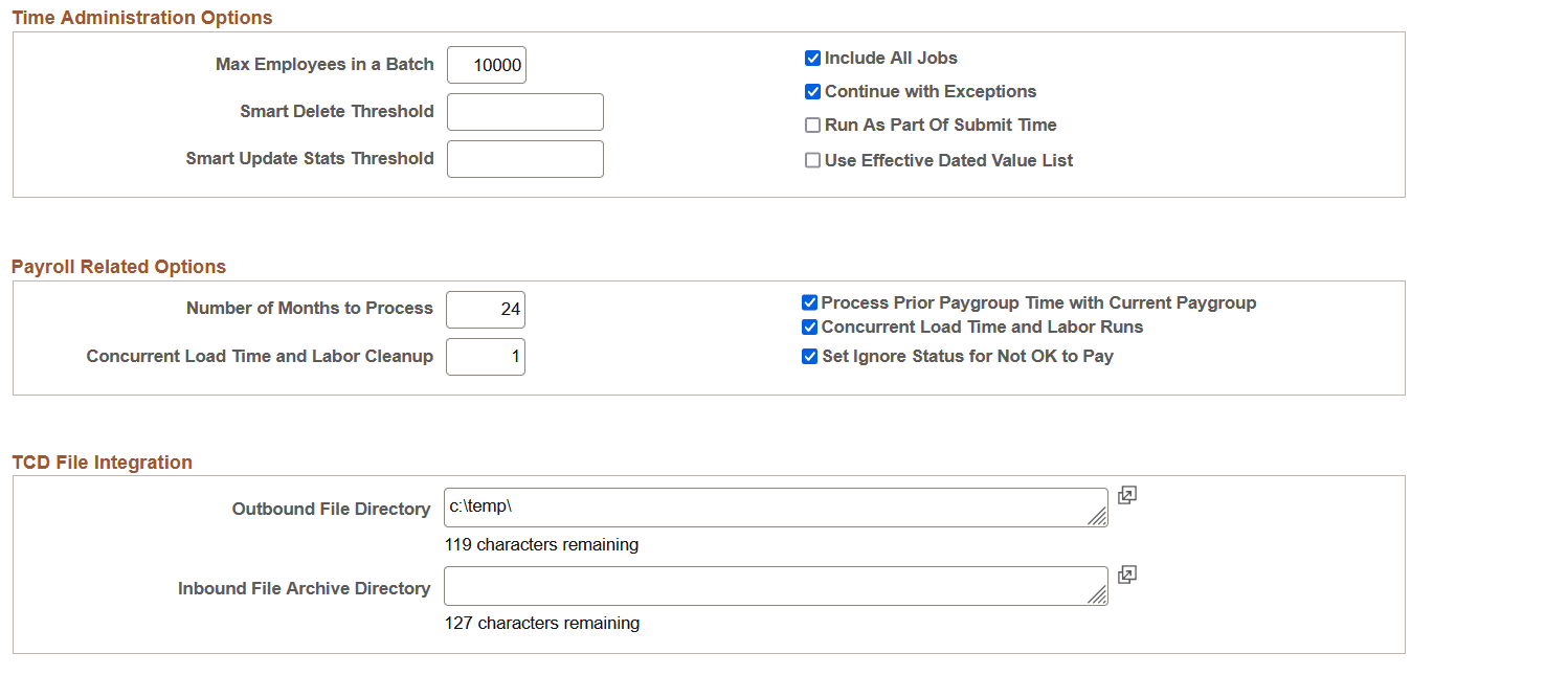

Time Administration Options
Max Employees in a Batch (maximum employees in rules run)
Enter the number of employees for the system to process at a time when running rules (Time Administration process). The number controls system performance during batch processing. The default value is 100.
Note: Set this value as high as necessary, as long as your database is capable of handling a higher volume per batch. High values create fewer batches during the Time Administration process and system performance improves due to a reduction in TL_TA000410 loops during the Time Administration process.
See Understanding the Time Administration Process Flow.
Continue with Exceptions
Select to enable the system to continue to run the process when exceptions are encountered. The system generates payable time for the employee, except for the days with high severity exceptions. This means that for a high severity exception, the system generates the exception and does not generate payable time for the impacted reported time. For any other exceptions, the system generates the exception and continues to generate payable time for the impacted reported time.
Clear the field to indicate that when the system encounters any exception, no payable time is generated for the impacted reported time.
Include All Jobs
Select to process all employee record (Empl_RCD) numbers for the Employee ID, if the TA status and ECD are ready for processing. This selection overrides any Employee Record numbers specified on the Request Time Administration run control page. Employee Record numbers in different workgroups are processed in different batches.
Clear this field to process the Employee Record numbers specified on the Request Time Administration page or all of the Employee Record numbers in the same workgroup as the Employee Record numbers listed on the Request Time Administration page. Employee Record numbers in the same workgroup are processed in the same batch.
Smart Delete Threshold
Use this impacted rows to determine whether to use truncate or delete. The default value is 3000.
Smart Update Stats Threshold
Use this impacted rows to determine whether to use Update stats or not. The default value is 3000.
Note: The Smart Delete Threshold and Smart Update Stats Threshold should be set to 1000 for the customised template based rules to work. Smart batches of employees benefit by decreased runtime in TL rules processing.
Run As Part Of Submit Time
Check this option to determine whether the Time Admin needs to run when Time is submitted through the Timesheet.
Use Effective Dated Value List
Select to add Effective Dating to value lists for use in rule templates and keep the original tables in place for all other value list functions.

Payroll Related Options
The setting in this group box affects integration between Time and Labor and Payroll for North America.
See Configuring Time and Labor for Use with Payroll for North America.
Number of Months to Process
Enter the maximum number of months that the Load Time and Labor process will look back for prior adjustments. Enter the number of prior months of data to process during the loading. The number entered must not be negative, or else a error message would be generated. For example, if current date is 6/30/03 and the user entered 3 to the field, it will go back to 3/30/2003 on the Frozen Date field to load payable time to Payroll.
Process Prior Paygroup Time with Current Paygroup
This check box controls how Payable Time is loaded into paysheets when a Prior Period Adjustments (PPA) exists and the employee had a pay group change.
For example, an employee transferred from pay group 1 to pay group 2 on September 1. When payroll is run on August 31, all Payable Time is loaded up to August 31 and the employee has one check in pay group 1. When payroll is run on September 30, all Payable Time in September is loaded and the employee has one check in pay group 2. Then, a prior period adjustment (PPA) occurs for the August pay period:
  • If this check box is selected, then the PPA is loaded and paid in the September check. In this case the money is paid from the correct pay group and expenses are associated with the proper account.
  • If this check box is not selected, then the PPA is not loaded. The payroll clerk must create paysheets for the employee in pay group 1 to load the PPA and have it paid.
Concurrent Load Time and Labor Runs
Select this check box if you run the Time and Labor Load processes concurrently (that is, multiple Load processes are run simultaneously). Clear this check box if the Time and Labor Load process is never run concurrently.
Concurrent Load Time and Labor Cleanup
Set this field using the following criteria:
  • If you do not use concurrent processing, set this value to twice the largest number of paygroups processed in a Time and Labor load process. For example, if the largest number of paygroups your organization processes is nine, set this value to 18.
  • If you use concurrent processing, set this value to the number of concurrent processes multiplied by twice the largest number of paygroups in a Time and Labor load process. For example, for nine paygroups and 11 concurrent processes, set this value to 198.
Set Ignore Status for Not OK to Pay
This check box defines the payable time status code and reason codes that Time and Labor sets during the Distribution Dilution process when a no pay other earning or pay earning are processed:
  • If this check box is selected, then Time and Labor sets the payable time status code to Ignore (IG) and the reason code to Not OK to Pay (NOP) for any payable time for which the payline has the OK to Pay check box cleared.
  • If this check box is not selected, then Time and Labor sets the payable time status code to Rejected by Payroll (RP) and the reason code to Not Processed in Payroll (PNP).
The default setting for this option is selected.
The Payable Time rows, that are in ignore (IG) status, generate offsets in all cases. When the original row was processed under North American Payroll, the negative row will be generated directly by Time Administration in Ignore status. This addresses any over or underpayment issues and thus properly create offsets as usual for a Global Payroll user.
See Payable Time Status and Reason Codes.
TCD File Integration
Outbound File Directory
Enter the directory path for the TCD outbound flat files created by Integration Broker. These files are sent to your time collection device. Your path must end with a backslash (\). This directory is for flat file TCD integration only.
Inbound File Archive Directory
Enter the path for the TCD inbound flat file data to be archived after the inbound file process reads the data. Your path must end with a backslash (\) for successful creation of the flat file. This directory is for flat file TCD integration only.
Max Punches in a Batch
Enter the maximum size of each batch of incoming messages from a TCD server for use with the PUNCHED_TIME_ADD service operation. The value in this field only affects the batch size of messages when you activate the PUNCH_ADD_DAEMON service operation handler. This field is only available after you have activated the PUNCH_ADD_DAEMON handler.
See Incoming Service Operations from the TCD Server to the PeopleSoft Server.

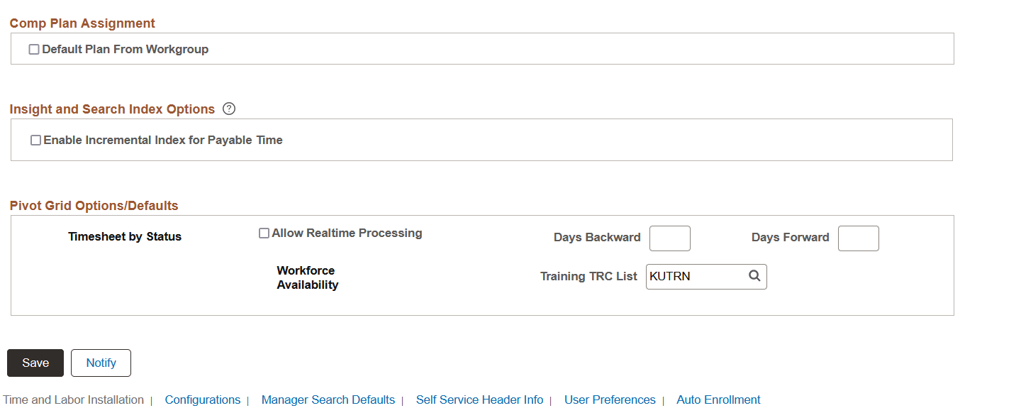

Comp Plan Assignment
Default Plan From Workgroup
Select for the system to automatically populate the Comp Plan Enrollment page with the compensatory plan associated with the workgroup of a time reporter. If you select this check box, you can't:
  • Override the compensatory plan assignment on the Comp Plan Enrollment page.
  • Delete or inactivate the compensatory plan on the Comp Plan Enrollment page.
The compensatory plan is controlled by the association of the workgroup to the time reporter.
You can alter the compensatory plan association for the time reporter in two ways:
  • Change the workgroup associated with the time reporter on the Maintain Time Reporter data page.
  • Change the compensatory plan associated with the time reporter's workgroup.
The system will automatically update the compensatory plan association accordingly.
If you don't select this check box, you can enter any number of rows on the Comp Plan Enrollment page and inactivate any of the compensatory plans. You can't delete a row on the Maintain Time Reporter data page if it inactivates an association to a compensatory plan. Inactivate the association of the compensatory plan to the time reporter on the Comp Plan Enrollment page; then delete the row on the Maintain Time Reporter Data page.
Note: You can only change this option once.
The system doesn't enable changing this value back and forth because:
  • When you clear this field, the system deletes compensatory plan rows on the Comp Plan Enrollment page.
  • The system derives the workgroup's compensatory plan from the association defined during the Create Time Reporter Data setup.
  • If you change this value again, any compensatory plan balances could be invalidated due to the changes in the compensatory plan associations and the TRCs assigned to the compensatory plan.
See the product documentation for PeopleTools: PeopleSoft Application Designer Developer's Guide and
Insight and Search Index Options
Enable Incremental Index for Payable Time
Select this option to enable the Incremental Search for Payable Time.
Note: This option requires database triggers, therefore ensure database triggers are created. Contact your database administrator to implement triggers on the database.
Configurations Page
Use the Configurations page (TL_INSTL_PUNCH) to set up schedule total options, schedule resolution options, and punch pattern defaults for your Time and Labor application.
Navigation:
Set Up HCM, and then Install, and then Product Specific, and then Time and Labor Installation, and then Configurations
This example illustrates the fields and controls on the Configurations page. You can find definitions for the fields and controls later on this page.
TL Configurations_1
TL Configurations_2
Important:
This page (TL_INSTL_PUNCH) is the same as the PeopleSoft Global Payroll: Schedule Settings Page for Global Payroll and Absence Management. The settings that you define on this page are shared between Time and Labor, Global Payroll, and Absence Management.

Scheduling and Punch Pattern
WARNING:
Be careful to create a punch pattern that makes sense, without the same punch type in a row.
Schedule Resolution Options
This field specifies how to resolve schedule changes. If the Take Last Schedule Update field value is selected, whether the last schedule update is from a workforce scheduling third-party system, or an online override, the system will take the last update to resolve the employee's schedule. If the Take Online Override field value is selected, the system will look for an online schedule override for resolving the schedule for the day, if an override exists. The system will not look for any changes from a third-party workforce scheduling system.
Schedule Totaling
Use this option to configure whether meal and/or break times are included in Scheduled Hours totals on schedule definitions, and shift definition and Manage Schedules. Valid values are Exclude Meals and Breaks, Include Breaks, Include Breaks and Meals, Include Meals. The default is Exclude Meals and Breaks.
Schedule Change Limit (Days)
Enter days in number for setting the schedule change limit. The schedule change limit value is set as three digits number.
Note: If the default installation setting is set 0, then the schedule change is not applicable. This means that the manager should be able to make retroactive schedule changes without any limitation on Manage Schedule and Assign schedule pages. Managers will not be able to make schedule changes beyond the limit set at the installation level. This validation is only for Managers. For Administrators, there is no restriction in changing the schedule anytime in the past.
Default Punch Pattern
For the Time Reporting and Scheduling pages, set up the punch pattern you require to be defaulted. A total of ten punches can be entered. A label can also be specified for each punch type row. The default punch pattern set here also defaults to the Time Reporting Template page. On the Time Reporting Template page, you can override the Installation Table settings and establish a different punch pattern for specific groups of punch time reporters, rather than for all punch time reporters.
Note: Be sure not to create the same punch type successively, check the order of your punch types.
Product Integration
Generate Absence Payable Time
Select the check box to enable administrators to generate absence payable time directly to Time and Labor. If you deselect this check box, the Generate Absence Payable Time Page doesn’t display any absence management calendars and it’s related buttons/links.
Geo Fence Configuration
Enable Geo Fencing
Select this option to enable the Geo Fencing feature. Geo Fencing is controlled by the Enable Location Service setting under the Time Reporting Options section of the Time and Labor Installation page. This option must be turned on in order to use Geo Fencing.
Variance Radius
Enter the allowed variance distance, in meters, from the configured location coordinates. This value determines how far a time reporter can be from the expected location without triggering the Deviation Action. If no value is entered, the variance is considered 0 meters.
Deviation Action
Select how the system should respond when a time reporter attempts to report time outside the allowed radius.
Available options are:
  • Allow With Exception (default) – Time can be reported, but an exception will be raised.
  • Do Not Allow – Time reporting will be blocked if the time reporter is outside the allowed radius.
Application Class Path
Select the application package responsible for converting a human-readable address into latitude and longitude coordinates. This is required when setting up Geo Fence Overrides, as the Get Coordinates function depends on it. These fields should always have a valid value for Geo Fencing to function correctly.
Note: By default, Oracle provides an application class that uses Oracle Maps to convert coordinates. This does not require a separate license.
Application Class ID
For details on geo fences, see Setting Up Geo Fencing for Time Entry.

Employee Location
When employees report time and have accepted the use of location services in the device which they use, and your organization has licensed and enabled Oracle Maps Service for PeopleSoft on the Installation Table - Application Fundamentals: Third Party/System Page, their location displays on a map on the Reporting Location page. For situations where a single employee is reporting time at the same location a few feet apart, the installation setting groups the reported time into a single marker on the map.
Radius
Specify a radius in feet where multiple time reports in that radius are grouped into a single marker. The default setting will be 500 feet. With these settings, any reported time or elapsed time reported within 500 feet are considered as the same location.
The map display functionality shown in the HCM features requires a separate license to Oracle Maps Cloud Service for PeopleSoft.  For details see the Licensing Information User Manual (LIUM).
Workforce Availability
Time Totals
There are two possible values for Time Totals:
Exclude Meal: This is the default value for this field. When this value is selected, Meal duration is excluded while calculating the Total Scheduled/Reported hours for an employee displayed in the right panel
Include Meal: When this value is selected, Meal duration is included while calculating the Total Scheduled/Reported hours for an employee
Schedule Deviation
Select check boxes for Schedule Deviation ranging from Early In, Early Out, Meal, Late In and Late Out.
  • Early In: Select to flag Early In as schedule deviation.
  • Early Out: Select to flag Early Out as schedule deviation.
  • Meal: Select to flag Meal as schedule deviation.
  • Late In: Select to flag Late In as schedule deviation.
  • Late Out: Select to flag Late Out as schedule deviation.
  • Tolerance: The amount of time in minutes which a worker may clock in/clock out either early or late which is not considered as schedule deviation.
Use the Manager Search Defaults page (TL_INSTL_MSS_DFLT) to set up manager selection criteria fields and options that will be used for returning employee lists for all Time and Labor manager self-service pages.
Navigation:
Set Up HCM, and then Install, and then Product Specific, and then Time and Labor Installation, and then Manager Search Defaults
This example illustrates the fields and controls on the Manager Search Defaults page. You can find definitions for the fields and controls later on this page
This page is used by managers and time administrators to set defaults that display on the Manager Search Options – Select Default Criteria and Options page. The Manager Search Options page is used for the various manager functions, to provide a consistent interface in which managers and administrators can easily identify, select and navigate through the pool of employees in whom they are interested.
You can establish preferred employee criteria and default values by configuring options on the Manager Search Defaults page. Employee lists can be pre-populated with a subset of a managers overall employee pool, criteria can be changed and data refreshed to expand or contract employee lists. When the employee pool is identified on pages that use the Manager Search page, the list persists throughout the application for easy navigation.
Loading of Matching Employees
AutoPopulate Results
Auto populate the employee list when entering the page.
Prompt for Results
Do not automatically populate the employee list, allowing the manager or administrator to review or change criteria values. A button is then selected and the employee list displayed.
Default Criteria Presentation
Show Criteria List Collapsed
Collapse the Manager Search Criteria group box when entering the Manager Search Options page.
Show Criteria List Expanded
Expand the Manager Search Criteria group box when entering the Manager Search Options page.
Employee Selection Criteria
Use the fields in this region to choose the fields that are displayed in the Search Criteria group box when entering the Manager Search Options page.
Include in Criteria
Select to include this field in the Manager Selection Criteria. When the Manager Selection Criteria is displayed on the Manager Search Options page, this field can be used to filter employee lists.
Include in List
Include this field in the employee list that is returned on the Manager Search Options page.
You can choose Do Not Include to prevent the display of the specified field in the employee list. For fields that display as a code and have a description on their definition table, you can configure the list display using the following values: Include Code Only, Include Code and Description, or Include Description Only.
Data Loading in Time Management
Enter the chunk size that you would like the Employee search to load. The system uses this size to determine initial row load and subsequent chunk rows.
Use the Self Service Header Info page (TL_INST_SS_HDRFLD) to define the additional information shown on the Self Service page with the employee name and job title.
Navigation:
Set Up HCM, and then Install, and then Product Specific, and then Time and Labor Installation, and then Self Service Header Info
This example illustrates the fields and controls on the Self Service Header Info page. You can find definitions for the fields and controls later on this page
Use this list to define additional information you want to display in the Self Service page headers with the employee’s name and job title. The information is visible on the Self Service page as a pop-up window when the user moves his or her mouse over the employee’s job title.
Use the User Preferences page (TL_INST_TR_PREF) to define default values for the user preferences set within the PeopleSoft Fluid User Interface Time page.
Navigation:
Set Up HCM, and then Install, and then Product Specific, and then Time and Labor Installation, and then User Preferences
This example illustrates the fields and controls on the User Preferences page. You can find definitions for the fields and controls later on this page.
Time and Labor Installation_User Preferences
The administrator uses this page to define default user preferences for the PeopleSoft Fluid User Interface Time pages. When granted permission, users can override these options.
TRC Presentation
Select the default option on how TRCs should display on the Select Employee Pageand the Weekly Time Entry pagein the PeopleSoft Fluid User Interface. Options are:
  • CODE-Description
  • Description-CODE
  • Description(the default setting). This configuration option determines in what format the Time Reporting Code will be displayed on the Report Time, Report Leave and Weekly Time pages.
Default From
Select the default option on how to copy elapsed time entry. The options are:
  • Off
  • Prior Period: Enables the employee to copy the time from prior time.
  • Schedule Information: Enables the employee to copy the schedule from an existing schedule.
  • Task Values: Enables the employee to copy the task value which is already set.
Start Day of the Week
Select the default option on how to display a snapshot of the week by indicating the first day of a work week.
Sort
Select the default option on how to display punch time reported entries. Options include:
  • Descending: The last entry at the top.
  • Ascending: The last entry at the bottom.
Time Details
Select the display option that should be provided by default to the user when viewing the Report Time Select Employee Filters pagein fluid. Options are:
  • Collapsed: When selected, the Time Details group box will be collapsed upon accessing the page.
  • Expanded: When selected, the Time Details group box will be expanded upon accessing the page.
Status Bar Default Color Settings
Allow Default Color Override
Select this option to override the colors specified here. Users will use the fluid User Preferences page to override the preference set here.
Reported Theme
Theme selection for reported theme is given with three options of Solid Color,Pattern, and color code.
Scheduled Theme
Theme selection for scheduled theme is given with three options of Solid Color,Pattern, and color code.
Reported over Scheduled Theme
Theme selection for Reported over Scheduled Theme is given with three options of Solid Color,Pattern, and color code.
Reported Color
Select a color or pattern to display for reported time.
Scheduled Color
Select a color or pattern to display for scheduled time.
If schedule is not configured then the status bar will not show up irrespective of whether reported time color settings are present.
My Preferences_Time and Labor page
Use the My Preferences for Time and Labor (TL_TR_PREF_FLU) to set the preference for different set ups of Time and Labor.
Navigation:
Select Actions List on the header bar.
Select Time and Labor from the left pane. Select Color Settings from the right pane.
This example illustrates the fields and controls of the My Preferences_Time and Labor page.
Color Settings
This example illustrates the fields and controls of the My preferences_Color Settings page.
My Preferences_Color Settings
This section will not be available for users if the "Allow Default Color Override" check-box is not selected in the TL Installation option.
