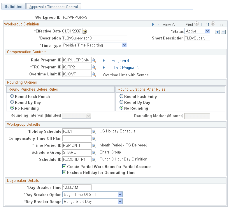

Workgroup - Definition Page
Use the Workgroup - Definition page (TL_WRKGRP_DEF) to define defaults, rounding options, and day breaker options for a workgroup.
Navigation:
Set Up HCM, and then Product Related, and then Time and Labor, and then Rules and Workgroups, and then Workgroup, and then Definition
This example illustrates the fields and controls on the Workgroup - Definition page. You can find definitions for the fields and controls later on this page.
Field or Control Description
Status
Valid values for Status are Active or Inactive. If you change the status of a workgroup to Inactive as of a particular effective date, the system will check if any time reporter is associated with the workgroup as of that effective date. If the association exists, the inactivation of the Workgroup will not be allowed.
The following fields on this page trigger Referential Integrity: Approve Payable Time, Rule Program ID, TRC Program ID, Holiday Schedule, Comp Plan, Schedule ID, Day Breaker, Day Breaker Options, Day Breaker Range, Rounding Options , Rounding Interval, and Rounding Marker. Additionally, if the Create Partial Work Hours for Partial Absence or the Exclude Holiday for Generating Timeoptions are changed for exception time reporting workgroups, Referential Integrity is triggered. For positive time reporting workgroups, modifying these options does not trigger Referential Integrity. For these fields, Referential Integrity ensures that if a time reporter's Earliest Change Date is less than the effective-dated change of the setup table, the Earliest Change Date will not be updated. If, however, the Earliest Change Date is null or greater than the effective date of the setup table change, the Earliest Change Date will be updated to the minimum effective date of Reported or Payable Time for the time reporter.

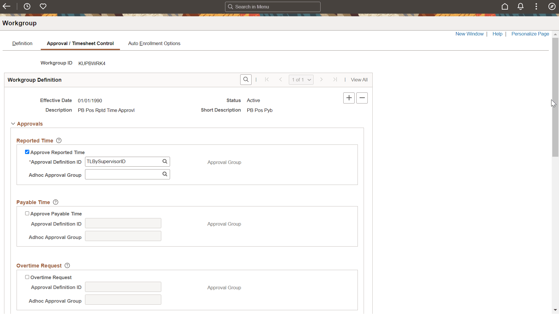

Workgroup - Approval/Timesheet Control Page
Use the Workgroup - Approval/Timesheet Control page (TL_WRKGRP_DEF) to define approval options and timesheet control for a workgroup. Name every workgroup and define its basic parameters, approvals and status.
Navigation:
Set Up HCM, and then Product Related, and then Time and Labor, and then Rules and Workgroups, and then Workgroup, and then Approval/Timesheet Control
This example illustrates the fields and controls on the Workgroup — Approval / Timesheet Control (1_2) Page.
Workgroup Approval page1
This example illustrates the fields and controls on the Workgroup - Approval (2_2) page. You can find definitions for the fields and controls later on this page.
Workgroup Approval page2
The Approve Payable Time field on this page triggers Referential Integrity.
Reported Time
The Approve Reported Time feature is an option for the approval of reported time. If selected, it requires that a manager approve the actual time reported versus payable time that has been processed by the Time Administration process. Select the Approve Reported Time field if a manager's approval is required for reported time. Then select an Approval Definition ID that has been created for Time and Labor approvals. The definition ID also identifies the appropriate approval definition. You can also select an ad hoc approval group ID that is set up for approvals. You can insert ad hoc approval group users into the approval process flow, along with the original approver.
Select this check box if a manager's approval is required for reported time. Leave the check box clear if you do not want a manager to approve reported time.
The Approve Reported Time feature is another option for approval of time. Selecting this field requires a manager to approve the actual time that was reported before the Time Administration process selects the time, processes it, and generates payable time. If time is not approved, then the reported time is not selected and run by the Time Administration process, and payable time is not generated.
Approval Process ID
Displays the Time and Labor process ID. The process ID identifies the approval transaction.
Select the approval definition created for Time and Labor approvals. The definition ID also identifies the appropriate approval definition.
Approval Group
Click to display the TL Approval Groups page. This link is available when the selected Approval Definition ID requires a Time and Labor approval group.
Note: The Approval Group link is available when you select an Approval Definition ID that starts with TLGroup.
Adhoc Approval Group
Select an adhoc approval group ID that is set up for approvals. You can insert adhoc approval group users into the approval process flow, along with the original approver.
Payable Time
Select the Approve Payable Time field if a manager's approval is required before the time reporters in this workgroup can be paid. When this field is selected and payable time is not approved by a manager, time reporters either will not be paid or their time will not be finalized. Then select an Approval Definition ID that has been created for Time and Labor approvals. The definition ID also identifies the appropriate approval definition. You can also select an ad hoc approval group ID that is set up for approvals. You can insert ad hoc approval group users into the approval process flow, along with the original approver.

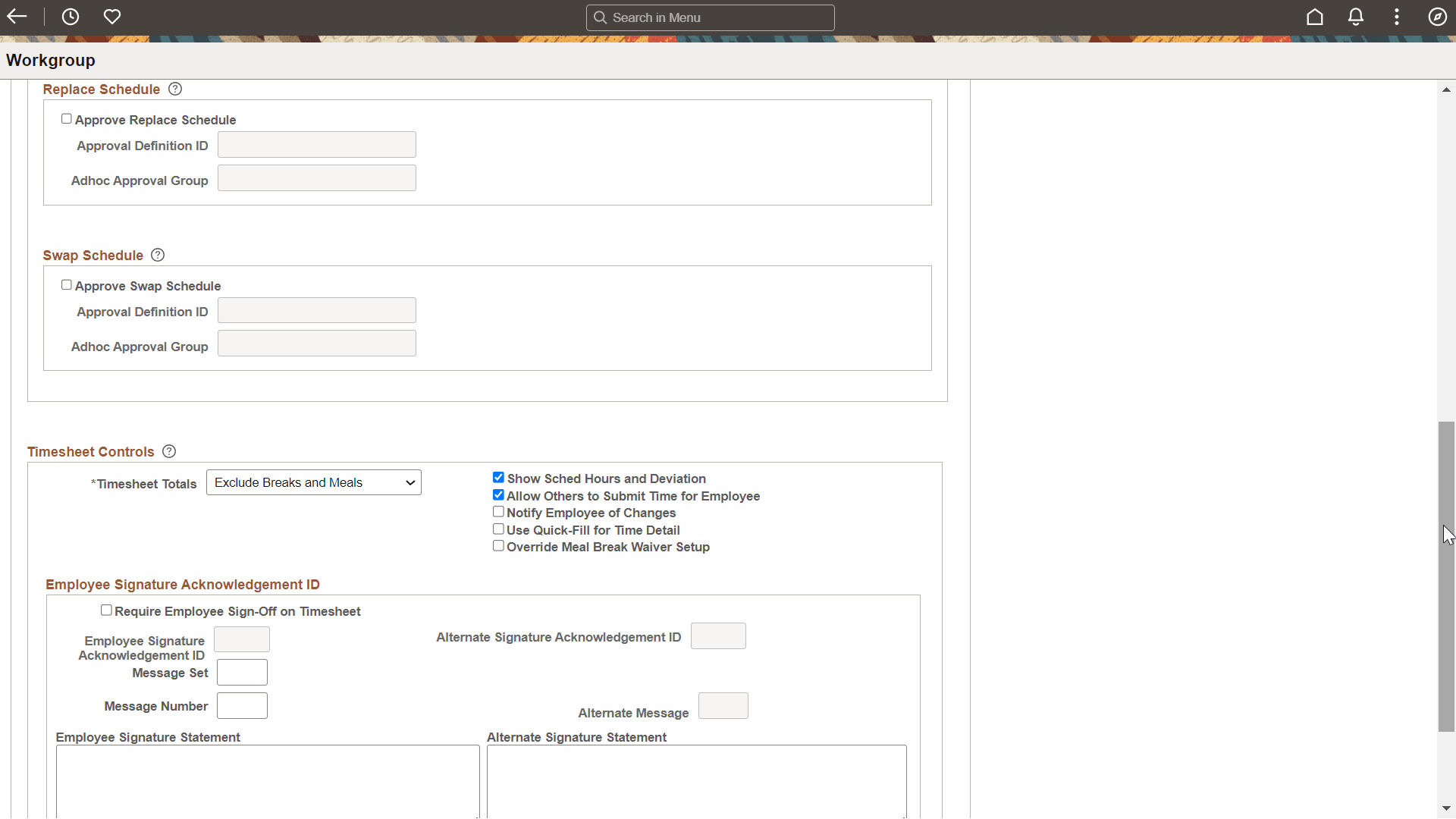

Swap Schedule
Select the Swap Schedule field if a manager's approval is required for employee to trade their schedule. Then select an Approval Definition ID that has been created for Time and Labor approvals. The definition ID also identifies the appropriate approval definition. You can also select an ad hoc approval group ID that is set up for approvals. You can insert ad hoc approval group users into the approval process flow, along with the original approver.
Swap Schedule
Select this check box if a manager's approval is required for employee swap schedule requests.
Approval Process ID
Displays the Time and Labor Process ID. The Process ID identifies the approval transaction.
Timesheet Controls
Select the Require Employee Sign-Off On Timesheet field to require an electronic signature on all submitted timesheets. When you select this field, you must also specify the text of the employee signature statement. Because this text is a message catalog entry, you must also specify the message set and message number.
Allow Others to Submit Time for Employee
Select this field to enable a user with row security access to the employee to edit the employee’s reported time on the Manager Self Service Timesheet.
If this field is selected, you must enter a value in Alternate Signature Employee ID field.
If this field is not selected, the Notify Employee of Changes field is not available.
Select if you want the employee to receive notices when a manager enters time on behalf of an employee.
This field is only available if the Allow Others to Submit Time for Employee field is selected.
Use Quick-Fill for Time Detail
Enable quick fill for time entries.
Override Meal Break Waiver Setup
Select this checkbox to override the meal break waiver definition specified in the Enter Time page for punch time reporter. For details on Enter Time page, see Enter Time Page for Punch Time Reporter.
This field's value is set to off by default. Employees in this workgroup will not be eligible for the meal waiver option when it is selected, or turned on.
Alternate Message and Alternate Signature Statement
Enter a message catalog ID to use as notification text. When you select this option, the contents of the Alternate Signature Statement display on the Manager Self Service Timesheet. The system also captures the User ID, the date, and the time.
Employee Signature Acknowledgement ID
If the Require Employee Sign-Off On Timesheet checkbox is deselected and only message numbers are provided, the acknowledgement message will be displayed only on the Enter Time pages. This message will not appear on the Report Time pages, including Report Time, Weekly Time Entry, and the One Click Punch tile.
Whenever a timesheet is submitted by someone on behalf of an employee, the fields Alternate Signature Acknowledgement ID and Alternate Message are mandatory.
Require Employee Sign-Off on Timesheet
Select this check box to enable a user with employee sign-off on Timesheet required while entering time using Enter Time page.
Note: If this field is selected, the fields Employee Signature Acknowledgement ID, Message Set, Message Number are mandatory.
Select the employee signature acknowledgement ID.
Note: If you do not want to set-up acknowledgement IDs and provided the installation check box is turned off, then you can provide the message catalogue and message set numbers and the acknowledgement message will appear on the fluid time sheet as in classic. This applies to Enter Time, Report Time and Weekly Time pages.
Message Set
Specify the message set in numbers.
Message Number
Specify the message number as required.
Employee Signature Statement
This populates an employee signature statement defined as per the fields.
Select if there is a need to choosing alternate signature acknowledgement ID. You must enter a value in the Alternate Message field if a value is selected in this field.
Note: If the Alternate Signature Acknowledgement ID checkbox is unchecked and only message numbers are provided, the acknowledgement message is displayed only on the Enter Time pages. It will not appear on the Report Time pages, which include Report Time, Weekly Time Entry, and the One Click punch tile.
Alternate Message
Alternated message characters in number.
This populates an alternate signature statement defined as per the fields.

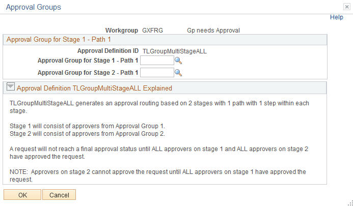

Approval Groups Page
The selected Approval Definition ID generates an approval routing based on the selected definition. For example, TLGroupMutlipleStageALL has two stages with one path, and one step within each stage. The request reaches final approval status when all of the Stage 1 approvers and then all Stage 2 approvers have approved the request. Based on the selected Approval Definition ID, the Approval Groups page displays the correct approval groups and instructions to help with the setup for approval usage.
Use the Approval Groups page (TL_WRKGRP_APPV) to define the TL Group ID and instructions to help with the setup for approval usage related to an Approval Definition ID that starts with TLGroup.
Navigation:
This example illustrates the fields and controls on the Approval Groups page. You can find definitions for the fields and controls later on this page.
Approval Group for Stage 1 - Path 1
Select the group of Stage 1 approvers.
Approval Group for Stage 2 - Path 1
Select the group of Stage 2 approvers.
Note: The Stage 2 approvers cannot approve a request until after the Stage 1 approvers have approved the request.
Defining the Reporting Time Type Group Box
On the Workgroup - Definition page access the Time Type group box.
If you change the Time Type for the workgroup from Positive to Exception, the effect is the ability to automatically create time for a given population by turning default schedule information into Payable Time.
If you change from Exception to Positive, time cannot be created for time reporters based on schedules -- all time needs to be positively reported.
When you make a change to the Time Type, the next time the system runs Time Administration, it will take into account the new time type.
Exception Time Reporting
Select this option if time reporters in this workgroup do not report their time on a daily basis, but are paid regularly. Examples of exception time reporting are time reporters who only report sick, vacation, or personal days. If no time is reported by an exception time reporter, the Time Administration process creates payable time based on the time reporter's schedule.
Note: No payable time is created from the schedule when Time Administration is run on days when zero hours are reported.
Positive Time Reporting
Select this option if you want the time reporters in this workgroup to report their time on a daily basis in order to be compensated. An example of positive time reporting is time reporters who report their time on an hourly basis.
You should enter positive or exception time reporting into your description of each workgroup. This enables you to determine the workgroup to which you want to assign the time reporters from the Create Time Reporter Data page, or the Maintain Time Reporter Data page. It is important that you categorize your employees correctly, because Time Administration creates Payable Time differently for exception and positive time reporters.
Defining Compensation Controls
On the Workgroup - Definition page, access the Compensation Controls group box.
Rule Program ID
Enter a Rule Program ID. To set up a rule program, you must use the Rule Program page. Although this field is not required when you create a workgroup, the Rule Program ID is needed in order for the time reporters in this group to have rules applied during Time Administration rules processing. If you try to save the page without entering a value in this field, you will get a warning message. The message will not prevent you from saving the page. You can save the page and come back to assign a Rule Program ID after you have your rule programs defined.
If a time reporter reports time with a valid TRC, Time Administration will create payable time even if their workgroup has no rule program: Time Administration will round, distribute tasks, and validate time without running rules. If the TRC is invalid, the system will generate an exception. For elapsed time reporters, exceptions will be created for all positively reported time that doesn't have a valid TRC. If you change the rule program attached to a workgroup, the Referential Integrity process will determine the Payable Time affected by this change, and trigger Time Administration to reprocess this time.
TRC Program ID
Select a TRC Program ID. TRC programs contain the list of TRCs that the system uses to create payable time for time reporters belonging to this workgroup. When workgroup members report time through the Elapsed Timesheet, only TRCs in this TRC program will appear in the TRC field.
If you try to change the TRC program attached to this workgroup, the Referential Integrity process will trigger Time Validation to check any reported or payable time that might be affected by this change. If there is any such time, the system creates exceptions and you will have to adjust the TRC to address the exceptions.
If time is reported through the TCD Interface or Rapid Entry process and contains invalid TRCs, the system will create exceptions for these instances of time. If the interface includes new TRCs that should be added, you can add the new TRCs to the appropriate TRC program. When you add the new TRCs, the system should delete the exceptions.
Overtime Limit ID
Select the Overtime Limit ID (if applicable), that applies to the members of the workgroup.

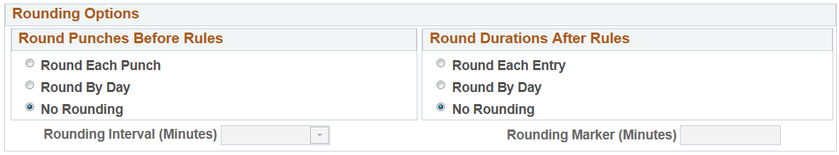

Setting Up Rounding Options
On the Workgroup - Definition page, access the Rounding Options group box.
This following illustrates the controls and definitions of Rounding Options.
There are three types of rounding in Time and Labor:
Round Each Punch
The system rounds all reported punches before applying rules to the time in Time Administration.
Even if this option is selected, the rules that require actual punch times continue to evaluate time as it was originally reported. For example, rules that track attendance continue to evaluate the originally reported time.
Round By Day
For daily rounding of punch time before Time and Labor rules are processed, but after the Day Breaker is applied. Using this option, punch time is not changed, but the duration associated with the first punch (IN) for the day is adjusted.
No Rounding
No rounding rules are applied.

Intervals and Markers
After you have selected a rounding option, define your option by specifying a Rounding Interval and a Rounding Marker.
Rounding Interval (Mins)
A rounding interval represents the number of minutes comprising a segment of an hour. For example, if you select 15 (minutes) in the Rounding Interval field, the following 4 intervals will be created for each hour:
Interval 1: x:00 to x:15
Interval 2: x:15 to x:30
Interval 3: x:30 to x:45
Interval 4: x:45 to x:00
Rounding Marker (Mins)
Rounding markers work in conjunction with rounding intervals (defined above) to define rounding rules: the rounding marker is a point in time in relation to which the system rounds either up or down within an interval. So if we return to the preceding example of four 15 minute rounding intervals, and select a rounding marker of 10 minutes, both the intervals and markers can be represented as follows:
This image illustrates the example of four fifteen minute rounding intervals and a rounder marker of 10 minutes.
As illustrated in this example, each interval contains a corresponding rounding marker. A rounding marker cannot exceed the number of minutes in an interval, and occurs as many minutes after the start of each interval as the value you enter in the Rounding Marker field. So, in this example, the rounding marker occurs 10 minutes into each interval.
The way rounding intervals and rounding markers are used depends on whether you are using pre-rules rounding or post-rules rounding:
Pre-Rules Rounding
If you are rounding punches (pre-rules rounding), the system uses the rounding interval together with the rounding marker to round each punch to the closest start or end point of the interval in which the punch was made. The system then calculates the difference between each in and out punch and sends the resulting duration to Time Administration for rules processing. If a punch is made prior to the rounding marker, the system rounds down to the beginning of the interval. If a punch falls either directly on or after the rounding marker, the system rounds up to the end of the interval. A rounding marker always defaults to the midpoint of a rounding interval; the rounding marker can be modified.
The following example of pre-rules rounding illustrates how the system applies a rounding rule. Let's assume that you have selected the following rounding options, and that the punch to be rounded occurs 11 minutes into the first rounding interval:
Rounding Option
= Round Punches Before Rules
Rounding Interval
= 15 Minutes
Rounding Marker
= 7.5 Minutes
In this example, the system rounds the punch up to 15 minutes. This is because 11 minutes is greater than the rounding marker of 7.5 minutes.
This image illustrates the described example when the system rounds the punch up to 15 minutes.,
Rounding a Punch
Post-Rules Rounding
Post-rules rounding affects both punch and elapsed time. In the case of punch time, the system calculates the difference between individual consecutive punches (for example, an IN and an OUT punch) to create a duration for each set of matched punches. These durations are then rounded. In the case of elapsed time, time is reported as a duration, so the system simply rounds the reported duration up or down within its corresponding interval.
The post-rules rounding process first determines the interval (as defined previously) within which the duration falls and then rounds within that interval. If a duration falling within an interval is less than the rounding marker (for that interval), the system rounds down to the beginning of the interval. If the duration falling within the interval is equal to or greater than the rounding marker, the system rounds up to the end of the interval.
The following examples illustrate how the system applies rounding rules to both punch and elapsed time:
Example 1: Segment Rounding of Punch Time
Let's assume that we have selected the following rounding options, that we are rounding punch time, and that the duration to be rounded is 1 hour, 18 minutes:
Round Duration After Rules
= Segment
Rounding Interval
= 15 Minutes
Rounding Marker
= 10 Minutes
Because our Rounding Interval is 15 minutes and our Rounding Marker is 10 minutes, the system rounds 1 hour, 18 minutes to 1 hour, 15 minutes. This is illustrated in the following diagram:
This image illustrates the discussion of rounding 1 hour, 18 minutes to 1 hour, 15 minutes.
Rounding a Duration
In this example, the duration to be rounded (1 hour, 18 minutes) falls within Interval 2 (00:15 to 00:30). This means that the duration must be rounded up or down within that interval. Because 18 minutes is less than the Rounding Marker for Interval 2 (25 minutes), the duration is rounded down to 1 hour, 15 minutes.

Specifying Workgroup Defaults
On the Workgroup - Definition page, access the Workgroup Defaults group box.

Setting Up Day Breaker Options
On the Workgroup - Definition page, access the Day Breaker Options group box.
