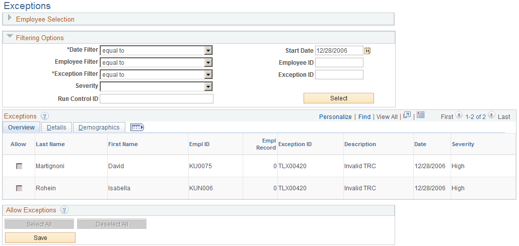

Exceptions Page
Use the Manage Exceptions page (TL_MNG_EXCEPT_PNL1) to review, allow, or clean up exceptions. The system displays up to 100 exceptions per page

This example illustrates the fields and controls on the Exceptions page. You can find definitions for the fields and controls later on this page.
Exceptions page
You may view and allow exceptions with a status of Unresolved using this page. System delivered exceptions have a High severity level are not allowable. To view exceptions that have already been resolved or allowed, use the Exceptions History page.
Field or Control Description
Employee Selection Criteria
Enter values and click the Get Employees button to control which employee exceptions the system displays to approve or resolve.
Filter Options
Expand this grid to further control which exceptions the system displays.
Filter Options
Date
Select a date filter for this exception: between, equal to, greater than, or less than.
EmplID
Select an EmplID filter for this exception: equal to, greater than, less than, or like.
Severity
Select a severity level filter for this exception: High, Low, or Medium.
Exception ID
Select an exception ID filter for this exception: equal to, like, not equal to, not like.
Run Control ID
Enter the value of the run control that was used when the exception was created.
Exceptions Grid
Allow
Select the check box in this column to select an individual time reporter's exception to be allowed for that date.
Note: If all the exceptions displayed on the page are not allowable, then the Allow column and Allow All button are hidden.
Exception ID
Displays the Exception ID code that was delivered with the system or that you defined using the Define Exceptions page. Click the Details tab to view the Exception Information details of the exception.
Description
Description of the exception.
Date
Displays the date of the reported time that caused the exception.
Name
Employee's name for the related exception.
Severity
Displays the severity of the exception: High, Medium, and Low. The system does not create payable time for reported time that has an exception severity of High .The system does create payable time for reported time with an exception severity of Low or Medium.
Note: The system treats Low and Medium exceptions in the same manner. The Medium severity is primarily an administrative designation that enables managers indicate exceptions that require greater attention.
Select All
Click to select all the exceptions for the group to be allowed. This selects the Allow check boxes for all the exceptions displayed on the page. If you click this button again, the system clears the Allow check boxes. Once you have selected the exceptions you want to allow, click the Save button to allow the exceptions. The exceptions can then be processed through Time Administration to create payable time.
Note: If all the exceptions displayed on the page are not allowable, then the Allow column and Select All and Deselect Allbuttons are greyed out.
Deselect All
Click to clear all selections made.
Save
Once you have selected the exceptions you want to allow, click the Save button to allow the exceptions. The exceptions can now be processed through Time Administration to create payable time.

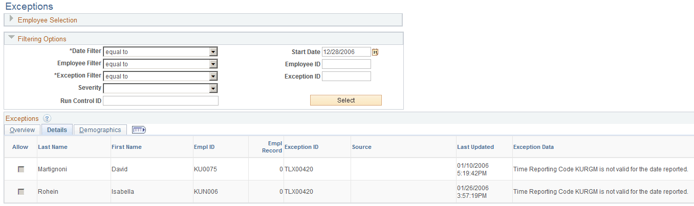

Viewing Manage Exception Details
Click the Details tab.
This example illustrates the fields and controls on the Exceptions page - Details tab. You can find definitions for the fields and controls later on this page.
The screenshot does not display all information on the page. Scroll to right on your screen to see the entire page.
Exception ID
The exception can be a system-delivered exception or one that you defined using the Define Exceptions pages.
Source
The source of the process that created the exception, such as Time Administration or Time Validation.
Last Update Date Time
Displays the date and time the exception was resolved or allowed.
Exception Data
Displays the message that contains the actual values that were entered that caused the exception such as "The reported TRC BNKR is invalid."
Exception Description
Click this link to view the long description for the exception.
Comments
Enter any comments about how or why the exception was allowed or resolved.
The remaining fields that display on the Details tab are the fields that have been selected on the Manager Search Options page.
