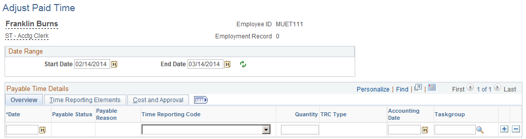

Adjust Paid Time Page
Use the Adjust Paid Time page (TL_MNG_PAY_DET_PNL) to make Record Only adjustments for individual employees or for non-employees.
Navigation:
This example illustrates the fields and controls on the Adjust Paid Time page. You can find definitions for the fields and controls later on this page.
If you change or add Leave Time Taken, you must manually change the leave hours in your HR database. The system will not adjust your leave balances. Also, the system will not adjust compensatory time balances for changes or additions of reported compensatory time.
