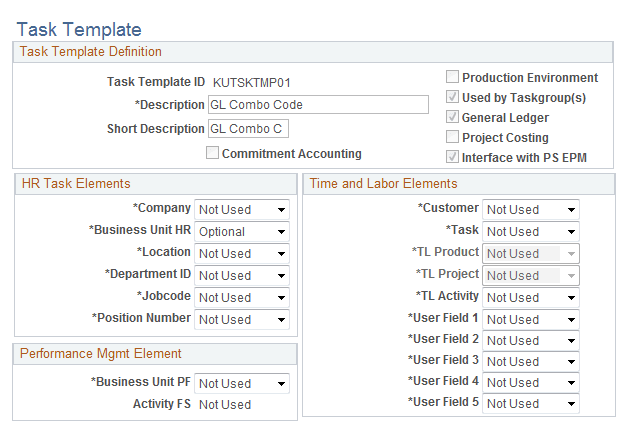

Use the Task Template page (TL_TSKPRF_TMPLATE) to select the types of task-related data you want a group of employees to report their time to such as company, business unit, department.
Navigation:
This example illustrates the fields and controls on the Task Template page (1 of 2). You can find definitions for the fields and controls later on this page.
This example illustrates the fields and controls on the Task Template page (2 of 2). You can find definitions for the fields and controls later on this page.
| Field or Control | Description |
Task Template ID |
This field displays the name of the task template. |
Commitment Accounting |
This is a display field. When selected, it indicates that your organization uses commitment accounting. In addition, the Combo Code field is enabled, and the Product and Project ID fields are unavailable. Note: A task template that is defined for commitment accounting can only be attached to taskgroups set up for commitment accounting. |
Production Environment |
Displays the setting from the TL Installation page. When the environment is specified as a Production Environment you cannot remove a task element previously marked as required, or add a previously unused element required. |
Used by Taskgroup(s) |
This is a display field. When selected, it indicates that the task template has been assigned to a taskgroup and the modifications you can make to the template are limited. If the system has been configured to use referential integrity (the Referential Integrity option on the Time and Labor Installation page is selected) you can add optional fields to the template and change required fields to optional. If the system is not using referential integrity, you can make any changes to the template except change the commitment accounting option. |
General Ledger |
Displays the setting from the Installation page. |
Project Costing |
Displays the setting from the Installation table. Impacts whether Project Costing fields are presented on the page. |
Interface with PS EPM |
Displays the setting from the TL Installation page. |
In the HR Task Elements, Time & Labor Elements, Performance Mgmt Element, and General Ledger Elements group boxes, select each type of task data you want time reporters associated with this taskgroup to report. For each field you choose, select either Required, Optional, or Not Used in the drop-down list to the right.
If your organization uses commitment accounting, Project Costing (PS/Projects) or Enterprise Performance Management (PS/EPM), some of the task fields may be selected automatically or made unavailable. The field descriptions below indicate when each field is available and the corresponding default values for selected fields.
HR Task Elements
Company |
Always available. |
Business Unit HR |
Selected automatically when you select Location, Department ID, Jobcode or Combo Code. If you make any of these fields required, Business Unit HR is also required. The Business Unit HR is required to derive the GL Business Unit for validation of combo code. |
Location |
Always available. Location is dependent on Business Unit HR. When you select Location, the system automatically selects Business Unit HR with the same default value. |
Department ID |
Not available when using commitment accounting. (Time and Labor automatically determines the correct HR department based on the combo code.) Department ID is dependent on Business Unit HR. When you select Department ID, the system automatically selects Business Unit HR with the same default value. |
Jobcode |
Always available. Jobcode is dependent on Business Unit HR. When you select Jobcode, the system automatically selects Business Unit HR with the same default value. |
Position Number |
Available only if using the Position Management feature and you have selected either Full or Partial on the HR Core Installation table. |
Business Unit PF |
Available only when Interface with PS/EPM is selected on the Time and Labor Installation page. |
Activity FS |
Controlled by the setting for Business Unit PF. |
Time and Labor Elements
Customer |
Always available. |
Task |
Always available. |
TL Product |
Available if Product is not an active ChartField or if combo code is not selected. |
TL_Project |
Mutually exclusive with PC Project when Project Costing is installed. Mutually exclusive with Combo Code if Project is an active ChartField. |
TL Activity |
Mutually exclusive with EPM Elements if Performance Management is installed. Mutually exclusive with Project fields if Project Costing is installed. Mutually exclusive with Combo Code if Project Costing fields are active ChartFields. |
User Field 1 to 5 |
Always available. |

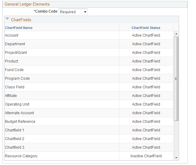

Combo Code |
Automatically selected as an enabled field when commitment accounting is in use. In all other cases, Combo Code is available. |
