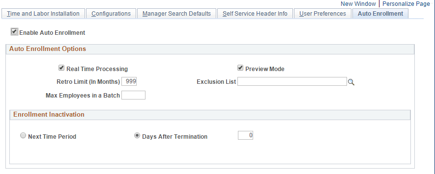

Use the Time and Labor-Auto Enrollment page (TL_AENRL_INSTALL) to enable the auto enrollments on the system by selecting a check box.
Navigation:
Set Up HCM, and then Product Specific, and then Time and Labor, and then Auto Enrollment
This example illustrates the fields and controls on the Time and Labor Auto Enrollment page.
Time and Labor Installation Auto Enrollment Page
You can edit all other fields on this page by selecting the Enable Auto Enrollment check box.
Field or Control Description
Select the check box to enable all other fields on this Auto Enrollment Installation page.
Real Time Processing
Select the checkbox to enable the real time processing. All Time and Labor Enrollments are done in real time when this option is chosen. The errors encountered is logged in an error table.
Preview Mode
Select for populating the enrollment data into a staging table for review.
Retro Limit (In Months)
Specify the number of months that the Auto Enrollment framework can go back when processing data changes.
Exclusion List
Provide a public query of process type through exclusion list. This query identifies the list of employees who should not be part of auto enrollment process.
Max Employees in a Batch
Controls the number of employees that get included in a batch when using the batch job for doing Auto enrollments. This field controls the number of employees that are placed in a single batch.
Days After Termination
Use to inactivate the employee enrollments with an effective date determined after adding the specified number of days to the Job data termination/ transfer date. If the number selected is ‘0”, then the time and labor enrollments are inactivated with the date equal to the effective date used on the job data transaction.
Next Time Period
Inactivated with an effective date equal to the next Time period begin date after considering the Job data termination or transfer date. Auto enrollment process uses the time period specified on employees’ Workgroup.

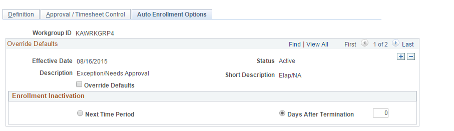

Workgroup Overrides Page
Use the Workgroup Overrides page (TL_AENR_WRKGRP_OPT) to enable Enrollment inactivation group box and its fields for user action.
Navigation:
Set Up HCM, and then Product Specific, and then Time and Labor, and then Auto Enrollment, and then WorkGroup Overrides .
This example illustrates the fields and controls on the Workgroup Overrides page
Override Defaults
Enable the Enrollment Inactivation option in the Auto enrollment process.
Any retrospective termination events done before updating the workgroup will have to be set manually using Maintain Time Reporter Data page or by using Data correction mode processing.
