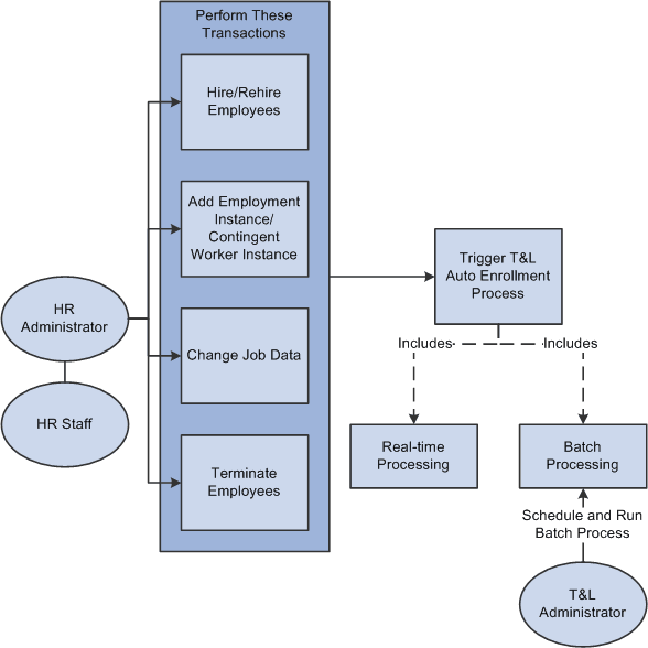

The diagram represents the architectural diagram of auto enrollment.
Architectural Diagram_Auto Enrollment
The Time and Labor Administrator defines the auto enrollment rules using the job and other attributes using which the Auto Enrollment framework define the selection criteria which determine what kind of time reporter an employee is.
The Administrators can create enrollment rules to determine how each employee will be added or updated for time reporter data and schedule assignment. The Administrator can use a PS Query to specify the SQL “WHERE” criteria which select employees who become eligible to a specific time reporter data set.
