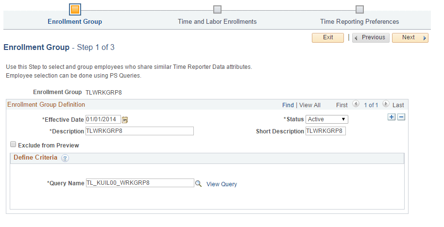

Enrollment Group Page
Use the Enrollment Group (TL_AENRL_CRT_PNL) page to select and group the employees who share similar time reporter data attributes using PS queries.
Administrator uses Enrollment Groups to select and filter a group of employees by using a PS Query and assigns them relevant Time reporter data attributes.
Navigation:
Set Up HCM , and then Product Related, and then Time and Labor , and then Auto Enrollment , and then Enrollment Group
The enrollment group pages include a process of three step train stops action for submitting the selection of enrollments.
The first action is to select the PS query used for grouping employees. Use this step to select and group the employees who share similar Time Reporter Data attributes with the help of Public PS query of Process type.
This example illustrates the fields and controls on the Enrollment Group page.
Field or Control Description
Effective Date
Date on which the Enrollment group is effective from.
Status
Status of the Enrollment group.
Query Name
Use PS Queries to define job and other data criteria that need to be used for differentiating employees before assigning relevant Time Reporter Data attributes.
Exclude from Preview
Check to exclude this enrollment group from Previews.
The query selected on this page has two field values; they are Employee ID and Employee Record as output.
As auto enrollment process is primarily designed to pick and process employees’ job data, query used should contain Job data record and it can have any additional records with relevant join conditions for defining the required criteria.
While creating PS query, delete any effective dated or effective sequence criteria which are added. Auto enrollment process adds the required date criteria based on the job data change row which are processed at run time.
Edit the query by selecting the View Query and do the necessary updates.
The View Query is to access, edit and execute the query.
In the subsequent steps of Enrollment Group definition, the user can specify the time reporter data attributes that need to be assigned to the employees selected by the query specified on the first step.

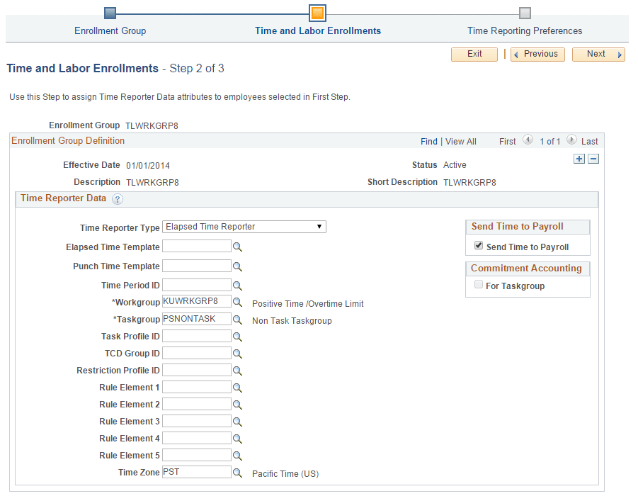

Time and Labor Enrollments Page
Use the Time and Labor Enrollments (TL_AENRL_TR_PNL) page to assign Time Reporter Data attributes to employees selected in First Step..
Navigation:
This example illustrates the fields and controls on the Time and Labor Enrollments page.
The enrollment rules created for time reporter data updates are executed during every Job data change.

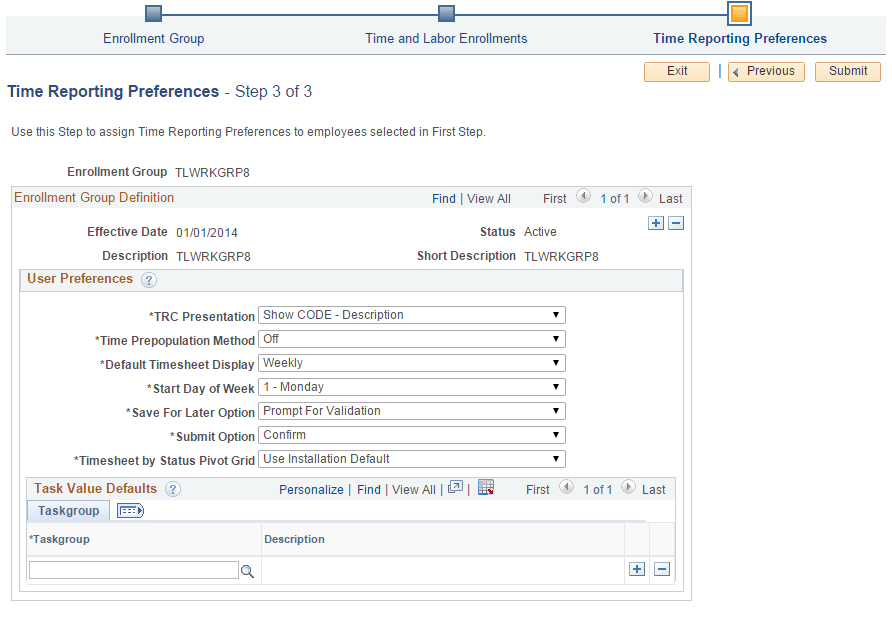

Time Reporting Preferences Page
Use the Time Reporting Preferences (TL_AENRL_EE_PREF) page to assign the Time Reporting Preferences selected in the first step.
Navigation:
Time and Labor user preferences are updated for employees only during the time of new hire or during first time enrollments. During subsequent Job data changes, only time reporter data gets updated wherever required. Employees have the ability to update their user preferences at any point of time. The user can enable their employees to make user preference updates by giving them the access to required pages.
This example illustrates the fields and controls on the Time Reporting Preferences page.
Time and Labor User Preferences are updated for employees only during the time of Hire or during first time enrollments. During subsequent Job data changes, only Time Reporter Data gets updated wherever required, while Time and Labor User Preferences remain the same throughout the employment tenure of the employee. Employees have the ability to update their user preferences at any point of time. The customer can enable their employees to make user preference updates by giving them the access to required pages.
Select Submit to update the changes after making the necessary changes.
Existing user preferences will never be overridden by the auto enrollment process.

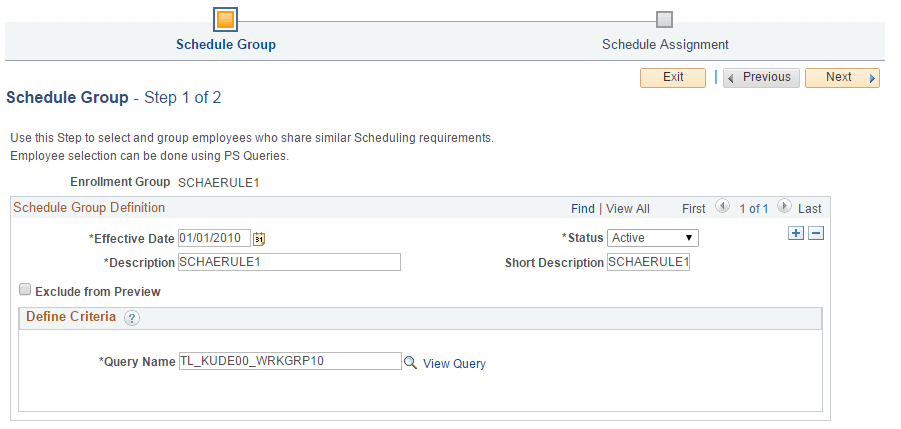

Schedule Assignment Group Page
Use Schedule Assignment Group (SCH_AENRL_CRT_PNL) page to perform the step of selecting and grouping employees who share similar scheduling requirements with the help of PS Queries.
Navigation:
Set Up HCM , and then Product Related, and then Time and Labor , and then Auto Enrollment , and then Schedule Assignment Group
The scheduling assignment is a two step train stops process to select and group employees who share similar requirements and assign the employees to the particular schedule.
As the employee schedule assignments are dynamic in nature, it is expected that Mangers update employee schedules wherever required. Schedule defaulting based on preset rules happen only at the time of new hire.
This example illustrates the fields and controls on the first step of Schedule Group page.
Schedule Group page

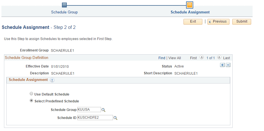

Schedule Assignment Page
Use Schedule Assignment (SCH_AENRL_ASGN_PNL) page to assign schedules to employees selected in the first step.
Navigation:
Use Schedule Assignment page for assign schedules to employees and submit it.
Schedule defaulting are based on preset rules which happen at the time of a new hire.
This example illustrates the fields and controls on the Schedule Assignment page.
Administrator can either choose to assign Default Schedules or Predefined Schedule .

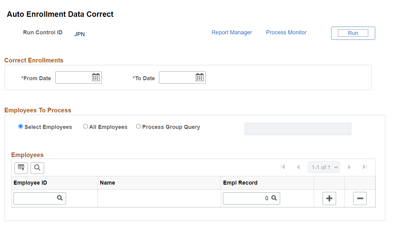

Auto Enrollment Data Correct Page
Use the Auto Enrollment Data Correct (TL_AENRL_DC_RUNCTL)) Page to run Auto Enrollments in data correction mode for changes within a specified period of time.
Navigation:
Time and Labor, and then Enroll Time Reporters, and then Auto Enrollment, and then Auto Enrollment Data Correct
This example illustrates the fields and controls of Auto Enrollment Data Correct page.
From Date
Specify the start date through which the corrections of auto enrollments are needed.
To Date
Specify the date until when the corrections of auto enrollments are needed.
Batch
If not using Real Time Processing, you can use Batch processing to automate employee enrollments in Time and Labor. The Auto Enrollment framework assumes that the Batch processing is in use, if the Real Time processing option is not chosen on Setup table. Batch processing can be processed in 2 modes – Incremental mode and Data correction mode.
Incremental processing means processing only that data which has changed since the last run. During the incremental run, only those employees whose job data changed after the last process run undergoes processing.
Data correction mode type of processing happens when your setups change or when the enrollments rules change retrospectively. The Time and Labor enrollments can be corrected between given dates. Data correction mode processing is available even when using real time processing.
