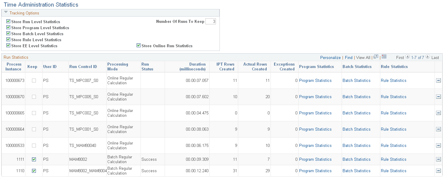

Time Administration Statistics Page
Use the Time Administration Statistics page (TL_TA_RSL_MAINT) to view the macro runtime statistics for the Time Administration process.
Navigation:
  • Set Up HCM, and then System Administration, and then Utilities, and then Analyze Time and Labor, and then Time Administration Statistics, and then Time Administration Statistics
  • Time and Labor, and then Process Time, and then Time Administration Statistics, and then Time Administration Statistics
This example illustrates the fields and controls on the Time Administration Statistics page. You can find definitions for the fields and controls later on this page.
Tracking Options
Use the following options to define the runtime statistics you want the Time Administration process to generate:
If you elect to store information at the detail level, the system automatically stores information at all higher levels. For example, if you select Store Batch Level Statistics, you can also access run level Time Administration statistics for the current run. You cannot, however, access detailed, section level statistics.
Field or Control Description
Store Run Level Statistics
Select to generate high level statistics for the current run as a whole, information about when the Time Administration process started and stopped, how may many rows were processed, and so forth.
Store Program Level Statistics
Select to generate detailed information for each batch at the program level, in other words, at the level of each of the steps or Application Engine subprocesses that make up the Time Administration process. For example, selecting this option enables you to generate and view statistics on such subprocesses as Punch Matching, Generate Intermediate Payable Time, and so forth.
Select to generate more detailed statistics on a batch by batch basis. For instance, the time taken to process each batch, and the start and end date of the period of interest for the batch.
Store Rule Level Statistics
Select to store the Rule Map and see what rules you ran, the order in which they ran, and so forth.
Store EE Level Statistics
Select to store employee details such as the Employee ID, Employee Record, Name, Employee Effective Date, Status, batch start date and end date, rule period start and end, and the unadjusted end date for each employee processed.
Number of Runs to Keep
Enter the number of previous Time Administration runs for which you want to store runtime statistics, batch and rules data — up to four digits. For example, if you enter a 3 in this field, the system keeps the data for the last three runs.
Store Online Run Statistics
Select to store any applied rule statistics when the process runs for real-time rules from the timesheet. This stores statistics for the Online Regular Calculation processing mode.
If you elect to generate runtime statistics on your batch runs, you can view the statistics using the Batch Statistics page and Program Statistics page.
Run Statistics
Process Instance
The order assigned to the run in the processing queue. The number is generated automatically by the Process Scheduler.
Keep
Select to specify that the system should retain the selected row of run statistics. The Number of Runs to Keep field indicates the maximum number of rows you can specify.
Forecast Payable Time
This check box is selected if you chose the Forecast Payable Time option on the Time Administration run control page.
IPT Rows Created
The number of rows created in Intermediate Payable Time.
Actual Rows Created
Displays the actual rows created, either payable time or forecasted time.
Exceptions Created
The number of exceptions generated when Time Administration was run.

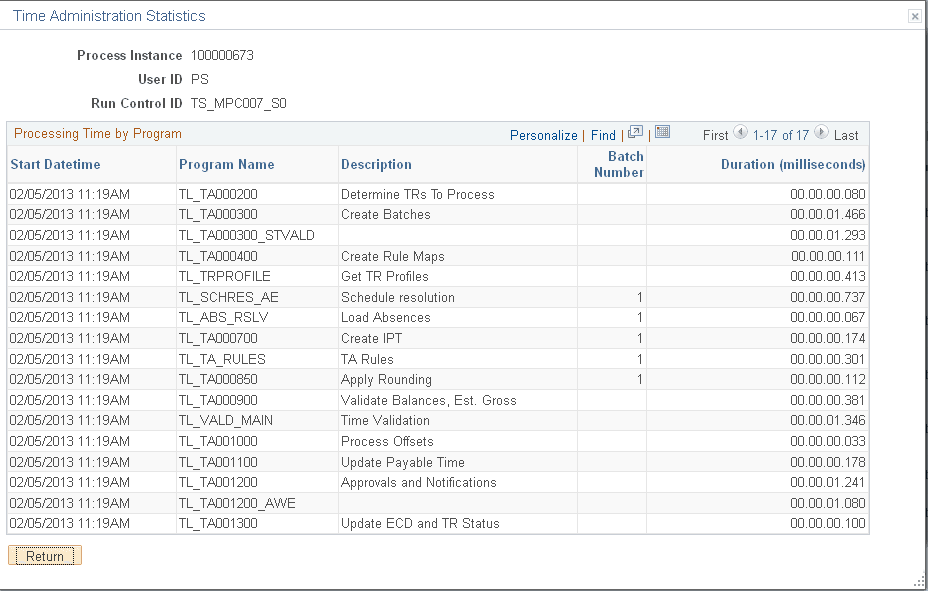

Program Statistics
Click this link to access the Program Statistics page, where you can see the runtime for each section in the batch.

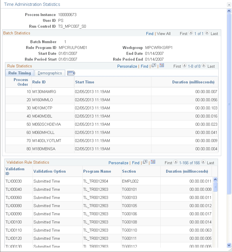

Batch Statistics
Click this link to access the Batch Statistics page, where you can see additional information about the batch.
Rule Statistics
Click this link to access the Rule Statistics page, where you can see additional information about the Archive Rule Map.
Program Statistics Page
Use the Program Statistics page (TL_TA_RSL_SECT ) to view the Application Engine statistics.
Navigation:
Click the Program Statistics link on the Time Administration Statistics page.
This example illustrates the fields and controls on the Program Statistics page. You can find definitions for the fields and controls later on this page.
Program Name
This is the section name, that is, the name of the subprocess for which you have generated statistics.
Batch Number
Batch Statistics Page
Use the Batch Statistics page (TL_TA_RSL_BATCH ) to view the run time, start and end dates of the period of interest covered by the batch, and the number of time reporters in the batch.
Navigation:
Click the Batch Statistics link on the Time Administration Statistics page.
This example illustrates the fields and controls on the Batch Statistics page. You can find definitions for the fields and controls later on this page.
Statistics Tab
Time Reporters
This is the number of time reporters processed in the batch.
Demographics Tab
Workgroup Effective Date
The effective date of the workgroup row that was effective for this run and for this time reporter.
Rule Program Date
The effective date of the rule program row that was effective for this run and for this time reporter.
