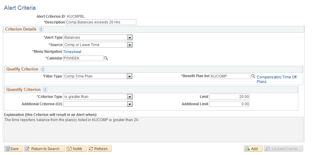

Alert Criteria-Balances Page
Navigation:
Set Up HCM, and then Product Related, and then Time and Labor, and then Alerts, and then Alert Criteria, Select Alert Type as Balances
This example illustrates fields and controls on the alert criteria for balance type.
Alert Criteria - Balances

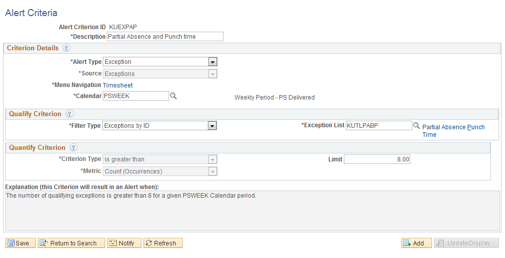

Alert Criteria-Exception Page
This example illustrates fields and controls on the alert criteria for Exception alert Type.
Alert Criteria - Exceptions
Field or Control Description
Quality Criterion
Specify additional parameters for the data to be considered when validating this criterion, like a set of Time Reporting Codes or a set of Status codes
Quantify Criterion
Define the boundary (or boundaries) outside which this criterion should trigger an alert, such as the minimum and / or maximum hours generally allowed.

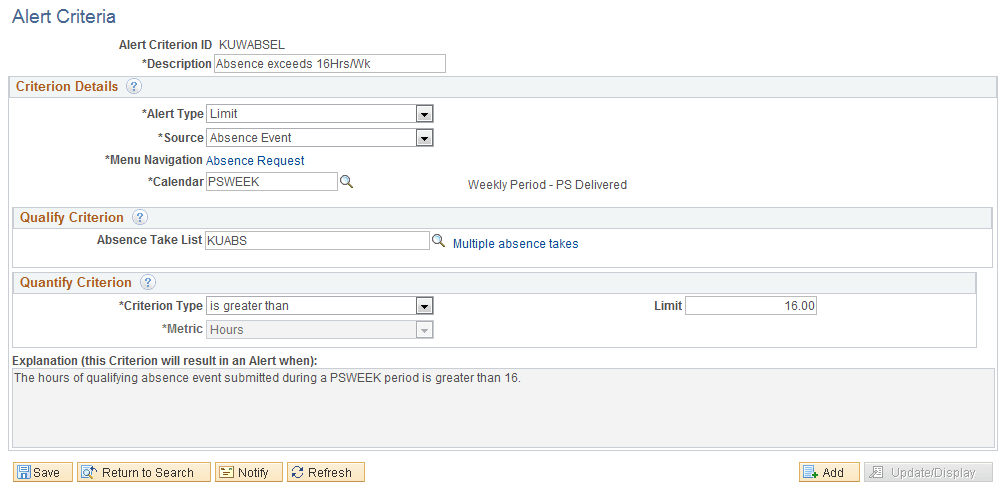

Alert Criteria-Limit Page
Use Alert Criteria-Limit page to define the circumstances that require an alert.
This example illustrates fields and controls on the alert criteria for Limit.
Alert Criteria - Limit
Limits do not require value list to be entered. It may be sufficient to express the limit without specifying a set of TRC’s or Absence codes. This particularly rings true in terms of limits such as estimated gross on payable time.

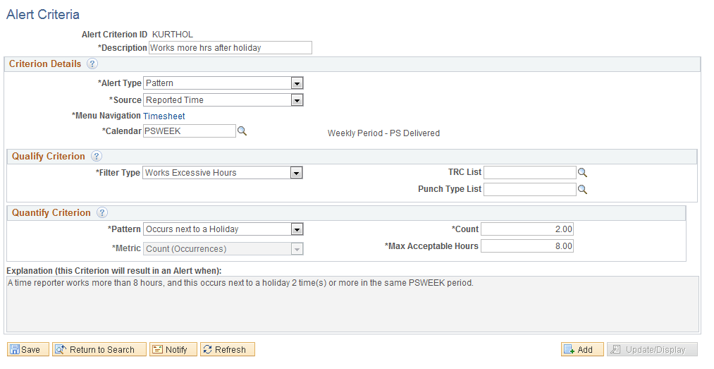

Alert Criteria-Pattern Page
This example illustrates fields and controls on the alert criteria for Pattern.
Alert Criteria - Pattern
In addition to offering the same absence cover, when absence is reported using designated TRC’s, this alert enables flagging of excess hours or people working without breaks. The page content adheres to the Filter Type chosen. The patterns are the number of occurrences, number of days consecutive, or the number of occurrences next to a holiday.

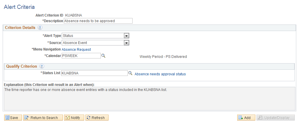

Alert Criteria-Status Page
This example illustrates fields and controls on the alert criteria for Status
Alert Criteria:Status page
Status check alerts are provided against Absence Events, Payable Time and Reported time.

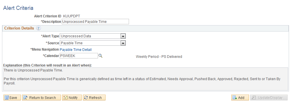

Alert Criteria-Unprocessed Time Page
This example illustrates fields and controls on the alert criteria for unprocessed time.
Alert Criteria - Unprocessed Data
Unprocessed time is expressed in the explanation when the criterion is defined.

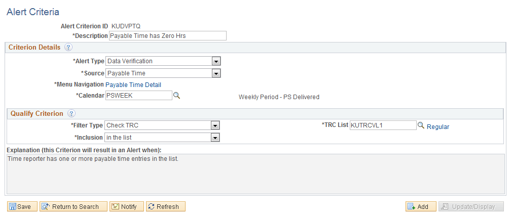

Alert Criteria-Data Verification Page
This example illustrates fields and controls on the alert criteria for Data Verification.
Alert Criteria - Data Verification
Payable time filter type is only Check TRC. Filter type for reported time is Quantity is not positive, Zero and Check TRC

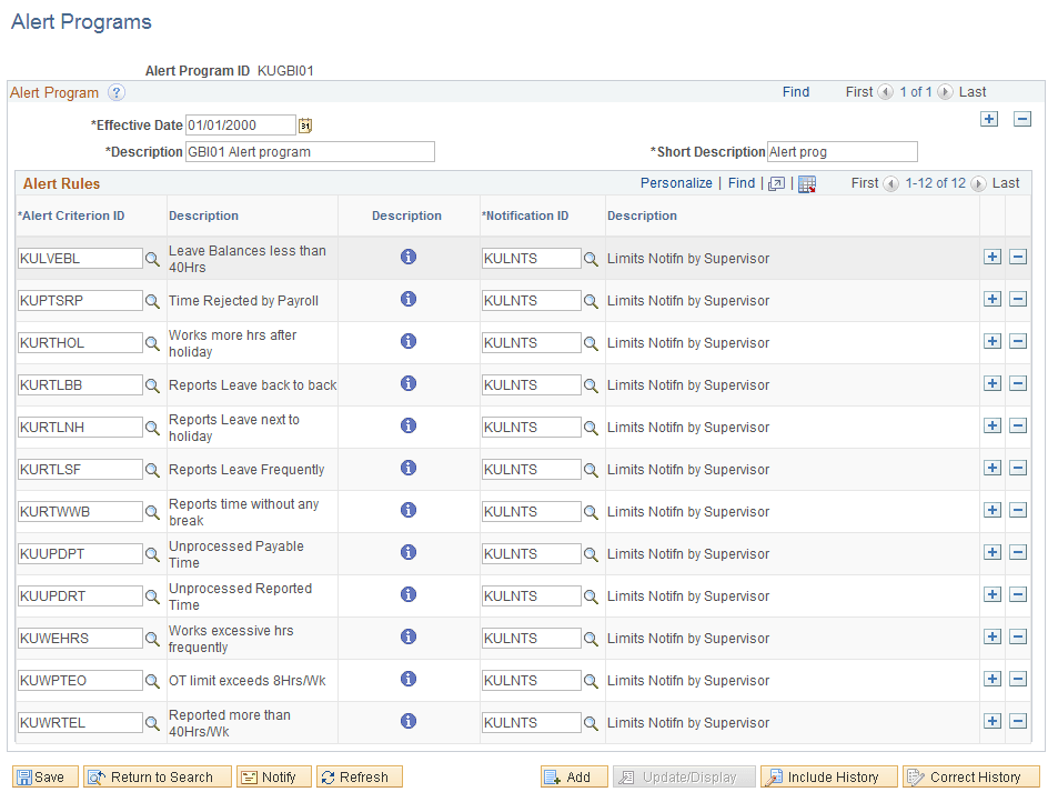

Alert Program Page
Use Alert Program Page (TL_ALRT_PGM) to define a set of alert rules which decides the set of people to be notified according to the met conditions.
Navigation:
Set Up HCM, and then Product Related, and then Time and Labor, and then Alerts, and then Alert Programs
This example illustrates the fields and controls on the Alert Programs page.
Alerts Programs page
Alert Program
An alert program defines a set of Alert Rules. It provides - at the rule level - the link up to identify the person(s) to alert when the conditions of the rule is met.

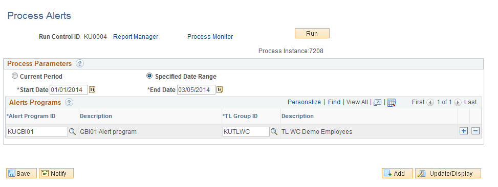

Process Alerts Page
Use Process Alert page (TL_ALERTS_PROCESS) to execute the data checking at a given time and frequency.
Navigation:
Set Up HCM, and then Product Related, and then Time and Labor, and then Alerts, and then Process Alert
Alert processing is done by managers and Time and Labor Administrators.
This example illustrates the fields and controls on the Process Alert page.
Process Alerts
Process Parameters
Select the time frame to be covered and the alert programs to be run. The Current Period option will cover the current period (according to each time reporters Workgroup setting). The process will dynamically determine the current period based on the date when the process is run.
Alerts Programs
Grid label on the Process Alerts page.
There are two modes for running a selection of alerts:
  • Run control Current Period option: This covers the current period according to each time reporters’ workgroup setting. The process determines the current period based on the date when the process is run
  • Run Control From and To dates specified
    • In this case ONLY Alert criteria time period will be considered. . The process compares the time and labor calendar in sync with this period specified in the Alert criteria (other than NONE).
    • For NONE- purely from and to dates will be considered.
    • Alert process allows mapping of the same program against more than one group or subject the same group to more than one program.
