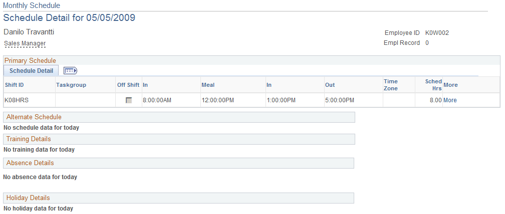

Monthly Schedule - Daily Detail Page
Use the Monthly Schedule - Daily Detail page (SCH_EE_DAILY) to view schedule details for a day.
Navigation:
Click a Date link on the Monthly Schedule page.
This example illustrates the fields and controls on the Monthly Schedule - Daily Detail page. You can find definitions for the fields and controls later on this page.
On the Monthly Schedule page, if a punch or flex schedule is displayed for the day, the daily cell of the monthly schedule displays the Shift ID, the number of Scheduled Hours, and the start and end time of the shift. If an elapsed schedule for the day is displayed, the system displays the Shift ID and Scheduled Hoursin the daily cell of the month. If there is more than one shift for the day, the daily cell displays More shifts... and all the shift information is displayed on the Daily Detail page.
Users can link to their Schedule Preferences page from the Monthly Schedule page to update or view their preferences. Users can use the Notify button from the Monthly Schedule or Daily Detail pages, to alert their manager of changes they would like made for their schedule. Employees can also navigate to other self service and time reporting pages from the Monthly Schedule page.
The user can click on the calendar date to drill into the daily detail of the schedule. On the Daily Detail page the user can view details of the primary or alternate schedule. Training details from Training Administration or Learning Management are displayed with the start and end time of the training. Absence details from PeopleSoft Absence Management or leave reported for Base Benefits is displayed with the number of hours for the absence. Holiday details are displayed with the name of the holiday and the number of hours for the holiday.
