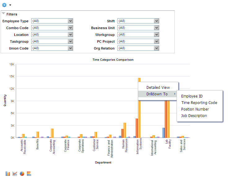

Drilldown Menu
When you click a data element (for example, a bar on a bar chart), a menu provides these options:
  • Detailed View: Displays a grid with the detailed data. For example, if a bar on a bar chart represents the number of job openings that were filled in a particular month, clicking Detailed View displays a grid with information about each of the included job openings.
  • Drilldown To: Displays the drilldown options defined for the chart. Clicking a drilldown option redraws the chart based on the selected type of data.

Time Categories Comparison Page
TL_TIME_CAT_IRPT
Displays a comparison report on Payable Time based on the time categories for the duration provided.
This allows comparing data like overtime versus regular, productive versus non-productive time.
Using Related Actions on the drill down grid you can access the Timesheet page.

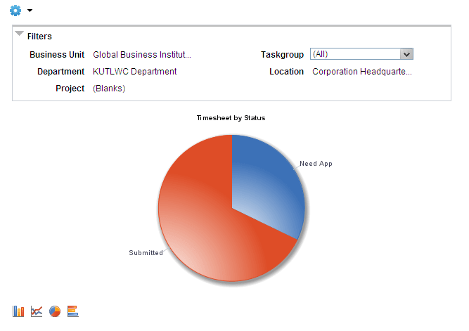

Timesheet by Status Pivot Grid Page
Use the Timesheet by Status pivot grid (TL_RPTD_IRPT) to display the number of occurrences for each reported timesheet status for a manager’s employees within the specified dates.
Navigation:
  • Time and Labor, and then Reports, and then Interactive Reports, and then Timesheet by Status
  • Manager Self Service, and then Time Management, and then Time and Labor WorkCenter Select the Reports/Processes tab, then select the Timesheet by Status link.
This example illustrates the Timesheet by Status pivot grid.
The Timesheet by Status pivot grid displays timesheet status data from TL_RPTD_TIME in a pie chart. A manager can view a summary of the timesheet status for all of the manager’s employees. The manager can filter the information using different levels of detail.
The grid view of this chart provides a link to the related Timesheet.
Chart Content and Layout
Option Details
From and To
Enter the starting and ending dates to define the date range for the pivot grid.
Generate Report
Select to display the pivot grid, based on the specified employees and the date range specified for the pivot grid.
Options menu for pivot grids
Prompts
Enter a specific value for any of the listed fields to modify the displayed pivot grid. The available fields are Start Date, Dept ID, Supervisor ID, Reports to, Location, Company, Pay Group, Paygroup_GP, Workgroup, Taskgroup, Position, End Date, Time Group, Empl ID, Empl Record, First Name, Last Name, Business Unit, Job Code, Job Descr.
Filters
  • Business Unit
  • Department
  • Project
  • Taskgroup
  • Location
Drill-down options
  • TRC
  • Position No. (Position Number)
  • Jobcode
  • Approver Name
Chart type options
  • Bar chart
  • Line chart
  • Pie chart
  • Horizontal bar chart
Use the Time Categories Comparison pivot grids (TL_TIME_CAT_IRPT) page to display a comparison report on Payable Time based on the time categories for the duration provided.
Navigation:
  • Time and Labor, and then Reports, and then Interactive Reports, and then Time by Categories Report
  • Manager Self Service, and then Time Management, and then Time and Labor WorkCenter Select the Reports/Processes tab, then select the Time Categories Comparison link.
This example illustrates the Absence Types - pivot grid
Time Category Comparison
The Timesheet by Status pivot grid displays timesheet status data from TL_RPTD_TIME in a pie chart. A manager can view the summary of the timesheet status for all of the manager’s employees. The manager can filter the information using different levels of detail.
The following table describes options for manipulating the chart:
Option Details
From and To
Generate Report
Prompts
Enter a specific value for any of the listed fields to modify the displayed pivot grid. The available fields are Start Date, Dept ID, Supervisor ID, Reports to, NA Pay Group, GP Pay Group, Workgroup,Taskgroup, Position Number, End Date, Time Reporter Group,TRC Category 1 TRC Category 2, Employee ID, Empl Record, First Name, Last Name, Business Unit, Job Code, Job Description.
Filters
  • Employee Type
  • Shift
  • Combo Code
  • Business Unit
  • PC Project
  • Taskgroup
  • Location
  • Workgroup
  • PC Project
  • Union Code
  • Org Relation
Drill-down options
  • Employee ID
  • Time Reporting Code
  • Position Number
  • Job Description (Description of Job Code)
Chart type options
  • Bar chart
  • Line chart
  • Pie chart
