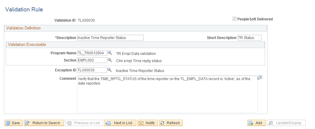

Validation Rule Page
Use the Validation Rule page (TL_VALID_DEFN_PNL) to define Validation IDs. Validation IDs designate Application Engine sections as executables that can be selected for use in validation rules. A Validation Rule combines a Validation Executable with an Exception.
Navigation:
Set Up HCM, and then Product Related, and then Time and Labor, and then Validation Criteria, and then Validation Rule
This example illustrates the fields and controls on the Validation Rule page. You can find definitions for the fields and controls later on this page.
Field or Control Description
Program Name
Specify the AE program for this validation. The available programs are limited to those referenced by a Validation Executable. Specifying a Program Name enables you to have like-named sections on different program libraries.
Section (validation application engine section)
Select the validation AE section that corresponds to this validation. The valid values depend upon your selection in the Program Name field. - you can only specify sections that are associated with the specified program.
Exception ID
Select the exception ID that should correspond to this validation. Generally, there will be a one-to-one correlation between exceptions and validations, but several validations could trigger the same exception. There will never be more than one exception per validation.
