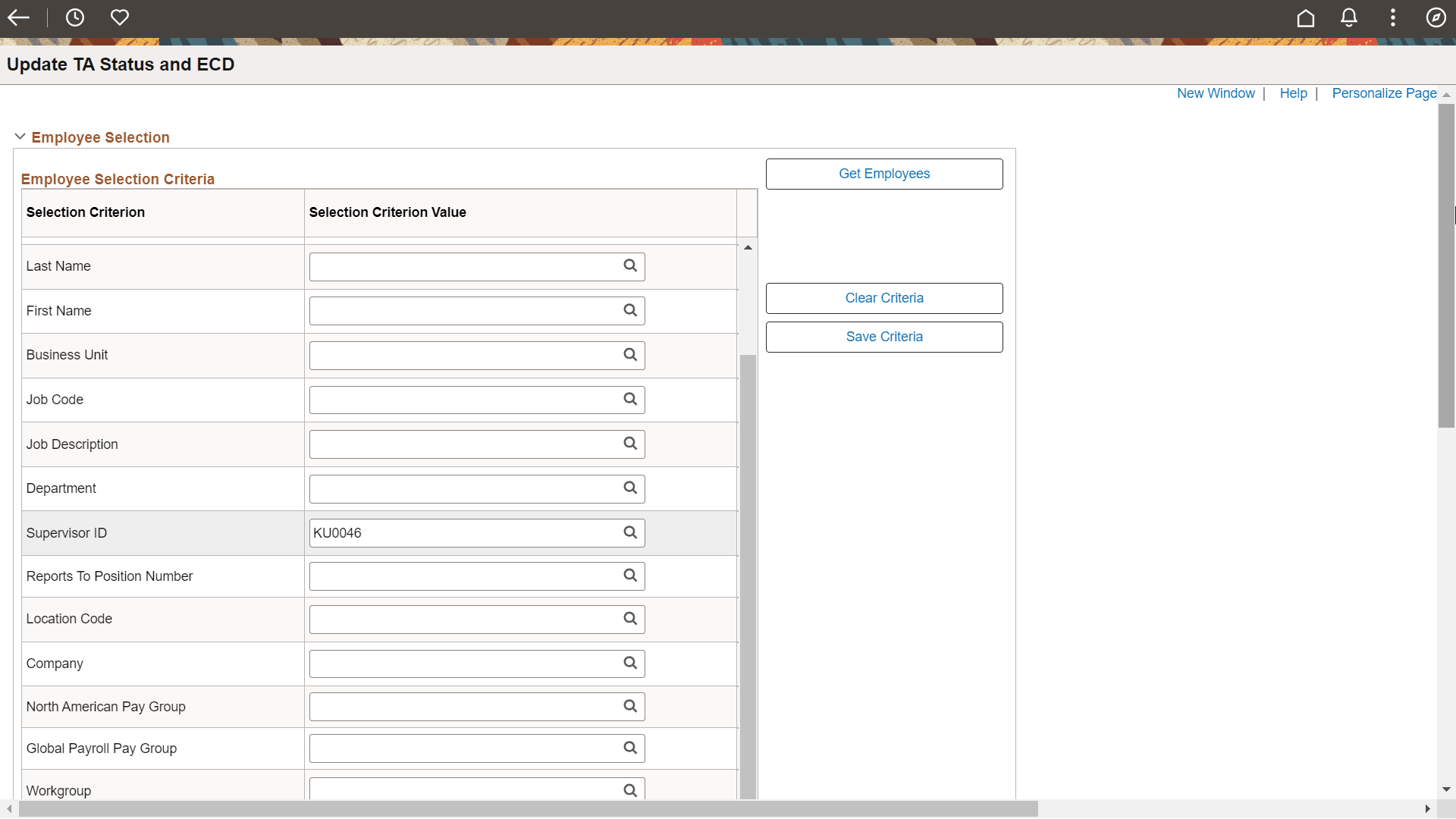

Update TA Status and ECD Page
Use the Update TA Status and ECD page (TL_TR_STAT_UPD) to modify the TA status and earliest change date for the time reporter or group of time reporters you specify.
Navigation:
Time and Labor, and then Process Time, and then Update TA Status and ECD
Update TA and Status ECD page 1
Update TA and Status ECD page 2
Employee Selection
Use the Employee Selection section to search for employees based on certain filter criteria.

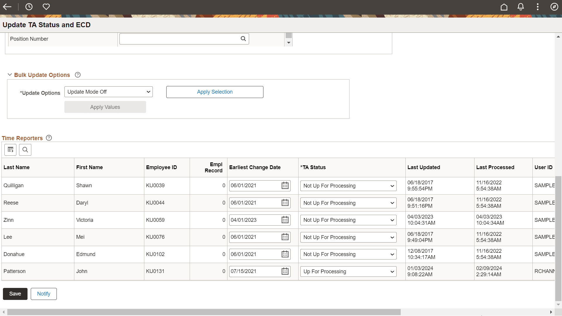

Bulk Update Options
Use the Bulk Update Options to update the ECD and TA status for multiple rows in the Time Reporters grid. With the Bulk Update Options, you can easily apply the desired ECD and TA status to all the rows in the time reporters grid. This feature is particularly useful when you need to make bulk updates to the Time Administration statuses.
It's important to note that the changes made using the Bulk Update Options will only be reflected in the grid, and the actual data won't be saved until you manually save the page. This gives you the flexibility to review and modify the values for any specific rows that require individual attention.
Field or Control Description
Update Options
Select the required value from the drop-down list.
Available options are:
  • Update ECD: Select this value to set the Earliest Change Date field.
  • Update ECD and TA Status: Select this value to set both the Earliest Change Date and Time Administration status values simultaneously.
  • Update Mode Off: Select this value to reset the values on the Time Reporters grid to the last saved values, for the selection that was opted out.
  • Update TA Status: Select this value to set the Time Administration status.
By default, the value 'Update Mode Off' is selected in this field.
Apply Selection
When a new option is selected or changed, click this button to confirm the bulk update selection.
Apply selection will take the chosen option and display the corresponding fields.
Apply Values
Click the Apply Values button to copy the values for TA Status, ECD, or both to the Time Reporters grid.
A text message stating "Time Reporters will be updated with the Earliest Change Date of <date> and TA Status of <selected TA Status value>" appears when the Apply Values button is selected.
Note: The Apply Values button will be enabled only after Apply Selection is selected.
Whenever the action is reverted before saving for example Reverting to "Bulk Mode Off" after selecting "Update ECD and TA Status" and applying the values on the grid, the time reporters grid will be replaced with the default values from the last commit.
Time Reporters
Use the Time Reporter grid to view the TA status and earliest change date for the time reporter or group of time reporters you specify.
The earliest addition or update to time-related data for a time reporter since the last Time Administration run. You can modify the date in this field to in order to facilitate corrective Time Administration processing for specific time reporters. The system prevents you from entering an Earliest Change Date before the time reporter was enrolled in Time and Labor.
Important: You should only modify the Earliest Change Date on an exception basis. Setting this field incorrectly could result in a time reporter not receiving accrued Payable time, or a time reporter receiving Payable time that has not been accrued.
TA Status
Indicates whether the time reporter will be processed the next time the person is selected for the Time Administration process. The valid values are: Up for Processing, the time reporter is ready for processing; Not up for processing, the time reporter is not ready for processing; or In Process, the time reporter is being processed. The system does not allow you to change the time reporter’s status to In Process.
Last Updated and Last Processed
The fields in the Last Updated column display the date and time that the Time Reporter was last updated. The fields in the Last Processed column indicate when the Time Administration process was last run for a Time Reporter.
The system compares these two dates and if the value in the Last Updated field is later than the date and time in the Last Processed field then the system recognizes that the update for a positive time reporter may not have been processed by the Time Administration process yet, and will not set the TA_STATUS to Not up for processing, however, you can manually set that status on this page.
User ID
Displays the User ID of the last user that updated the Earliest Change Date and TA Status fields.
