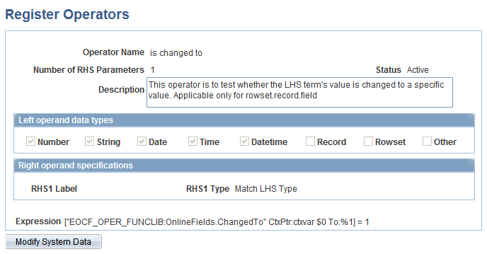

Register Operators Page
Use the Register Operators page (EOCF_OPERATOR_DEFN) to define operators.
Navigation:
Enterprise Components, and then Active Analytics Framework, and then Setup, and then Register Operators
This example illustrates the fields and controls on the Register Operators page. You can find definitions for the fields and controls later on this page.
Register custom operators by defining the left-hand-side and right-hand-side operand specifications and entering expression text.
Field or Control Description
Operator Name
Enter the name of the operator you are defining. Operator names do not need to be unique as long as the expression texts are different.
Number of RHS (right-hand side) Parameters
Specify the number of right-hand-side parameters that are required to evaluate the Boolean value for this operator. The condition builder uses this to display one or more right-hand-side fields to enter values.
Note: In this release, the condition builder interface supports a maximum of two right-hand-side parameters for an operator.
Left operand data types
Specify the supported data types for the left-hand-side operand of this operator. This data is used to constrain the list of operators in the condition builder.
Right operand specifications
Specify the type for each of the right-hand-side parameters.
  • Match LHS Type. Supports the left-hand operand data types.
  • Fixed Type. Specify a fixed data type for this parameter.
  • Multi-Select. Enables selection of multiple values for this parameter at condition building time.
Expression
Specify the technical expression defining how the operator works.

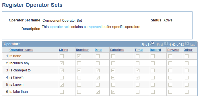

Register Operator Sets Page
Use the Register Operator Sets page (EOCF_OPERSET_DEFN) to define operator sets.
Navigation:
Enterprise Components, and then Active Analytics Framework, and then Setup, and then Register Operator Sets
This example illustrates the fields and controls on the Register Operator Sets page. You can find definitions for the fields and controls later on this page.
Operator sets define the list of valid operators for a term selected on the left-hand side of a condition.
Enter a unique operator set name and description, and add valid operators for this set.
