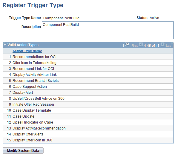

Register Trigger Type Page
Use the Register Trigger Type page (EOCF_EVTYP_DEFN) to define trigger types.
Navigation:
Enterprise Components, and then Active Analytics Framework, and then Setup, and then Register Trigger Type
This example illustrates the fields and controls on the Register Trigger Type page. You can find definitions for the fields and controls later on this page.
Enter details about the trigger type that you are defining and select the valid actions.

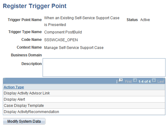

Register Trigger Point Page
Use the Register Trigger Point page (EOCF_EVENT_DEFN) to define trigger points.
Navigation:
Enterprise Components, and then Active Analytics Framework, and then Setup, and then Register Trigger Point
This example illustrates the fields and controls on the Register Trigger Point page. You can find definitions for the fields and controls later on this page.
Field or Control Description
Trigger Point Name
The unique and descriptive name of the trigger point.
Trigger Type
Used by IT developers to determine which PeopleSoft event in the component needs to be enabled with this trigger point. This option also restricts the list of valid action types that can be used when you are creating policies for this trigger point.
Code Name
Use to reference the trigger point when programmatically enabling this trigger point for a PeopleSoft component. Changes made to the code name, after you enable this trigger point for a PeopleSoft component, may disrupt the execution of policies for this trigger point at runtime.
Context Name
Defines the context for the trigger point.
