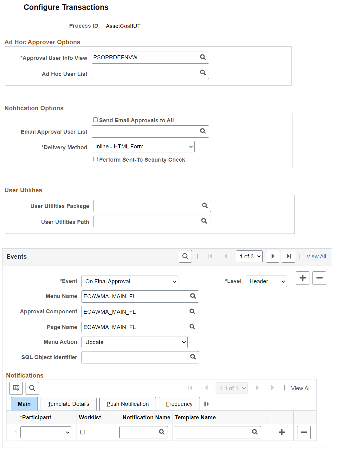

This example illustrates the fields and controls on the Configure Transactions page.
Configure Transactions page (1 of 2)
Use this page to select and define elements that determine what triggers a notification, who receives the notification, and the content of the notification. Notifications are mapped to work with the approval transaction registry and include menus and components and SQL definitions. The events for which the system sends notifications include:

Ad Hoc Approver Options
Field or Control Description
Approver User Info View
Provides details about which view a user sees when using the Approval Monitor.
Note: Data in this view dictates what is displayed in the approver links.
Ad Hoc User List
This is a filter used to display only a list of users who can be ad hoc approvers.

Events
Use the events section to define event parameters to trigger workflow notification.
Level
Select Header or Line to determine the level at which you want a notification sent for an event. For each of these events to be notified, you must select the level of the transaction.
Event
Select the event for which you want to send a notification. Participants will be notified when the selected event is triggered.
Event values include:
Ad Hoc Delete: Send a notification when a step is removed from the approval process through the status monitor.
Ad Hoc Insert: Send a notification when a step is added to the approval process through the status monitor.
Hold Step: Send a notification when a thread is placed on hold.
Locked Out: Send a notification when the application workflow engine (AWE) encounters a user whose account has been locked out.
No Approver Necessary: Send a notification when a thread does not route because no approval is necessary.
On Cancel: Send a notification when a thread is cancelled.
On Error: Send a notification when a thread encounters a routing error.
On Escalate: Send a notification when a thread is escalated through the NEM process.
On Final Approval: Send a notification when a thread is approved and there are no more steps to process.
On Final Denial: Send a notification when a thread is denied and there are no more steps to process.
On Process Launch: Send a notification when an approval process is submitted.
On Reactivate: Send a notification when a step is reactivated for a thread. It is now recommended to not to use this value.
On Reassign: Send a notification when a thread is reassigned to a new approver. With an On Reassign event notification, AWE will create new worklist for the approvers that are reassigned to the transaction. For an On Reassign event, you can only configure an Approvers notification.
On Step Complete: Send a notification when a step no long has pending threads.
On Terminate: Send a notification when a thread is terminated.
Processing Complete: Send a notification when an approval process is complete. It is now recommended to not to use this value.
Push Back: Send a notification when a thread is pushed back from one step to the prior step.
Request Information: Send a notification when the Request Information action is called by the application.
Request Information Added: Send a notification when a comment is added for a thread and that thread has been placed on hold.
Route for Approval: Send a notification when a thread is routed to an approver.
Route for Review: Send a notification when a thread is routed to a reviewer.
Note: The Lock Out, On Process Launch, and Processing Complete events are for header level only.

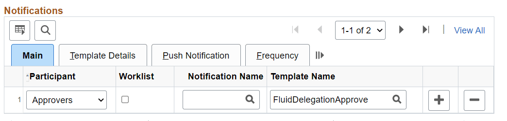

Main Tab
Main tab

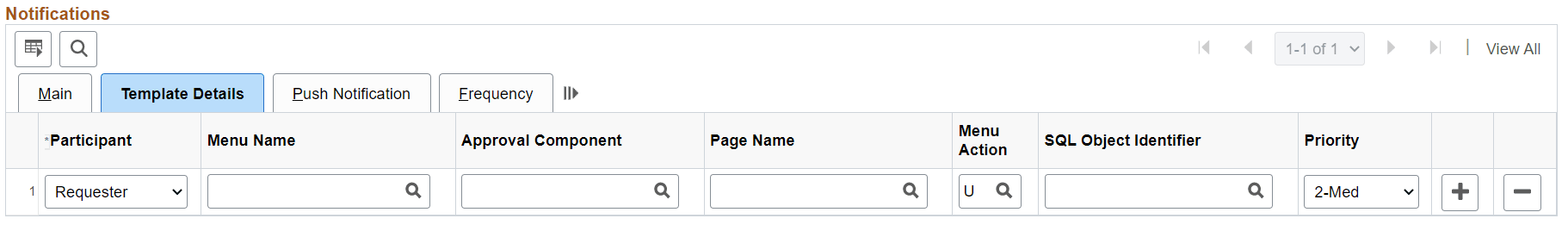

Template Details Tab
Notification Template

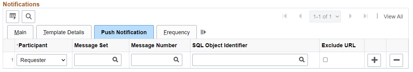

Push Notification Tab
Push Notification

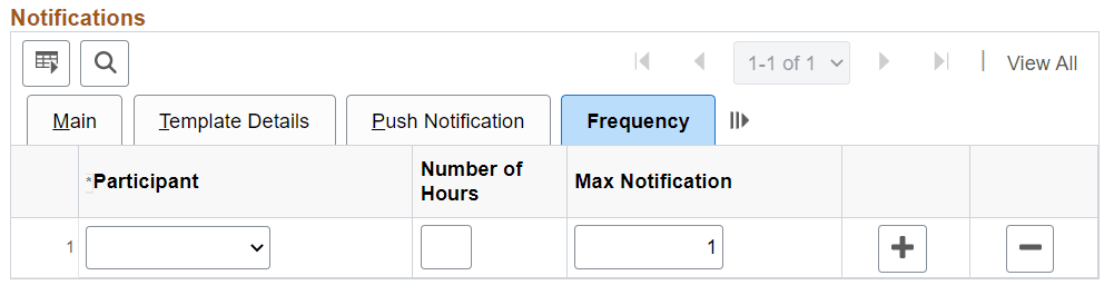

Frequency Tab
Notification Frequency

Participant
Define the user who is notified when this event takes place.
  • A-Delegate: the approver that the approval was originally assigned to.
  • A-Proxy: the approver who performed the actual approval.
  • Admin
  • Approvers
  • Dynamic: uses the user list defined on the Time Out Options page.
  • External
  • R-Delegate: the person who created the request for someone else.
  • R-Proxy: the person who requested the transaction to be created.
  • Requester
  • Reviewers
  • User List: uses the user list defined on the User List Definition Page.
Note: If both R-Proxy and Requester are configured, only R-Proxy will get notifications. Similarly, if A-Proxy and Approvers are configured, then only A-Proxy will get notifications.
Worklist
Select this check box to include the worklist along wth the notification.
Notification Name
Enter the required notification name. The prompt displays only the AWE Notification names.
Note: The notification name defined in the event level overrides the PeopleTools notification name given in the approval transaction level.

Select the generic template you want to use for the email content of this notification. You define the contents of the email using the Generic Template page.
See Generic Template Definition Page.
Menu Name, Approval Comment, Page Name, Menu Action, and SQL Object Identifier
All of these fields have the same definition as the corresponding fields in the Events section of this page.
Number of Hours
Enter a number that determines how many hours between notifications.
Message Set, Message Number, SQL Object Identifier, and Exclude URL
Enter the message set, Message number and the SQL Object Identifier for the notification. SQL Object Identifier has the same definition as in the Events section of this page.
Note: Message Set and Message Number cannot be empty if the Push Notification channel is selected. If Exclude URL is selected, the component approval URL will not be attached to the push notification.
Number of Hours
Enter a number that determines the maximum waiting time for the notification. If the approver does not take action, an escalation is sent to the person defined by the Participant value.
Individual transactions determine their own timeout periods. For instance, the JobOpening transaction might time out after 2 hours, but the JobOffer transaction may time out after 1 hour.
Max Notification (maximum notification)
Enter a number that determines the maximum number of notifications sent. If the approver does not take action, an escalation is sent to the person defined by the Participant value.
