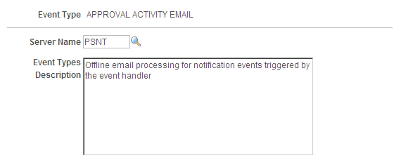

Event Type Page
Use the Event Type page (EOAW_NEM_EVENTS) to associate events to a server.
Navigation:
Enterprise Components, and then Approvals, and then Notification and Escalations, and then Events
This example illustrates the fields and controls on the Event Type page. You can find definitions for the fields and controls later on this page.
Event Type page
Field or Control Description
Event Type
Select an event type. PeopleSoft applications deliver some event types, such as ESCALATION_EVENT and APPROVALACTIVITYEMAIL.
Server Name
Select the server on which to run the notification.

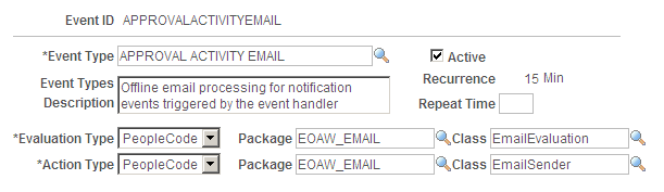

Notification and Escalations Page
Use the Notification and Escalations page (EOAW_NEM_SETUP) to set up an escalation event and define the evaluation and action details.
Navigation:
Enterprise Components, and then Approvals, and then Notification and Escalations , and then Notifications and Escalations
This example illustrates the fields and controls on the Notification and Escalations page. You can find definitions for the fields and controls later on this page.
Event Type
The server information that was entered on the Event Type page.
Event Types Description
The value entered in the Description field on the Events Type page.
Active
Select to enable the escalation process.
Recurrence
Enter a time interval at which to run the evaluation process.
Repeat Time
Enter a time period to limit the number of times the action step is run.
Evaluation Type
Select a method for evaluation. Possible values are:
  • PeopleCode: Select if you are using a custom application package or class written using PeopleSoft Application Designer.
  • Query Object: Select if you are using a query set up using the PeopleSoft Query Manager tool.
  • SQL View: Select if you are using a record object created using the PeopleSoft Application Designer.
Note: For escalations, the evaluation type should be SQL View.
Name
Displays the name of the query object or SQL view, depending on which is selected as the evaluation type.
Action Type
Select an action:
  • PeopleCode: Select if you are using a custom application package or class written using the PeopleSoft Application Designer.
  • Email: Enter an email address and notification template.
Note: For escalations, the action type should be PeopleCode.
Package
Select the application package that contains the escalation utility.
Note: For escalations, the package should be EOAW_CORE.
Class
For escalations, select Escalator.

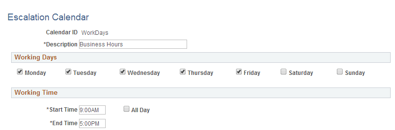

Escalations Calendar Setup page
Use the Escalation Calendar page (EOAW_CALENDAR) to define a custom calendar which can be used to define the timeout options in the Approval Process Setup page
Navigation:
Enterprise Components, and then Approvals, and then Notification and Escalations, and then Escalations Calendar Setup
This example illustrates the fields and controls on the Escalation Calendar page. You can find definitions for the fields and controls later on this page.
Escalation Calendar
Calendar ID
Enter a unique id for your calendar. When this field is not blank, The Timeout calculation will be based on the Calendar ID. When this field is blank, the timeout calculation will be based on the 24 hours, 7 days and will use the original functionality.
Description
Provide a description for the calendar
Working Days
Select the working days. The escalation timeout option will refer this to determine the timeout. At least 1 day should be selected.
Working Time
Select the working time. The escalation timeout option will refer this to determine the timeout. if All Day is chosen, then working hours will be taken as 24 hours.
