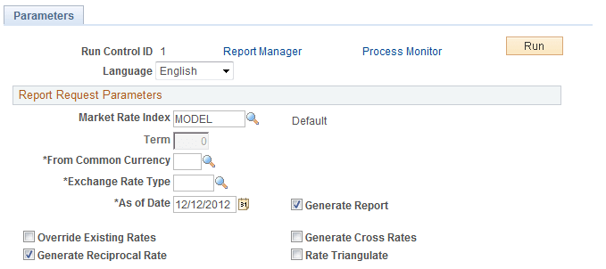

Calculate Cross/Reciprocal Rate - Parameters Page
Use the Calculate Cross/Reciprocal Rate - Parameters page (RUN_EO9030) to set run control parameters and run the EOP_RATECALC Application Engine process that calculates cross, triangulated, and reciprocal rates.
Navigation:
  • Set Up Financials/Supply Chain, and then Common Definitions, and then Market Rates, and then Calculate Market Rates
  • Set Up HCM, and then Foundation Tables, and then Currency and Market Rates, and then Calculate Cross/Reciprocal Rt
  • Set Up CRM, and then Common Definitions, and then Market Rates, and then Cross/Reciprocal Rate Calc
This example illustrates the fields and controls on the Cross/Reciprocal Rate - Parameters page. You can find definitions for the fields and controls later on this page.

Field or Control Description
Market Rate Index
Select a market rate index. Applications other than PeopleSoft Treasury should use the default index that you select for the exchange rate.
Term
This value defaults from the value entered on the Market Rate Definition page.
From Common Currency
Select a currency code to calculate a reciprocal rate.
Exchange Rate Type
Select the exchange rate type to use for this calculation.
As of Date
Select the effective date of the newly created exchange rates, which are the output of the process. The as of date also determines the rates used as the basis for the calculations, which are the input of the process.
The report uses the most current currency quotation method for the currency pair as the input to the process. If the as of date is the current effective rate on the specified date, it can affect triangulation. For example, a USD to EPC (euro participating currency) triangulated rate effective April 1, 2004 might be comprised of the EUR to USD rate also effective April 1, 2004 and the fixed EUR to an EPC rate effective on the date the newly participating EPC officially becomes a euro participating currency.
Generate Report
Select to generate a report that displays the cross, triangulated, and reciprocal rate calculations performed by the process.
Override Existing Rates
Select to have the calculated rates override rates for the exchange rate type, regardless of the as of date.
Generate Reciprocal Rate
Select to calculates reciprocal rates for currency pairs that do not have the Auto Reciprocate option select on the Currency Quotation Method page.
You can select this option alone, or in combination with the Generate Cross Rates and Rate Triangulate options.
This process does not directly manipulate the exchange rates. The system uses numerator and denominator values instead, such that the following is true:
(from-currency / RATE_DIV) × RATE_MULT = to-currency
Fro example, suppose you want a reciprocal rate between USD and CHF and assume a two-to-one ratio. If the exchange rate for USD to CHF is quoted directly (either using a direct quote method that you selected or using the system default), this rate is stored as RATE_MULT = 2 and RATE_DIV = 1. The rate is represented as 1 USD = 2 CHF, with a visual rate of 2.
In turn, the CHF to USD rate must be indirect. The reciprocal is a simple exchange, storing the rate as RATE_MULT = 1 and RATE_DIV = 2. The visual rate remains 2.
If quote methods are not being used, the CHF to USD rate must be quoted directly (the default), so the reciprocal rate is actually a calculated inverse. This rate is stored as RATE_MULT = 0.5 and RATE_DIV = 1, with a visual rate of 0.5.
In this example between USD and CHF, using a quote method and using a calculated inverse produced the same end result, 1/2 equals 0.5. But in actual practice, the manipulation of exchange rates is a major task and is one of the reasons for establishing the currency quote method.
Select to automatically generate cross rates. For example, to generate cross currency rates for USD, CAD, and MXP, you enter USD to CAD = 1.473 and USD to MXP = 9.8793. The system automatically generates CAD to MXP = 9.8793/1.473 = 6.7069246.
If you choose to generate cross rates, the From Cur (from-currency) and To Cur (to-currency) fields display and you must select a from-currency and a to-currency. You can enter a wild card of % in either or both fields to indicate from all or to all currencies.
Rate Triangulate
Select to convert two currencies through a third currency.
Select to convert two currencies through a third currency. If you select Rate Triangulate, the From Cur (from-currency) and To Cur (to-currency) fields display and you must select a from-currency and a to-currency. You can enter a wild card of % in either or both fields to indicate from all or to all currencies.
Quote Method Required
Select to indicate that you want the process to perform selected calculations only if the currency pairs have an existing currency quotation method definition.
