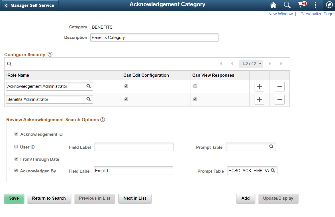

Acknowledgement Category Page
Use the Acknowledgement Category page (ESIGN_CATEGORY) to categorize acknowledgements as per business requirement and to control the access rights of users for a category of acknowledgements.
Navigation:
Enterprise Components, and then Acknowledgement, and then Acknowledgement Category
Add Acknowledgement Category page.

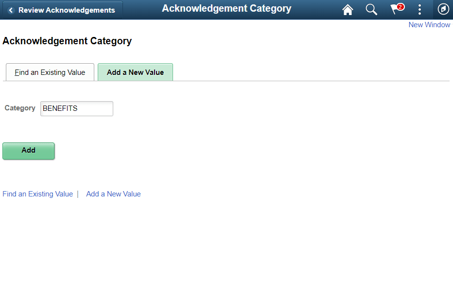

To add a new acknowledgement category, use the Add New value tab in the Acknowledgement Category search page.
Field or Control Description
Category
Add the Acknowledgement Category
Description
Add the Acknowledgement Category description.
Use the Configure Security section to set the user security for the acknowledgement category.
Role Name
Choose the user roles that need can access the acknowledgements in this acknowledgement category.
Can Edit Configuration
Select the check-box to allow users in this user role to edit the acknowledgement configuration.
Can View Responses
Select the check-box to allow users in this user role to view the acknowledgement responses.
Use the Review Acknowledgement Search Options section to configure the search options in the Review Acknowledgements page.
Acknowledgement ID
Select the check-box if the Acknowledgement ID field needs to be displayed in the Review Acknowledgements search page.
User ID
Select the check-box if the User ID field needs to be displayed in the Review Acknowledgement search page.
Field label
Enter the customized label for the User ID field.
Prompt Table
Select the table that is used to provide a prompt list when a user enters a value into the User ID search field in the Review Acknowledgement page..
From/Through Date
Select the check-box if the From and Through date needs to be displayed in the Review Acknowledgements search page.
Acknowledged By
Select the check-box if the search filter for users who have acknowledged needs to be displayed in the Review Acknowledgements search page.
Field Label
Choose the custom field label for the Acknowledged by field.
Prompt Table
Select the table that is used to provide a prompt list when a user enters a value into the Acknowledged By search field in the Review Acknowledgement page..

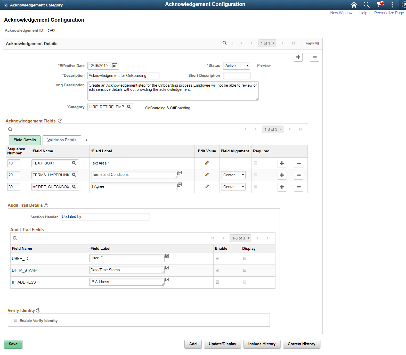

Acknowledgement Configuration Page
Use the Acknowledgement Configuration page (ESIGN_DTL) to create an Acknowledgement Configuration.
Navigation:
Enterprise Components, and then Acknowledgement, and then Acknowledgment Configuration
Users with the ‘Acknowledgement Administrator’ role will have access to the Acknowledgment Configuration page.
Acknowledgement Configuration page.
Acknowledgement Details
Acknowledgement ID
Displays the ID under which the configuration is saved. This value is entered as the Parameter Value in the Categories - Steps Page during the activity guide creation.
Note: A configuration created under an Acknowledgement ID can be updated only if it is not used in any activity guide instance.
Effective Date
Enter the effective date for this configuration.
Note: The Acknowledgment page, when used in an activity guide, is displayed based on the configuration effective as of the activity guide instance creation date. If an Acknowledgement configuration is already in use in an activity guide instance, then it is available only in the display mode and cannot be edited.
Status
Choose the appropriate value to indicate the status of the configuration. Available values are Active and Inactive.
Preview link
Click this link to preview the Acknowledgement page created based on the saved configuration. The preview is displayed in a new browser tab.
(Long and Short) Description
Enter descriptions to indicate the purpose of the Acknowledgement Configuration.
Category
Choose the category for this acknowledgement.
Acknowledgement Fields - Field Details
Sequence Number
Use the Sequence Number field to set the priority of the Acknowledgement fields, i.e. the order in which the fields are displayed in the Acknowledgement page.
This field must contain a unique value and the lowest number has the highest priority.
Field Name
Add fields to the configuration. The fields that can be added to the configuration are:
  • Agreement check box.
  • Date of Birth.
  • Check Box 1.
  • Display Name.
  • First Name.
  • Last Name.
  • National ID.
  • Postal Code.
  • Radio Button.
  • Terms and Conditions hyperlink.
  • Up to a maximum of three Text Box fields.
Field Label
Displays the default label of the field. This label can be edited.
Edit Text
Click the Edit Text icon to open the contents of text fields for Text Box, and Terms and Conditions link, in a Rich Text Editor. All changes to the content and formatting for these text fields, including text alignment, can be set from within the Rich Text Editor.
Field Alignment
Use the Field Alignment drop down to set the field alignments. Available values are: Default, Left, Right and Center.
Note: The Default field alignment is set as per PeopleTools standards.
Required
Select the Required check box to set a field as mandatory. Fields marked as Required cannot be left blank by the user.

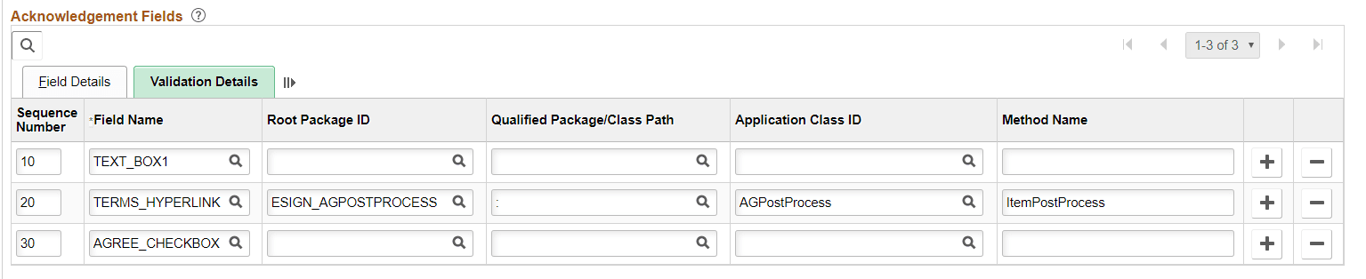

Acknowledgement Fields-Validation Details
Acknowledgement Fields Validation Details.
Root Package ID
Enter the Root Package ID for the field.
Qualified Package/Class Path
Enter the Class path for the field.
Application Class ID
Enter the Application Class ID for the field.
Method Name
Enter the Method Name for the field.
Audit Trail Details
Section Header
Use the Section Header field to enter a heading for the audit trail details displayed at the bottom of the transactional page. For example: Updated By.
Note: This field is required only when the user chooses to display any of the audit trail fields on the transactional page.
Audit Trail Fields
Field Name
By default, the User ID and the Date/Time Stamp values are stored in the database for all Acknowledgement transactions. Only the IP Address is optional.
Field Label
Displays the default field labels. You can edit this label.
Enable
Select the Enable check box to capture the corresponding field as part of audit trail.
Note: The Enable check box can be selected only for the IP Address field. It will then capture the IP address of the device from which a user saves the transaction.
The User ID and Date/Time Stamp fields are delivered as enabled and cannot be unchecked.
Display
Select the check box to display the corresponding field as audit trail on the transactional page.
Note: Audit Trail fields are displayed only if the Enable check box is selected.
Enable Verify Identity
Select this check box to enable user authentication when the user saves the Acknowledgement page.
The system will prompt the user for their PeopleSoft password when they save the Acknowledgement page.

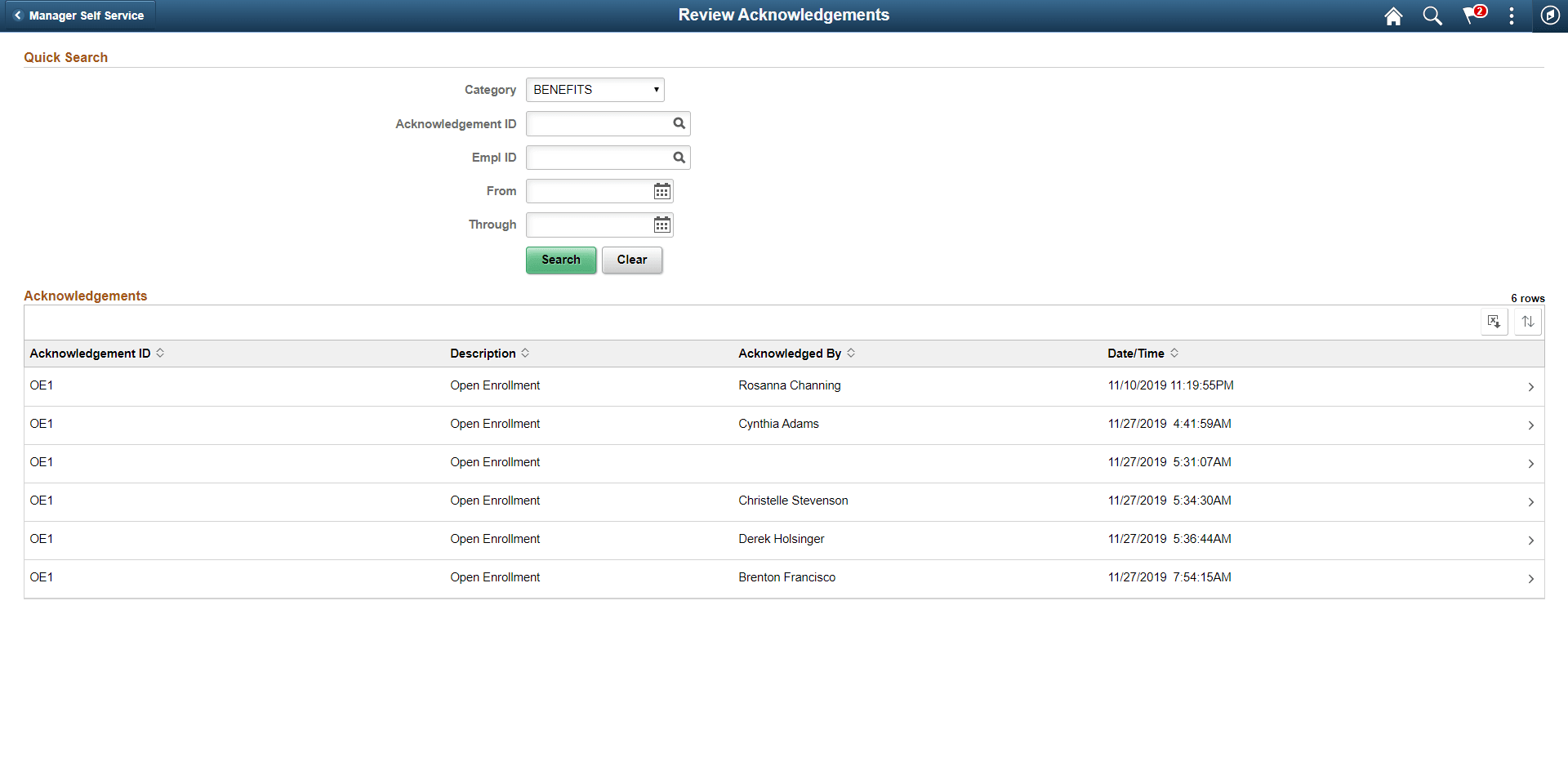

Review Acknowledgements Page
Use the Review Acknowledgements page (ESIGN_ADMIN_SUM_FL) to search for and review the acknowledgements.
Navigation:
Enterprise Components, and then Acknowledgement, and then Review Acknowledgements
Review Acknowledgements page for Admin user.
Category
Filter the search based on the acknowledgment category.
Acknowledgement ID
Filter the search based on an acknowledgment ID
Empl ID
Filter the search based on an employee ID
From
Filter the search based on a start date.
Through
Enter the end date for the period between which the acknowledgements were done.
More icon
Click the More button to view the details of the acknowledgement.
For more information, see the image highlights video on Acknowledge Framework Summary page.
Video: Image Highlights, PeopleSoft HCM Update Image 33: Acknowledgement Framework - Summary Review Pages

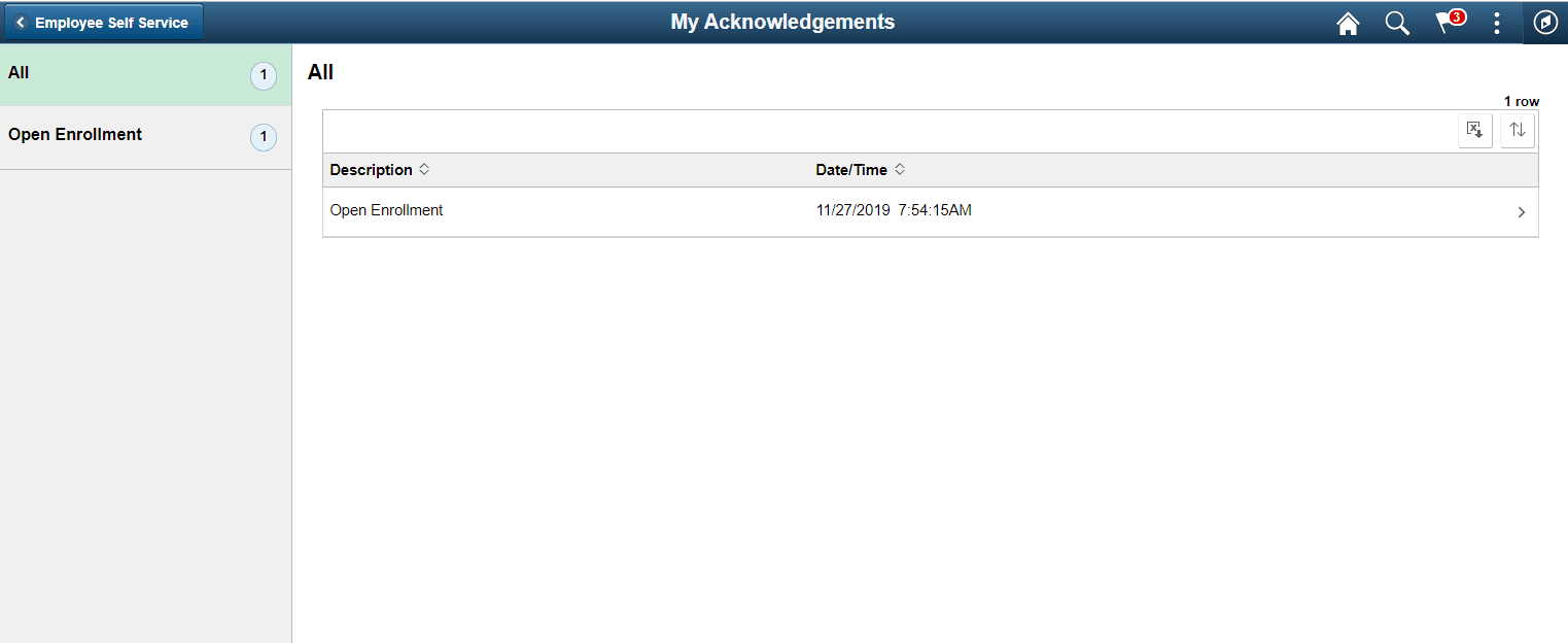

My Acknowledgements
Employees can use the My Acknowledgements tile in the Employe Self-Service home page to review acknowledgements that they did in the past.
