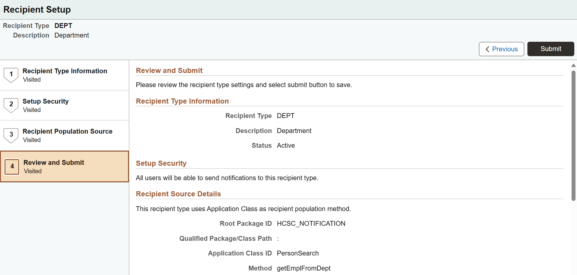

Review and Submit Page
HCSC_RCPNT_REVW_FL
Review recipient type settings prior to submission.

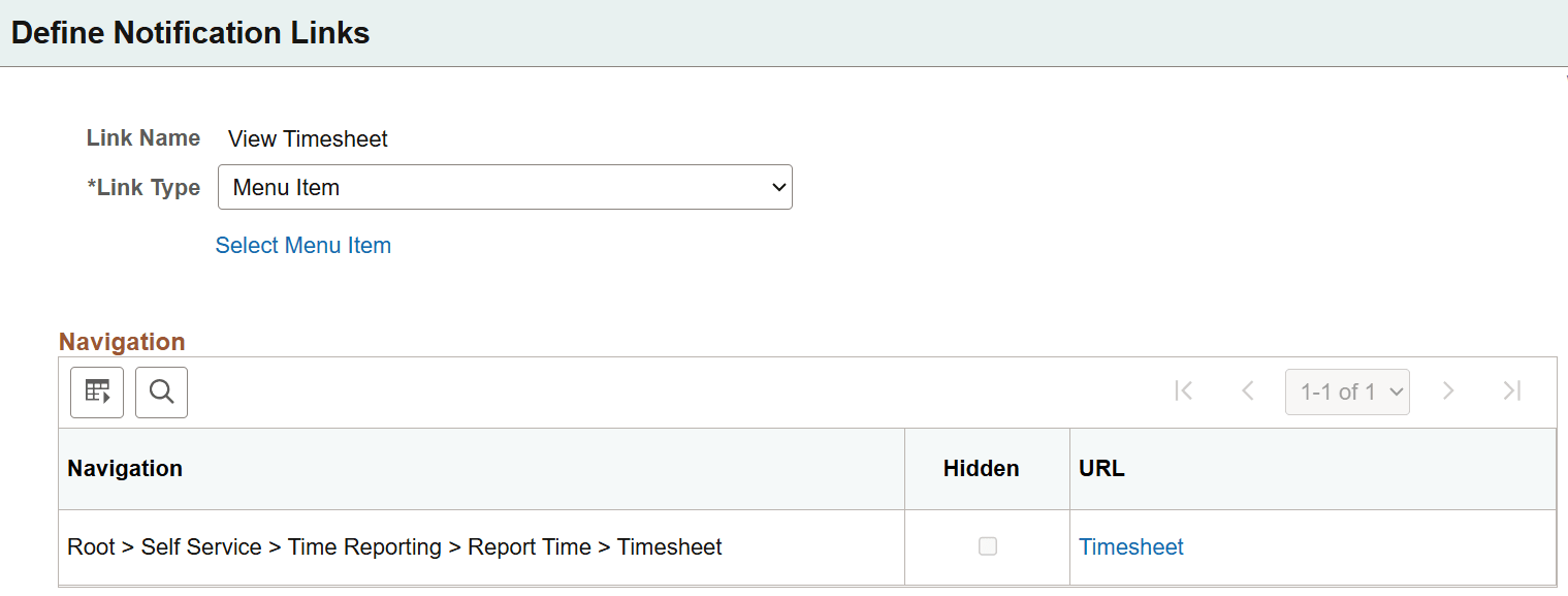

Define Notification Links Page
HCSC_LINK_SETUP
Set up links that can be included in notifications.

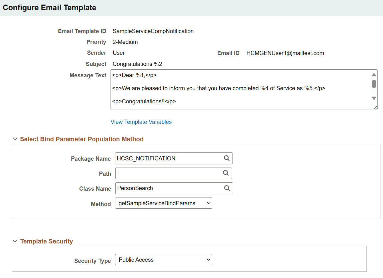

Configure Email Template Page
HCSC_NOTIF_TMPL
Configure PeopleTools generic templates for use in email notifications.

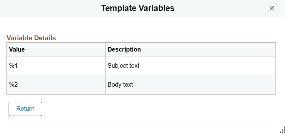

Template Variables Page (or Notification Variables Page)
HCSC_GEN_TMPL_VAR
Identify the variable values for the message text.

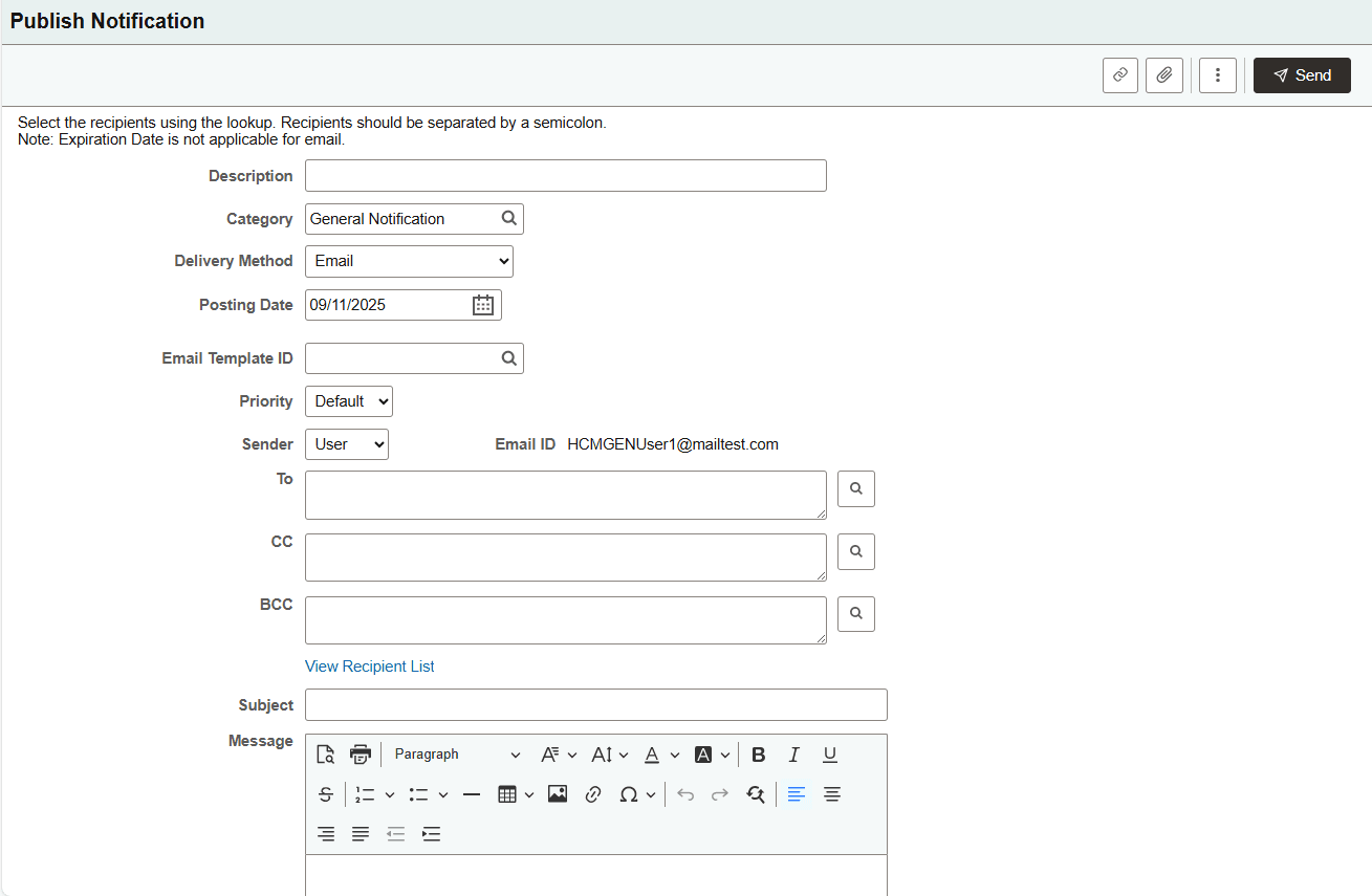

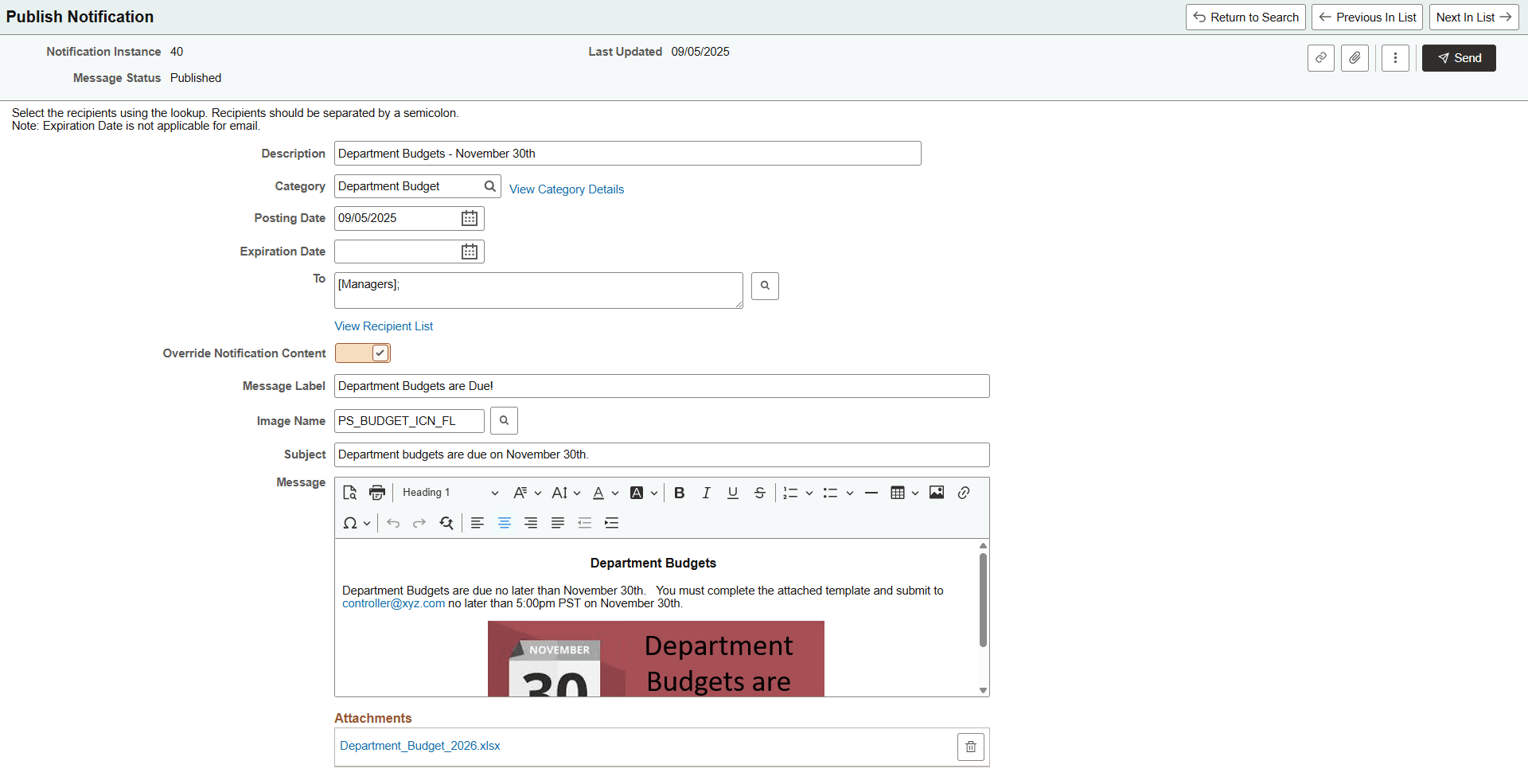

Publish Notification Page
HCSC_ADH_NOTIFY_FL
Compose and send notifications.

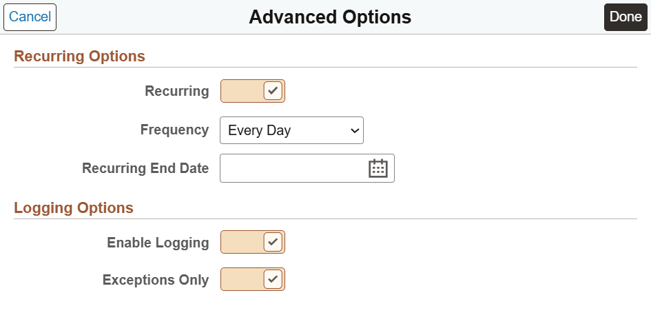

Advanced Options Page
HCSC_NOTIF_ADV_SCF
Specify options for future or recurring notifications.

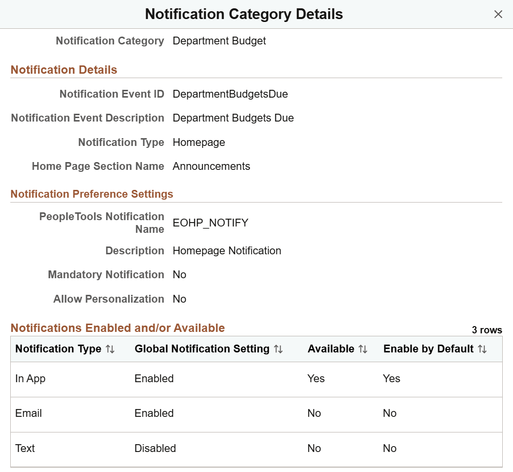

Notification Category Details Page
HCSC_CAT_NOTNC_SCF
View details of the associated notification event.

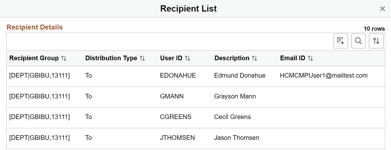

Recipient List Page
HCSC_RCPNT_LST_SCF
View recipients of the notification.

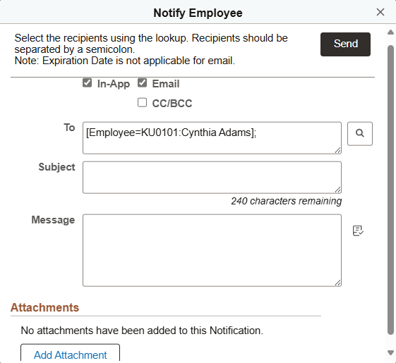

<Notification> Page (HCSC_NOTIF_ADH_FLU)
HCSC_NOTIF_ADH_FLU
Compose and send notifications using the fluid pages.
This page can be accessed from application pages via a related action or through a PeopleCode event.

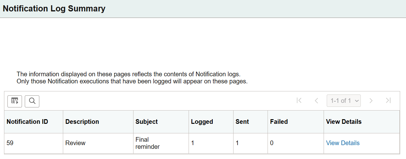

Notification Log Summary Page
HCSC_NOTIF_LOG_SUM
View notification logs.

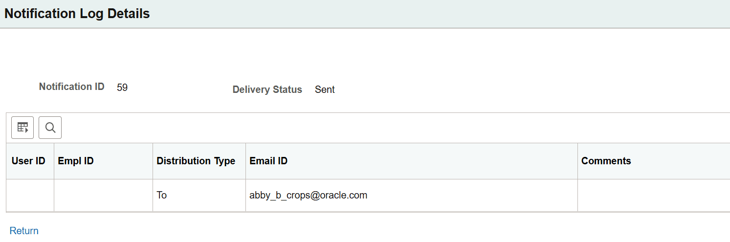

Notification Log Details Page
HCSC_NOTIF_LOG_DTL
View additional log information and comments of processed email notifications.

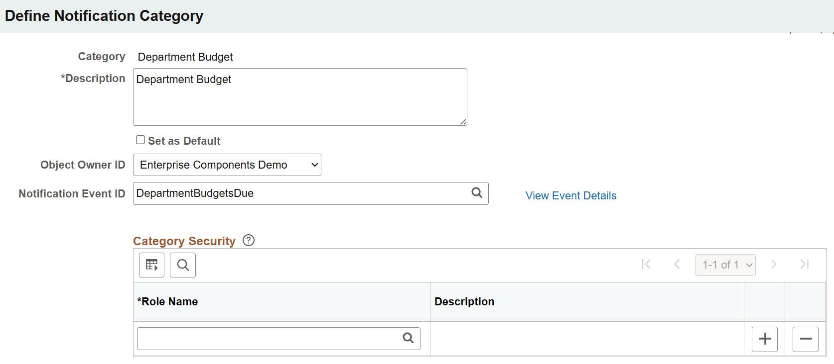

  4. Use the Define Notification Category Page to define notification groupings.
    A notification category must be selected for notifications to be sent on the Publish Notification Page.
    A notification category can be associated with a notification event in Notification Composer to publish notifications. When associated, the system uses the message content definition of the selected event to send notifications belonging to that category.
    As mentioned previously, the notification category used for notifications on the landing page must be associated with a notification event configured to use the Homepage notification type for in-app notifications.
    To publish an announcement in the Banner Announcement section of the landing page, use the Banner Announcement category. This category is used specifically for that section and is not associated with any notification event.

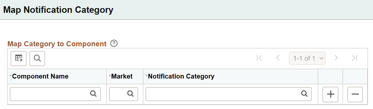

  5. (Optional) Use the Map Notification Category Page to associate notification categories with application components.
    This setup step uses the specified notification category as the default for notifications that are sent from the corresponding application component using Notification Publisher.
  6. (Optional) Use the Define Notification Links Page to set up links that can be embedded in notifications.
    This setup step enables users to include an embedded link in the notifications that they create.
  7. Use the Configure Email Template Page to configure PeopleTools generic templates.
    This setup step enables users to select a template to prepopulate content when they publish email notifications.
Users can create and send notifications on the Publish Notification Page, or from application components that use Notification Publisher.

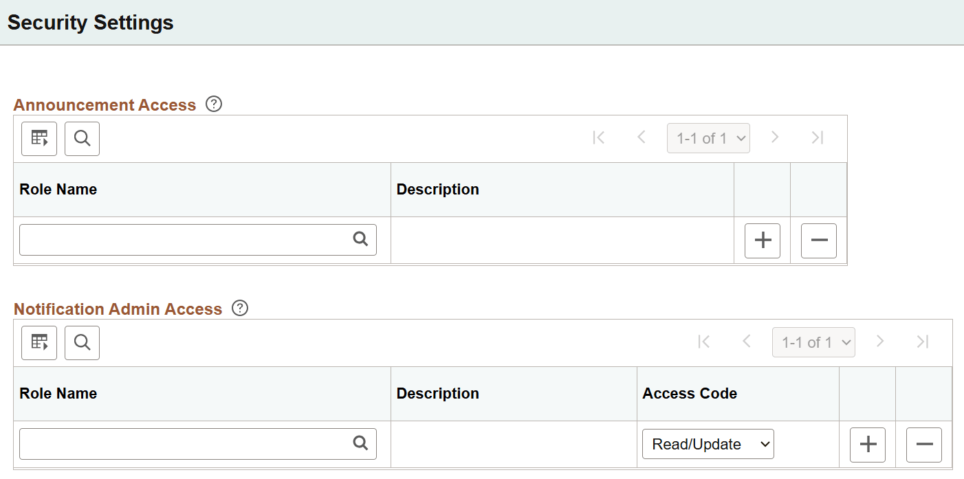

Security Settings Page
Use the Security Settings page (HCSC_NOTIF_INSTALL) to restrict user access for publishing announcements and viewing notifications published by others if needed.
Navigation:
Enterprise Components, and then Notification Composer, and then Notification Publisher, and then Security Settings, and then Security Settings
This example illustrates the fields and controls on the Security Settings page.
If you need to restrict who can publish announcements or view notifications created by other users, specify the corresponding user roles on the Security Settings page.
Use the Security Settings page to restrict users from publishing announcements using the "Announcement" or "Announcement and Email" delivery methods from the Publish Notification page, and from viewing notifications published by other users.
Announcement Access
Field or Control Description
Role Name
Specify the user role that allows publishing announcements using the Announcement or Announcement and Email delivery method on the Publish Notification Page.
If no roles are selected, all users are able to publish announcements.
Announcements are messages that can be posted to users' homepages, dashboards, or workcenters.
Notification Recipient Chunk Size
Chunk Size
Specifies the maximum number of recipients to process in a single batch or transaction when sending notifications. Smaller batches reduce system load and can improve notification delivery speed. The default value is 10000.
Notification Admin Access
Role Name
Specify the user role that can view or update notifications that are created by other users.
If no roles are selected, users will only have access to the notifications created by themselves.
Access Code
Select the access level, Read Only or Read/Update.

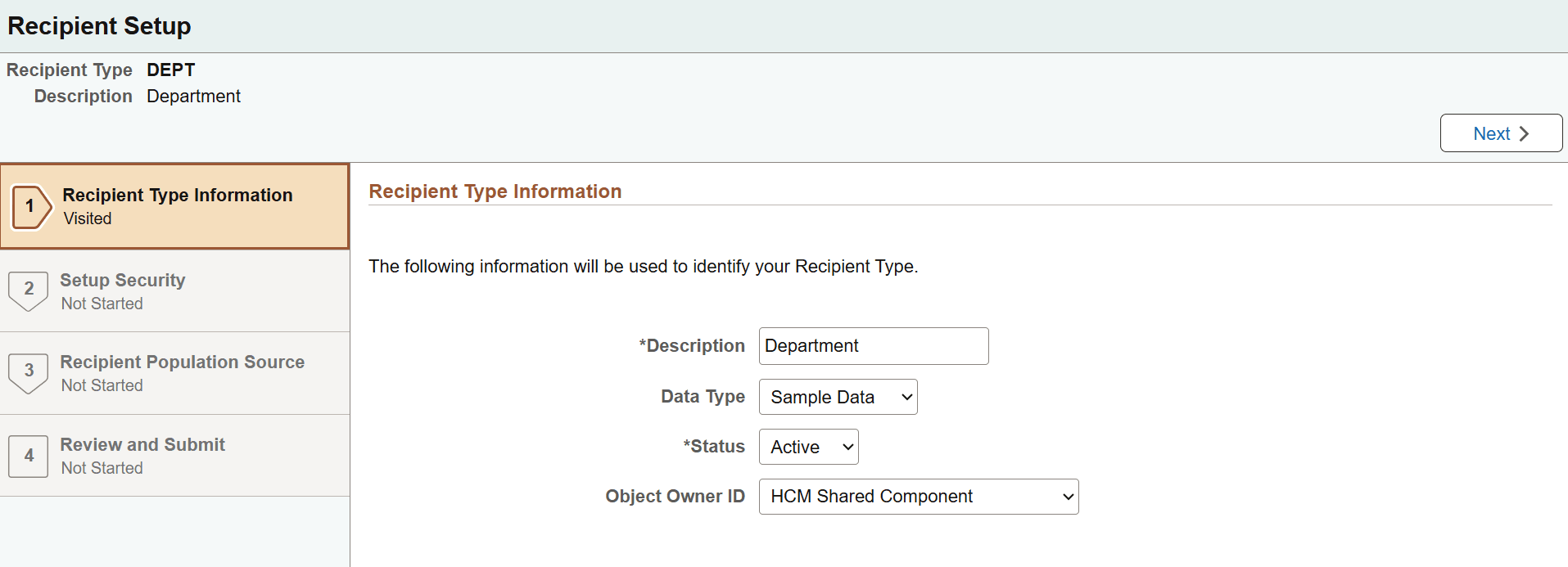

Recipient Type Information Page
Use the Recipient Type Information page (HCSC_RCPNT_GEN_FL) to enter general information about the recipient type.
Navigation:
Enterprise Components, and then Notification Composer, and then Notification Publisher, and then Define Recipient Type, and then Recipient Type Information
This example illustrates the fields and controls on the Recipient Type Information page.
Data Type
Specify if the recipient type is customer data, sample data, or system data.

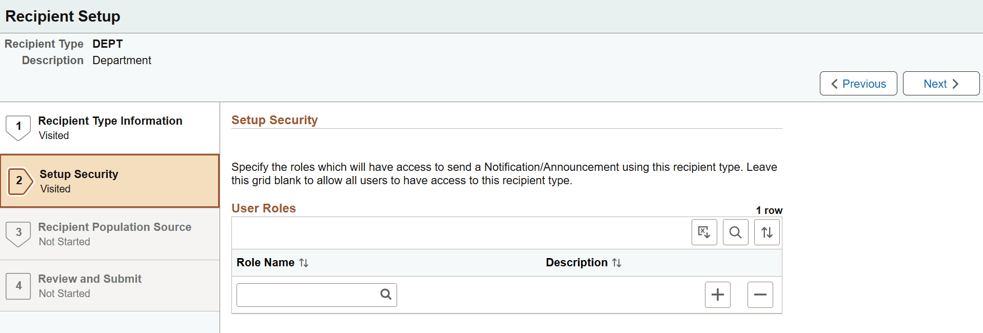

Setup Security Page
Use the Setup Security page (HCSC_RCPNT_SCRT_FL) to optionally specify roles of users who can use the recipient type.
Navigation:
Select the Next button on the Recipient Type Information Page.
This example illustrates the fields and controls on the Setup Security page.
Setup Security page
The system uses the user’s operator ID to validate role-based security for recipient type. When drafting notifications or announcements, only recipient types that have access to are available for selection.
Role Name
Specify the role of users who can use this recipient type to send notifications.
If no roles are selected, all users can use this recipient type.

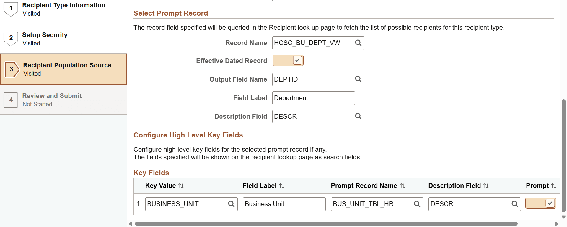

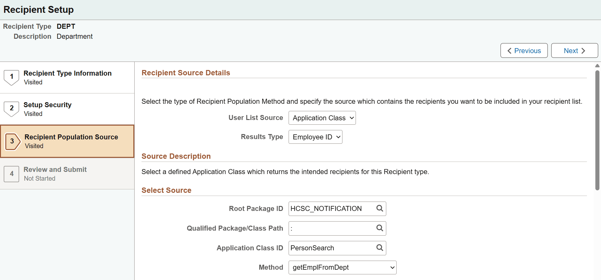

Recipient Population Source Page
Use the Recipient Population Source page (HCSC_RCPNT_SRC_FL) to define the recipient list population method.
Navigation:
Select the Next button on the Setup Security Page.
This example illustrates the fields and controls on the Recipient Population Source page (1 of 2).
This example illustrates the fields and controls on the Recipient Population Source page (2 of 2).
User List Source
Select the method used to resolve the list of intended recipients for the recipient type. Options are:
  • All Users
    Recipients are all users in the system.
  • Application Class
    This option is the most flexible way to define and implement recipient population.
    The Application Class method should return an array of string with valid EMPLIDs/USERIDs based on Results Type selection.
  • Query Based
    This option is an alternative of SQL Definition, if Application Designer access is not available.
    The QUERY output should be single column output, which returns valid EMPLIDs/USERIDs based on Results Type selection.
  • Role Based
    Use this option to create recipient types that are groups of people with the same role, for example, Payroll Administrator.
  • SQL Definition
    This option is useful for advanced implementers who want to populate their recipient lists through Application Designer SQL.
    The SQL output should be single column output, which returns valid EMPLIDs/USERIDs based on Results Type selection.
Before sending notifications or announcements, the AE program resolves (using the selected method) recipient types to get a list of intended recipients with their email IDs and User IDs.
Select Source
Fields in this section change based on the selected user list source. Enter additional information for the selected source.
If the selected user list source is:
  • SQL Definition, enter the SQL object identifier.
  • Role Based, enter the user role.
  • Query Based, enter the query.
  • Application Class, enter the application class, package, and method.
This section is not applicable to the All Users user list source.

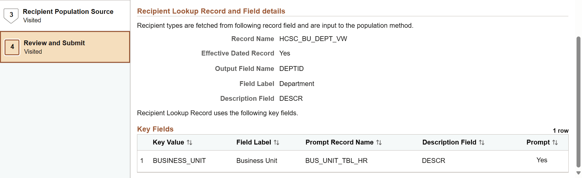

Select Prompt Record
Use this section to specify the record field to be shown and queried on the recipient lookup page (when composing notifications or announcements) to fetch the list of possible recipients for this recipient type.
This section is not applicable to the All Users and Role Based user list sources.
Key Fields
Use this section to configure high-level key fields for the selected prompt record, if any. Fields specified here will be shown as search fields on the recipient lookup page.
Key Value
Enter a key field to be displayed and used in recipient lookup as a search field. You can enter a maximum of four key fields.
The lookup limits the selection of key fields to those that belong to the record selected in the Select Prompt Record section.
Field Label
Displays the user defined label of the key field as default. The label can be edited, and is used as the key field label in the recipient lookup of the Publish Notification Page.
Prompt Record Name and Description Field
Enter the record to be used to fetch values of the key field, if prompt lookup for the key field is needed. Enter the description field name as well.
Prompt
Select to make the prompt lookup available to the key field in the recipient lookup.
This field is enabled only if record name and display name values are provided.
Use the Review and Submit page (HCSC_RCPNT_REVW_FL) to review recipient type settings prior to submission.
Navigation:
Select the Next button on the Recipient Population Source Page.
This example illustrates the fields and controls on the Review and Submit page (1 of 2).
This example illustrates the fields and controls on the Review and Submit page (2 of 2).
Select the Submit button to complete the recipient type configuration.
Use the Define Notification Category page (HCSC_CAT_SETUP) to specify groupings for notifications.
Navigation:
Enterprise Components, and then Notification Composer, and then Notification Publisher, and then Define Notification Category, and then Define Notification Category
This example illustrates the fields and controls on the Define Notification Category page.
Category
Displays or enter a notification category name.
Note: (For landing page) The system delivers the Banner Announcement category to be used for posting organization-wide announcements that appear in the Banner Announcement section of the landing page.
Set as Default
Select for this category to be used as the default value when users compose notifications on the Publish Notification Page.
The default notification category is General Notification.
When selected, the Category Security section is not shown and any associated security settings will be cleared.
Object Owner ID
Select the PeopleSoft application to which this category belongs.
Notification Event ID
Select a Notification Composer event for the category. This field is available when the feature is enabled in the system. Notification event ID is required for categories that are used for notifications that appear in dynamic landing page sections, such as Announcements.
The system uses the message content definition of the selected event to send notifications belonging to the category.
A notification event ID can be defined automatically while creating a new notification. For more information, see the Add New Notification Page topic for Notification Composer.
Note: Although notification event IDs from both Application Notification and Notification Publisher sources are available for selection, it is recommended to select an event from the Notification Publisher source. For notifications to be published in landing page sections (with the exception of the Banner Announcement section), the selected notification event must be configured to use the Homepage notification type for in-app notifications. Notification event is not required for publishing banner announcements.
Category Security
Role Name
Specify roles that will have access to this category.
If no roles are added, all users are able to access this category.
Use the Map Notification Category page (HCSC_CAT_COMP_TBL) to associate notification categories to fluid components for sending notifications.
Navigation:
Enterprise Components, and then Notification Composer, and then Notification Publisher, and then Map Notification Category, and then Map Notification Category
This example illustrates the fields and controls on the Map Notification Category page.
Component Name
Enter a fluid component that uses Notification Publisher to send notifications using a modal window.
Market
Select a market.
Enter a notification category to be used for sending notifications by the component. For example, if the notification category is associated with a notification event from Notification Composer, the system uses setup from that notification event to send notifications.
If no category is mapped, the default category will be used.
Use the Define Notification Links page (HCSC_LINK_SETUP) to set up links that can be included in notifications.
Navigation:
Enterprise Components, and then Notification Composer, and then Notification Publisher, and then Define Notification Links, and then Define Notification Links
This example illustrates the fields and controls on the Define Notification Links page.
Link Type
Select the type of the embedded link you are creating. Options are:
  • Menu Item
  • URL
URLs
Enter the URL.
This field appears if the selected link type is URL.
Select Menu Item link
Use this link to select a content reference from the tree structure on the Select a Content Reference page (HCSC_CRFURL_SELECT) for the menu item.
Navigation
This section lists (if applicable) the navigation path of the selected menu item.
URL link
Select to access the page that recipients go to when they click this embedded link from the notifications they receive at runtime.
Use the Configure Email Template page (HCSC_NOTIF_TMPL) to configure PeopleTools generic templates for use in email notifications.
Navigation:
Enterprise Components, and then Notification Composer, and then Notification Publisher, and then Configure Email Template, and then Configure Email Template
This example illustrates the fields and controls on the Configure Email Template page.
Subject
Displays the subject of the PeopleTools generic template.
For more information about PeopleTools generic templates, refer to PeopleSoft: Workflow Technology: "Using Notification Templates," Defining Generic Templates.
Message Text
Displays the message text of the PeopleTools Generic Template.
View Template Variables link
Select to view the description of the bind values used in the Subject/Message Text. This link will be available only if Subject or Message Text has bind values.
Select Bind Parameter Population Method
Enter the application package, class and method to resolve the list of bind parameters.
The Application Class method should return an array of string with values for an EMPLID. Before sending notification, the AE program resolves bind parameters using the selected method with the values.
Package Name
Select an application package.
Path
Select the qualified package or path of the application package.
Class Name
Select the class name of the application package.
Method
Select the method to be executed to resolve bind parameters.
Template Security
Security Type
Select security access of the template:
Public Access: All users have access.
Security Access: Users of specific roles have access.
Role Name
Specify the role of users who can use this template to send email notifications.
This field appears if the selected security type is Security Access.
Use the Template Variables or Notification Variables page (HCSC_GEN_TMPL_VAR) to identify the variable values for the message text.
Navigation:
This example illustrates the Template Variables page.
Use the Publish Notification page (HCSC_ADH_NOTIFY_FL) to compose and send notifications.
Navigation:
Enterprise Components, and then Notification Composer, and then Notification Publisher, and then Publish Notification, and then Publish Notification
This example illustrates the fields and controls of the Publish Notification page that is used to create a new notification.
Publish Notification page (new notification)
This example illustrates the Publish Notification page with a published notification displayed in a landing page section.
Publish Notification page (published notification that is displayed in a landing page section)
Use this page to compose and publish notifications. On the search page, you can find a list of notifications that have been delivered or are scheduled to deliver to recipients.
Recipient Types using PS Query populates recipients based on the Query Security and Query Security Record associated with the Records in PS Query.
If the notifying user has access to PS Query and if the PS Query is joined with the Query Security Record, then the recipients are retrieved based on the security enforced.
Notification Instance
Displays the system-generated ID for the notification. Not applicable to new notifications.
Message Status
Displays the status of the notification. Values can include Published, Dismissed, and Ready To Send. Not applicable to new notifications.
Add Link button
Select to access the Select Link page (HCSC_NOTIF_LIN_SCF) and select an embedded link to add to the notification as needed.
Embedded links are defined on the Define Notification Links Page.
Add Attachment button
Select to access the File Attachment page and upload a file attachment to the notification as needed.
More Actions button
Select to perform one of these actions:
Advanced Options: Select to access the Advanced Options Page to specify options for recurring notifications and logging.
Dismiss: Select to remove published notifications of this notification instance so that recipients can no longer view or access them. This option is not applicable to email notifications.
Delete: Select to remove this notification instance from the system. If you are drafting the notification, select this option to clear all of its content.
Send
Select to trigger the notification process (HCSC_NOTIFY) to publish the notification to recipients.
If the notification has a future posting date, it is saved and will be sent on the posting date.
The Process Monitor link appears in the confirmation message, allowing you to view the status of the notification process.
Description
Enter a description for the notification.
Category
Displays the default category or select a category for the notification.
Categories are defined on the Define Notification Category Page.
Note: (If landing page is used) To post an organization-wide announcement notification in the Banner Announcement section of the landing page, use the Banner Announcement category. Only one announcement appears in this section. If there are multiple banner announcements, the one with the highest priority and most recent posting date is displayed.
View Category Details link
Select to access the Notification Category Details Page to view details about the Notification Composer notification event that is associated with the selected category.
This link appears when the selected category is associated with a notification event ID in the category definition. Notification Publisher uses the message content definition of that notification event to send notifications.
Delivery Method
Select how the notification will be delivered to intended recipients.
Note: The Delivery Method field is not shown if the selected category is associated with a notification event ID. In this case, the system uses the delivery method information that is defined in the associated notification event in Notification Composer to send the notification.
Options include:
  • Announcement: Select to post the notification as an announcement on the Announcements Tile.
  • Announcement and Email: Select to post the notification to the Announcements Tile, and send it to recipients as an email.
  • Email: Select to send the notification as an email to recipients.
Note: To send in-app notifications from this page, select a category that is associated with a notification event configured for in-app notifications.
Posting Date
Select the date to send the notification to intended recipients. Future notifications are saved and will be sent on the specified future date.
Note: Do not enter a past date as the posting date.
Expiration Date
Specify the date when the notification expires and no longer shows.
This field is not applicable to email notifications.
Recipients can dismiss this announcement
Select to give recipients the option to dismiss the announcement notification from the Announcements Page if needed.
This field is available if the delivery method includes Announcement.
Email Template ID
Specify the email template to be used for the notification if needed. Information from the template is populated to the Priority, Sender, Subject and Message Text fields automatically.
This field is available if the delivery method is Email.
Priority
Specify the priority for the notification.
This field is not shown if the selected notification category is associated with a notification event ID.
Sender and Email ID
Specify the sender and email address.
This field is available if the delivery method includes Email.
To, CC, and BCC
Select recipients for the notification using the Recipient lookup button. For example, select System Wide Distribution to display notice in the Banner Announcement section for everyone in the organization.
On the Select Recipients page, select a recipient type and enter search criteria in the respective search fields.
The user can see and select the recipient types to which he or she is given access when drafting notifications.
CC and BCC fields are not applicable if the selected delivery method is Announcement, or if the selected notification category is associated with a notification event.
See also Setup Security Page.
View Recipient List
Select this link to access the Recipient List Page to preview the list of selected recipients for the notification.
Override Notification Content
Select to not use the subject and message text from the associated notification event and enter your own content.
This option appears when the selected category is associated with a notification event ID in the category definition.
When selected, the Notification Content Details section is no longer displayed. Additionally:
  • (For Alert and Actionable in-app notification types) The Subject and Message fields become editable.
  • (For Homepage in-app notification type)The Message Label, Image Name, Subject, and Message fields become editable.
Subject
Displays or enter the subject of the notification.
For email-only notifications, the subject that comes from the email template is read only.
Message
Displays or enter the content of the notification in the rich text editor.
For email-only notifications, the message text that comes from the email template is read only.
This section displays the notification subject and message texts of the Notification Composer event that is associated with the selected category. This content can be overridden using the editable fields that appear subsequently.
Link List
This section, if displayed, lists the embedded link that is added to the notification.
Use the Advanced Options page (HCSC_NOTIF_ADV_SCF) to specify options for recurring notifications.
Navigation:
Select the More Actions button and then select Advanced Options on the Publish Notification Page.
This example illustrates the fields and controls on the Advanced Options page.
Recurring Options
Additional Frequency values (Custom Days and Every Quarter) and the Publication Day and Dismissal Day fields are available starting with HCM Update Image 55.
Recurring
Select to mark the notification as recurring.
Frequency
Select the frequency of the recurring notification.
Options are:
  • Custom Days
  • Every Day
  • Every Month
  • Every Other Month
  • Every Other Week
  • Every Quarter
  • Every Week
Publish Every (In Days)
Enter the interval, in days, at which the notification should be sent. For example, enter 3 to publish the notification every three days. This field appears if the selected frequency is Custom Days.
Dismissal After (In Days)
Specify the number of days after publication when the notification should be automatically dismissed. The notification will no longer be visible after this period. This field appears if the selected frequency is Custom Days.
Publication Day
Select the specific day of the week, month, or quarter when the notification should be sent. This field is not visible if the selected frequency is Custom Days or Every Day.
Note: If the user selects the last date of the month, the system assumes that the user intends to send the notification at the end of every month. For example, if 31st is selected, the system sends the notification on the 31st of January, 28th or 29th of February, 31st of March, 30th of April and so on.
Dismissal Day
Select the specific day of the week, month, or quarter when the notification should be automatically dismissed. This field is not visible if the selected frequency is Custom Days or Every Day.
Recurring End Date
Enter the date when the delivery of the recurring notification ends.
Logging Options
Enable Logging
Select to enable logging. Log information is stored in HCSC_NLOG_TBL record.
Note: Logging is available to email notifications only.
Exceptions Only
Select to log only exceptions.
This field becomes editable when the Enable Logging field is selected.
Use the Notification Category Details page (HCSC_CAT_NOTNC_SCF) to view details of the associated notification event.
Navigation:
Select the View Category Details link on the Publish Notification Page.
This example illustrates the fields and controls on Notification Category Details page.
This page is available only if the selected notification category is associated with a notification event on the Define Notification Category Page. It displays details of the notification event in Notification Composer, such as preference settings, and availability by notification type.

Recipient List Page
Use the Recipient List page (HCSC_RCPNT_LST_SCF) to view recipients of the notification.
Navigation:
Select View Recipient List link from the Publish Notification Page.
This example illustrates the fields and controls on the Recipient List page.
Recipient List page
Recipient Details
If you select System Wide Distribution as the recipient type, the system displays an informational message that the notification will be sent to all unlocked users. In this scenario, the Recipient Details section does not appear.
If more than 300 recipients are identified, the system displays an informational message with the total recipient count. For performance reasons, the Recipient Details section shows only the first 300 recipients. To obtain the full list, select the Download button to download the complete recipient list.
Recipient List
Select to export the complete list of recipients to an xlsx file.
Use the notification modal page (HCSC_NOTIF_ADH_FLU) to compose and send notifications from fluid application pages.
Navigation:
Select the Related Actions icon next to an individual's name on fluid pages and select a notification action, such as Notify Employee or Send Notification in HCM.
This notification functionality is available as a Related Content Service (Service ID: EONC_NOTIFY_RECIPIENTS), and can be configured as a related action on any fluid application page. The title of this modal page is configurable in the related action setup.
To access this page, the user profile should be associated with role Notification Publisher User.
This example illustrates the fields and controls on the Notify Employee page that is available from the My Team page in HCM.
Select the type of notification to be delivered to intended recipients. You can select In-App, Email, or both.
In-App and Email
Select to send in-app, email, or both types of notifications to recipients.
Note: The In-App and Email delivery method options are not available on the notification modal page, if either the category that the fluid application page is mapped to on the Map Notification Category Page or the default category of the system is associated with a notification event in the category definition. The system uses the delivery method information from the associated notification event to send the notification.
CC/BCC (carbon copy/blind carbon copy)
Select this option to show the CC and BCC fields to copy other individuals on the email notification.
This check box appears when you select Email as a delivery method.
To, CC, or BCC
Select recipients for the notification using the Recipient lookup icon.
On the Recipient Lookup page, enter search criteria in respective search fields.
Subject
Enter the subject of the notification.
Message
Enter the content of the notification.
Select to access the File Attachment page and upload a file attachment to the notification.
Send button
Select to send the notification. This triggers the HCSC_NOTIFY process to send notifications (in-app, email, or both) to intended recipients.
A copy of the notification is available for review on the Publish Notification Page.
Use the Notification Log Summary page (HCSC_NOTIF_LOG_SUM) to view notification logs.
Navigation:
Enterprise Components, and then Notification Composer, and then Notification Publisher, and then Email Notification Logs, and then Notification Log Summary
This example illustrates the fields and controls on the Notification Log Summary Page.
If an email notification is composed and sent with the logging option enabled, log results are displayed on the Notification Log Summary page. You can enable logging for all emails or just the failed attempts.
View Details
Select this link to access the Notification Log Details Page to view the notification log details.
Use the Notification Log Details page (HCSC_NOTIF_LOG_DTL) to view additional log information and comments of processed email notifications.
Navigation:
Select the View Details link on the Notification Log Summary Page.
This example illustrates the fields and controls on the Notification Log Details page.
