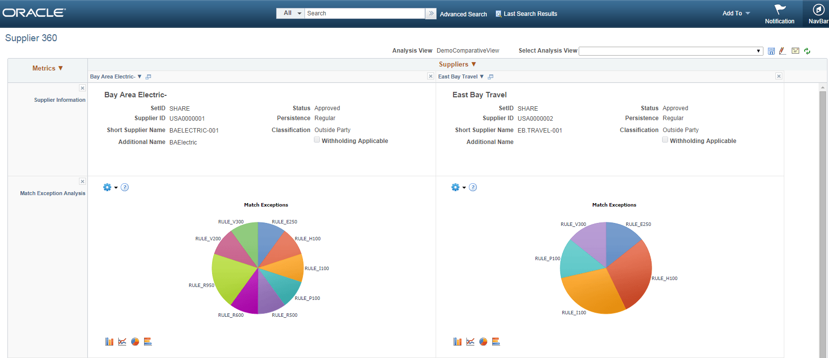

Analysis Display Page (Comparison Mode)
Use the Analysis Display page (Comparison Mode) (CAF_DISPLAY) to compare data for multiple entities in a tabular or grid format.
This example illustrates the fields and controls on the Analysis Display Page (Comparison Mode) (1 of 2).
CAF - Comparative Display 1 of 2
This example illustrates the fields and controls on the Analysis Display Page (Comparison Mode) (2 of 2).
CAF - Comparative Display 2 of 2
The comparison mode has three primary areas:

Entity Header Area (comparison mode)
The entity header is located across the top of the Analysis Display page (CAF_DISPLAY), when in comparison mode. The first row of the entity header displays the entity selected on the Entity Configuration Page.
This example illustrates the Entity Header (Comparison Mode - row 1).
CAF - Compare Mode - Entity Header row 1
Users can click the drop down arrow next to the entity to select these options:

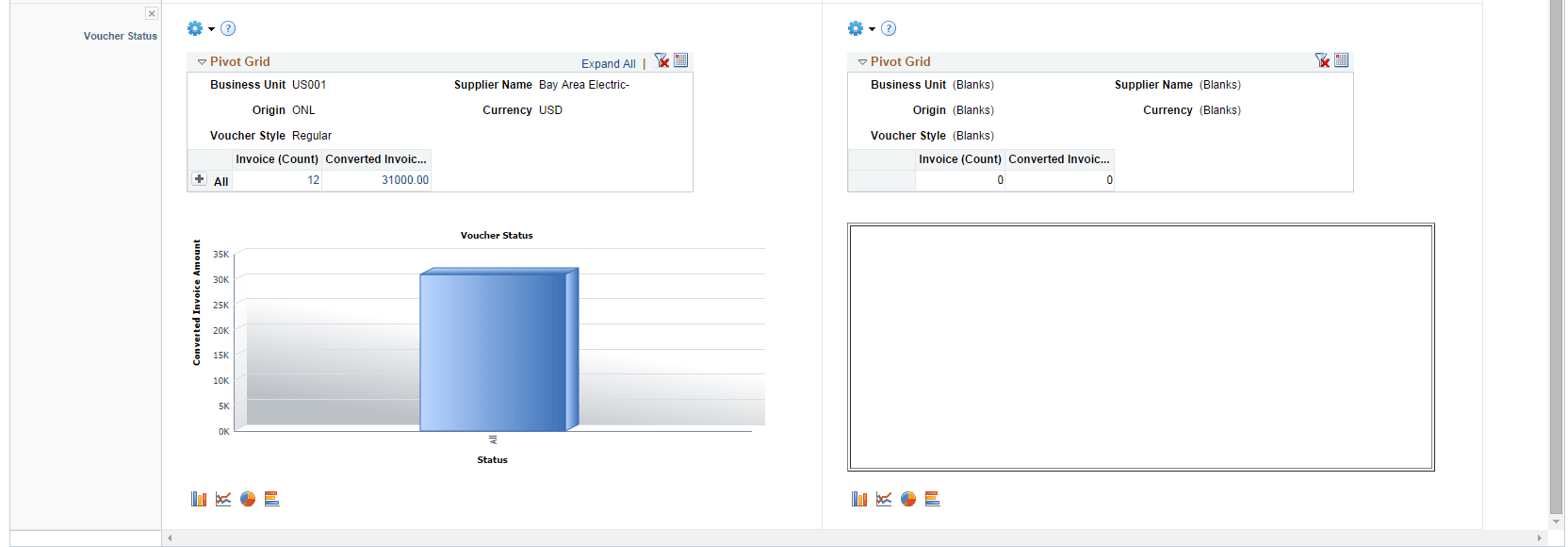

Factor Data Area (comparison mode)
The factor data is located on the center of the Analysis Display page (CAF_DISPLAY), when in comparison mode. The factor data is displayed in a cell, which combines the entity in the Entity Header and the factor in the Factor Header.
Field or Control Description
(More drop down)
Click the More drop down to select related actions. Each factor data cell can have factor related actions, which are determined from the factor handler or the Related Action Configuration Page.
(Action button)
Click the Action button to access embedded related actions for the factor data.

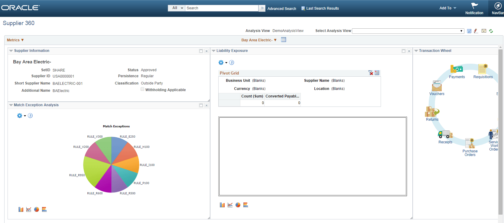

Analysis Display Page (Analysis Mode)
Use the Analysis Display page (Analysis Mode) (CAF_DISPLAY) to analyze data for one entity.
This example illustrates the fields and controls on the Analysis Display page (Analysis Mode).
CAF - Analysis Display
The analysis mode has two primary areas:
  • The Entity Header area is shown across the top of the page.
    It shows the entity and related actions.
  • The Factor Data area is shown in the largest part of the page.
    It shows the factor data for the entity. Factors can be added, removed, resized, repositioned, minimized, and maximized by the user.
Entity Header Area (analysis mode)
The Entity Header area displays entity information and actions that allow the user to access the factor related actions.
This example illustrates the Entity Header Options when in analysis mode.
CAF - Analysis Mode - Entity Header Options

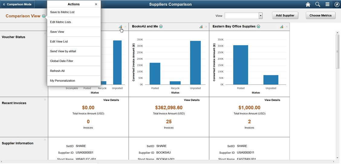

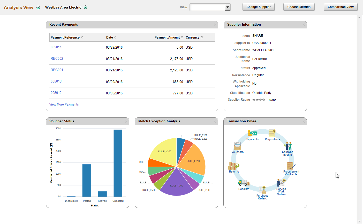

Understanding Configurable Analysis Framework for Fluid Implementations
Use the CAFNUI_DISPLAY_FL page to view and interact with comparison and analysis data in Fluid implementations. This page supports only Comparison Mode. Comparison mode and analysis mode has some similarities and some differences.
The following steps need to be followed while implementing Fluid Configurable Analysis Framework:
  1. Register the CAFNUI_DISPLAY_FL component in a new menu. Leave the search record as Installation.
  2. Create a Content Reference in an existing or new Fluid Page referring to the Menu/Component pair mentioned in the previous step.
  3. Specify the menu in this field.
The Fluid Analysis Display is resized automatically when the browser window size is changed. User can add/remove/rearrange entities and factors in any way they desire. Please note that there might be potential performance issue if user selects too many entities and/or factors.
Common Elements for Comparison and Analysis Modes in Fluid Implementations
These are the common elements that are available in both modes:
View
This drop-down allows user to switch between saved views.
Choose Factors
Allows adding and removing of factors for comparison or analysis.
Choose Metrics
The selector Individual Factor/Factor Group switches between:
  • Individual Factor(select/remove factorindividually.
  • Factor Group (replace all factors with a set of factor or a factor list.

Fluid Analysis Display Page (Comparison Mode)
Use the Analysis Display Page (CAFNUI_DISPLAY_FL) in Fluid implementations to compare different entities.
The items specific to Comparison mode are:
Comparison Title
Name of the comparison.
Add Entity
Allows adding and removing entities to the comparison.
Analysis Mode
Transfer to the Analysis mode, and the entity will be analyzed in Analysis mode.
Remove Factor
Allows removing the entire row of a factor or the entire column.
Flagged Entity Indicator
If the entity has been flagged, this flag is placed before this entity. If the user clicks at Analysis Mode icon for this Entity, this entity will show up as flagged in Analysis Mode. If the user unflags this entity in Analysis Mode, and navigates to Comparison Mode, it will show up unflagged in Comparison Mode.
Fluid Analysis Display Page (Analysis Mode)
Use the Analysis Display Page (CAFNUI_360_FL) in Fluid implementations to Analyze an entity.
The Analysis Mode allows user to concentrate on one entity by displaying factors for only one selected entity. It is displayed in the Entity Header area. The Factor Data area displays factor data for the entity. The factors can be added, removed or moved, by the user
The items specific to Analysis mode are:
Analysis Title
Name of the analysis.
Change Entity
Allows changing the entity spotted in Analysis Mode.
Remove factor
Allows removing a factor from the Analysis Mode page.
Comparison View
Transfer to the Comparison mode. The Entity currently displayed in Analysis Mode is not automatically added to Comparison mode.
If the entity has been flagged, this flag is placed before this entity. If the user clicks on Comparison View and this entity was already placed at Comparison Mode, this will show up as flagged in Comparison Mode. If the user unflags this entity in Comparison Mode and navigates back to Analysis Mode, it will show up unflagged in Analysis Mode.
Remove Entity
Allows removing an entity from the Analysis mode page.
