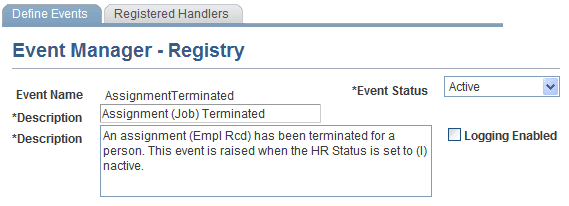

Define Events Page
Use the Define Events page (EOEN_EVENT_REG) to register the business events that you want to be able to raise within the Event Manager framework.

This example illustrates the fields and controls on the Define Events page. You can find definitions for the fields and controls later on this page.
Define Events page
Field or Control Description
Event Name
The system displays the name of the business event that you want to be able to raise within the Event Manager framework. If you are adding a new business event, enter the name of the event when accessing the component through the Add mode.
Event Status
Select whether the status of the event is Active or Inactive. The system only raises events in the local database that are active. Note that the system ignores inactive events that are raised in remote databases.
Description and (Long) Description
Enter a short and long description of the business event. The system uses the short description in search pages. You should provide enough detail of the business event in the long description so that anyone accessing the event knows what it represents.
Logging Enabled
Select to have the system write a row to a log table for each instance of this event. The system writes to the log each time that this event is raised in the local database. For events that are raised in remote databases, the system writes to the local log each time it receives a generic event message for this event.

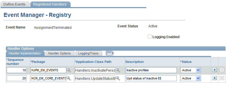

Registered Handlers Page
Use the Registered Handlers page (EOEN_EVENT_REG2) to register event handlers to the selected business event.
The Event Manager framework executes event handlers according to the rules that you specify on this page whenever it receives notification that the specified type of event has been raised.

Select the Registered Handlers tab.
This example illustrates the fields and controls on the Registered Handlers page, Handler Implementation tab. You can find definitions for the fields and controls later on this page.
The number of different events to which you can register a particular event handler is not restricted.
Sequence number
Enter a number to indicate the sequence in which the system executes the registered handlers when this event is raised. The execution sequence is important when more than one event handler is registered to an event.
Note: The sequence of event handler execution is relative to other event handlers that are operating in the same mode, either synchronous or asynchronous.
Sys Data (system data)
If this check box is selected, then PeopleSoft Human Resources delivers the event handler registration for this event as system data. You should not modify this system data unless PeopleSoft Human Resources instructs otherwise.
Package
Select the root application package that contains the application class for the event handler. The application class can reside within any application package; however, the application class must reside under a sub-package named Handlers.
Application Class Path
Select the application class that implements the event handler. The system displays as possible values all application classes that reside within the selected package as part of the Handlers subpackage.
Description
For information purposes, enter a short description of what the event handler does.
Status
Select whether the status of the event handler is Active or Inactive. The system executes event handlers that are in Active status only when this event is raised.
