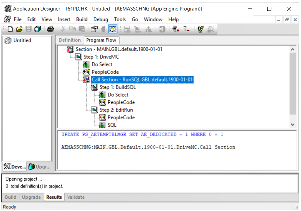

    You can identify the configured SQL, PeopleCode, or Call Section action by a red flash on its icon.
    This image shows the configured actions with a red flash icon.
    Configured AE action
On the code (lower) pane:
  • The additional code is highlighted in blue.
  • The original code or action from the plugged action appears in black.
  • Replacement code or actions are in red and the code being replaced is in strikethrough.
The codes are displayed based on the order of execution defined in the PIA.

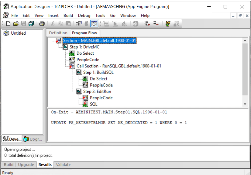

You can verify the configured On-Exit Application Engine plug-in in the Application Designer.
This example shows an On-Exit Application Engine plug-in configured in the Application Designer.

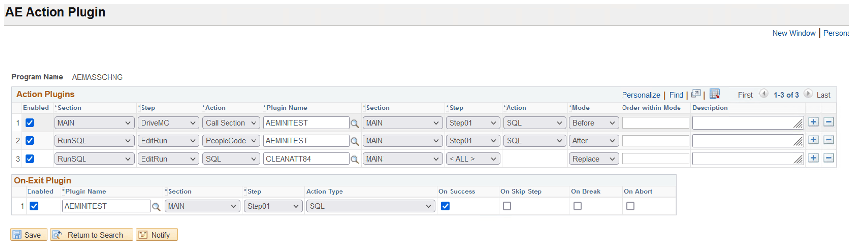

Use the AE Action Plugin page to configure Application Engine action plug-in and On-Exit Application Engine plug-in.
This example illustrates the fields and controls on the AE Action Plugin page. You can find definitions for the fields and controls later on this page.
Use these configuration options to configure a delivered Application Engine program:
Field or Control Description
Enabled
Select this check box to enable the configuration.
Section
Select a section of the delivered Application Engine program, which you plan to configure. Only sections with steps having SQL or PeopleCode are listed.
Step
Select a step of the chosen section. Only steps that have SQL or PeopleCode actions are listed.
Action
Select an action from the chosen step.
Plugin Name
Select the new Application Engine program that contains the new SQL or PeopleCode action, which will be used to configure the delivered Application Engine program.
Section
Select the required section from the new Application Engine program.
Step
Select the required step from the selected section.
Note: The step <ALL> is used as a plug-in. When you select this step, it runs all the steps in the section and therefore the Action column disappears.
Action
Select the SQL or PeopleCode action from the selected step to add before or after the existing action, or to replace the existing action.
Mode
The three modes that decide the execution order of the configured Application Engine action:
  • Before - Execute the new Application Engine action before the existing action.
  • After - Execute the new Application Engine action after the existing action.
  • Replace - Execute the new Application Engine action instead of the existing action.
Order within Mode
This field is required if the same action belonging to the same step of the same section of the configured Application Engine program has multiple plug-ins using the same mode. The value entered in this field decides the sequence in which the actions within the mode run during execution.
Description
(Optional) Descriptive notes.
