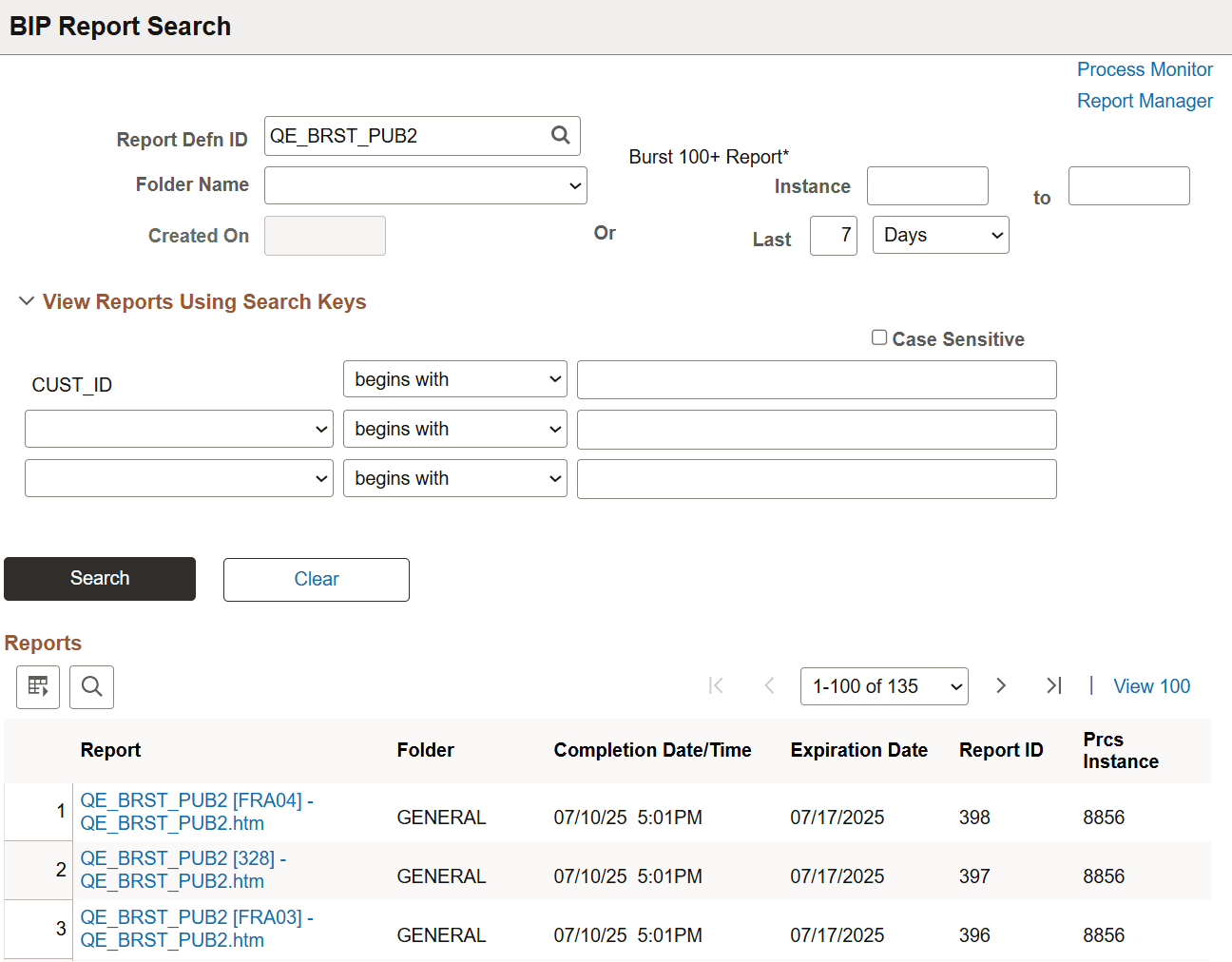

Access the BI Report Search page (Select .)
This example illustrates the fields and controls on the BIP Report Search page. You can find definitions for the fields and controls later on this page.
Enter criteria to filter the reports to list. BI Publisher Report Search ignores criteria for fields that are blank.

Viewing Reports Using Additional Search Keys
Additional search keys are available based on the Report Definition ID.
Users can also search by the following criteria for bursted reports:
A specific value in the Burst By field.
This is a read-only field that appears automatically when a value is set in the Burst by field of the page.
Up to two additional values in the predefined bursting Search Key fields.
These drop-down list boxes display the values set in the Search Keys region of the page.
To view bursted reports using the additional search keys:
Select the Case Sensitive check box to perform a case-sensitive search.
For the Burst By field, select a search operator.
Enter a value to search on.
For the additional Search Key fields, select the search field name, search operator and search value.
